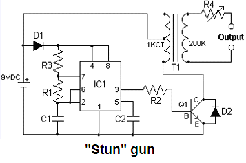

Ok, looking at the datasheet for the mouser transformer (attached)
The primary has 75-ohm resistance, so therefore the current required is (volts/75 ohm) 0.12Amps or 120 mA. Which a 9 V battery can provide for a short amount of time.
Therefore 120 mA is the load current if you like, therefore you need 0.0012Amps on the base if you assume Hfe is 100.
Am i getting there?

Your transformer is connected backwards. The transistor must drive the low impedance winding (8 ohm AC impedance when loaded) then if the current is high enough the transformer will step-up the voltage. The impedance is much higher than 8 ohms because the transformer is not loaded. The resistance is used for DC calculations of current but here there is AC.
A transistor switches well if its base current is 1/10th of its collector current. Hfe is used to calculate the base current for a linear amplifier, not a switch.
This circuit uses a PNP output transistor. Before you said your TIP31 NPN transistor didn't work. They are completely different transistors in completely different circuits.

Sorry, the tip31 transistor is used in the "stun gun" design which has the 555 timer, which i was referring to on the 30th march.

Well, I finished this project a couple of days ago, but it is not a very painful shock. Almost like a bee sting. I could not get this to work without grounding the third pin on the transformer though. Any suggestions?:)

The 5th wire from the transformer is not supposed to be connected to anything, it certainly should not be connected to ground.

Well, I hooked this up again on a trainer and it worked great-so now I am going to try soldering a new one altogether-and hopefully I won't get any wires misplaced!

Why so many questions?
0 & 1, the inductance and the nature of the transformer's core will deturmine the optimum frequency and duty cycle.
2, what's a trafo? Ah I see you mean a transformer, that took me a couple of miniutes to figure out. Please avoid using abbreviations like that, they make your post harder to understand.
10, this generates voltages far higher than 400V a 400V capacitor would explode.
14, connecting them in series will work up to the point where the insulation between the primary and secondary breaks down.
21, I doubt this will work from 1.2V, use a disposable camera flash unit for low voltages.
