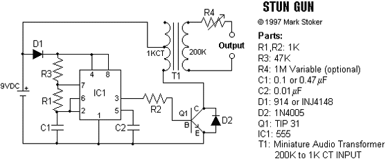

I was looking at the "stun gun" design and came across this website.
This person is using 1200:8 ohm transformer. Does this mean that in order to get the transformer "working" you need 1.125 amps on the primary (9 volts/8 ohms).
1) Can a 9 volt supply 1.125 amps?
2) Power= VI, 9*1.125= 10 watts
Using (Z1/Z2)^(1/2)=N1/N2=I2/I1
(8/1200)^(1/2)=0.0816
I2=0.0816*1.125=0.091 amps
Therefore on the secondary you get 0.091 amps.
darshelectro said:
This person is using 1200:8 ohm transformer. Does this mean that in order to get the transformer "working" you need 1.125 amps on the primary (9 volts/8 ohms)?
Only if the 9V supply is regulated and only if the transformer has a 1200 ohms load. It has a high load resistance so the 8 ohms winding has a low current and the output also has a low current.
1) Can a 9 volt battery supply 1.125 amps?
Only for a moment but the voltage will be much less than 9V.
trying to understand
rather then just building it, I’m trying to understand how people have calculated the values for various components for the stun gun picture attached.
Looking at this person website for some help (and also using my brain):
http://www.kpsec.freeuk.com/trancirc.htm
To calculate the base resistance for the transistor (tip 31) you need voltage and current:
First, using basic ohms law.
- The difference between the emitter and base should be about 0.6 V
i know the output voltage from the 555 timer is about 1.7 v less then Vcc. so if you have 9 volt supply then 7.3 Volt would on pin 3.
so therefore the voltage difference across the base resistance would be 7.3-0.6 = 6.7 Volts. ok
Now for the current.
(Using the above website and the attached datasheet for tip31)
The load current is 9 volts/8 ohms =1.125 amps
Using the datasheet attached, looking at the graph of Ic vs Hfe, 1000 mA, hfe is about 100.
Therefore Ib current is about 1.125/100=0.01125 amps.
Therefore the resistance would be about 6.7/0.01125=600 ohms
if you use the method as described by the website, you would get about 130 ohms.
i can see 600ohms is close to 1000ohms, but if you used 1000 ohms, would you not get about 0.67 amps passing through the transformer. Or is my understanding flawed.
At the moment I am having difficulty trying to get this circuit to work. I can get the 555 timer to work, but when it comes to getting a voltage across the transformer I get nothing.
I can get current flowing through the base of the transistor, but it is a lot lower then I have calculated even with a fresh battery.
Can someone correct me if I’m wrong about the above.

It depends on the size of your 9V battery, one of those large 9V batteries (the kind used in transistor radios) will, a small 9V battery (the kind used in a smoke alarm) won't. The maximum current available will depend on the impedance of your battery, the kind of 9V battery here probab;y has an impedance of about 30:eek:hm: and therefore won't supply more than 300mA even when short circuited.
Hfe is used to design a linear amplifier, not a switch. If the collector current is 1.125A and the base current is only 1125mA/100= 11.25mA then it would not saturate. Its collector voltage would be about 4V for most of them.
The datasheet spec's a low saturation voltage of 1.2V max if its collector current is 3A and its base current is 375mA. The graph of typical saturation voltages has the base current at 1/10th of the collector current.
Look at the picture of the TIP31's pins on its datasheet. Maybe you have them connected backwards.
The base current is in fast pulses. You need an oscilloscope to measure them.
will it work
well, if over 300mA is needed on the base of the transistor, and if i remember correctly the 555 timer can only deliver a max of 200mA. How can this circuit work?:confused:
