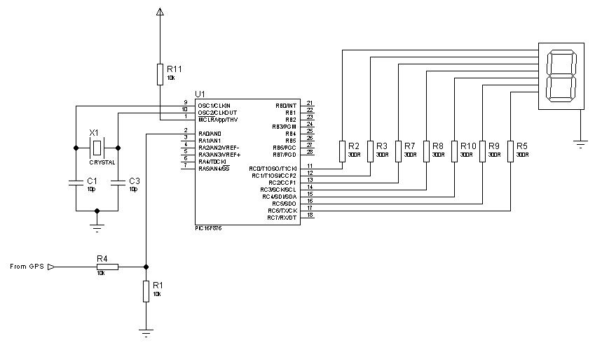

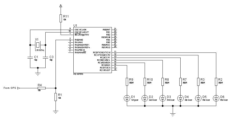

hi guys i'm triyng to find a schematic for gear indicator for my gixxer that take signal from speed and rpm signl (plus neutral light for zero) but it seems that it doesn't exist anywhere... do you have any idea?
If you want only gear indication you can take signal from the GPS (Gear Position Switch) and use a 7 segment display or may be one led for each gear, which is in my opnion the easiest way. You can use a pic 16F876 as well as the code that Gramo has posted earlier with little modifications.
But if you prefer to use speed and rpm signals you need to wait some guy to post the little math to do that, but I'm not sure if this way is a reliable way to show the gear you are in. So if you have an OEM gear switch (I think all Suzuki have it) why not use it.
Attached there are two simple circuits that can be used to show the gear position using signal from GPS (gear position switch).
For all of the circuits presented here, it would make sense to replace the 16F876 with a 16F88. This is a much smaller chip (18 pin) but has all the required peripherals plus it has an internal 8MHz clock.
It probably won't be able to handle the graphical display. BTW, if you find a good site explaining interfacing and programming the graphical displays, can you post it here. Thanks.

Here is the code you asked for a 7 segment display schematic I posted earlier. Note that this is a modified program posted by Gramo.

low seg2
high seg3
high seg4
low seg5
high seg6
high seg7
Case 4.191 to 4.470 '6th gear
high seg1
low seg2
high seg3
high seg4
high seg5
high seg6
high seg7
Case 4.471 to 5.500 'Normal
high seg1
high seg2
high seg3
high seg4
high seg5
high seg6
low seg7
Case Else 'ERROR (NO VOLTAGE)
high seg1
low seg2
low seg3
high seg4
high seg5
high seg6
high seg7
EndSelect
GoTo Start
I don't know why it was not indented...
i saw that n the code you already put voltage in the program.. in this case i don't have to chet it again?
Sorry, let me see if I understood. The voltages I put in the program are for my bike and I don't know if the voltages of your bike are the same, so I think it's better you measure the voltages from the GPS before you program your PIC, just to make sure or tell me what is the model of your bike and I can make a research.
sorry but i was typing on a broken keyboard :p
yes it's correct i have a gsx-r 600 k4 (2004) in case what should i have to use for the measurement?
You will need a voltmeter and them you have to tap the signal from the GPS then run your bike on a jack and measure the voltage for each gear.
