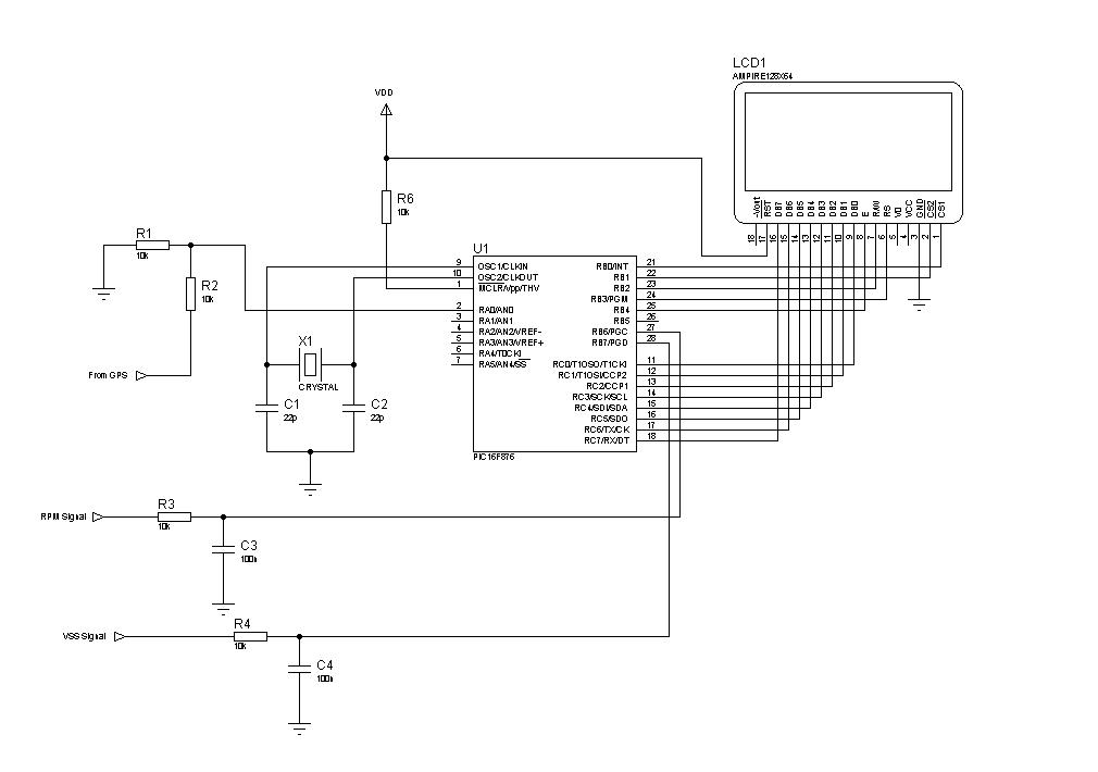

Speedometer
Sorry, I think I got it. its in KILOMETERS, I was doing it for METERS
Should it be calculated for DIAMETER or CIRCUMFERENCE of the wheel??
In your case.
22in wheel diameter = 69.1152in circunference (2*PI*R)
69.1152in = 0.001755526Km
0.001755526Km * 3600 = 6,3198936
Temp_Float=(Temp_Float*4)*6,3198936
In the example above the number 4 multiple by counter period (250 or 1/4 of seconds)
You have to multiple by 3600 because you have Km/sec and you want Km/h
Kiko said:
In your case.
OK, thanks!! Im not very good at this conversion stuff.
What I want to do is be able to select a wheel diameter from a menu (storing everything in variables) and do all the conversion on-the-fly.
I have this as of now does it look correct to you, (wheel diameter of 25 for example)
WheelDiam = 25
        WheelCirc = 2 * 3.14 * WheelDiam / 2
        Wheelkilo = WheelCirc * 2.54e-5
        WheelConv = WheelKilo * 3600
Here is my complete program. it will display a bargraph representing speed as well as the numeric representation. It also displays the time from a DS1302 RTC. It all works perfectly in Proteus, I just need to make sure I have the conversion stuff correct so it is accurate.

Allrigh
For those of you who wants to play with GLCD and do a speedometer, this is my code with schematic for my Suzuki Bike. I'm having problem to find a good GLCD down here in Brazil, I bought one but it needs a negative power supply for the contrast.
I'll be glad to see your SF codes Gramo. Thank you

Hey Kiko, I tried your code and schematic in ISIS and I cannot get it to display properly!! The splash screen doesnt not show, and when it starts to show the actually working screen it is just a jumble in the lower right corner!!!
What are your LCD settings in ISIS?
Set LCD clock frequency to 20mhz.
Rgds
