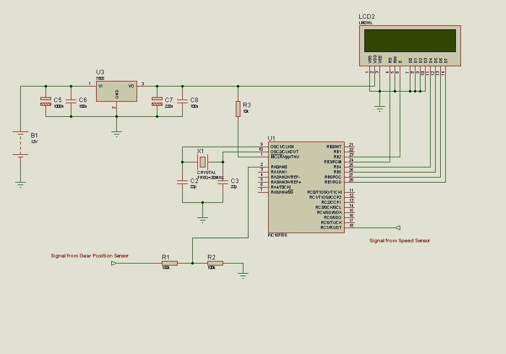

All finished, heres the code;

You can modify the Symbols Containing the Min and Max voltage values that are allowed for each gear.
The program can probably be tweaked - eg I left the volt display on there for debugging and you can remove it once you feel happy you know all of the volages are correct.
Watch the circuit in action here
The SIM appears laggy as there are 7 Signal gererators in use. It will be much faster in real time.
You might be asking why on earth I used a voltage divider in the circuit - its because in Neutral, the were voltages over 5V, and PIC's don’t like that!
So to keep everything to operating standards, the voltage divider is just halving the sample voltage; eg, 5.5V from the gear selector output will now be sampled as 2.25V by the PIC. The program scales it back up mathematically :)

OK I understand and I have it in my circuit, thank you.
Does the gear voltage vary with engine RPM. If so, the voltage may be relative to the battery voltage and you may be able to fix it by setting the ADC reference voltage to a division of the battery voltage.
BTW, have you changed to a schmitt trigger input and if you have, did it work?
Unfortunately not and I have changed de input port to RC7 and still the same. I think I have some kind of noise that come from the generator because when the engine is not runnig or the circuit is on the bench it works ok. I didn't have time to try the gramo routine yet and to troubleshoot the generator.
I will post the news later just for information. Thank you very much.
FYI attached is the circuit I'm using.
I increased the value of C5 and C7 to try to filter any noise (didn't work).
I've placed a 10k resistor (pull-down) on PORTC7 then I removed because it killed the signal to the original bike's speedometer.

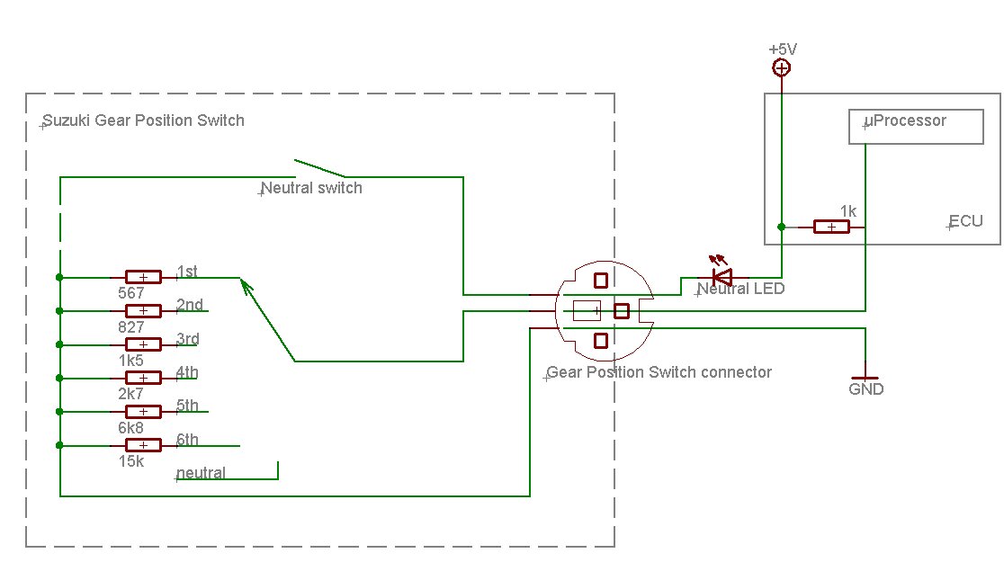

I think your problem is in the ground - what ground did you use when you measured the voltages? I think you should use the black/white wire on the gear position switch connector, not just any ground on the bike.
Attached is a picture of how I think the Suzuki gear position switch is wired.
D.

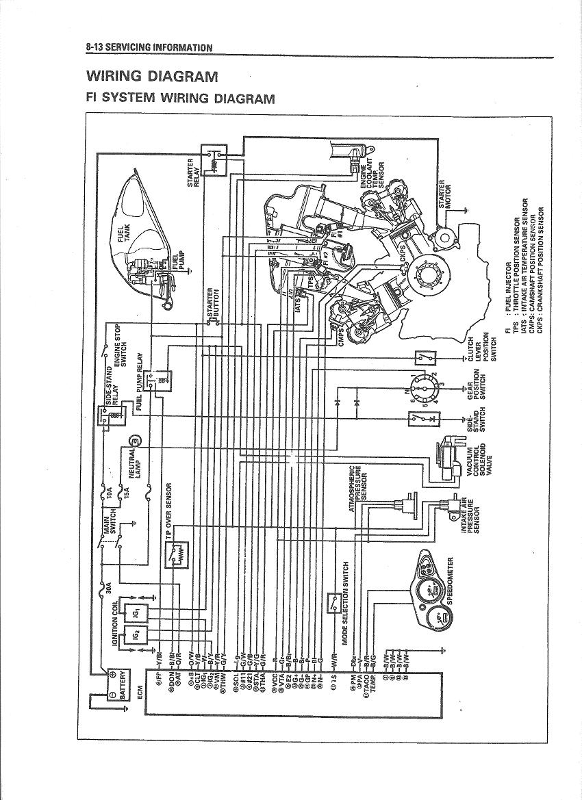

D.
I'm taking the ground from somewhere in the instrument cluster.
I'll try to change the ground...
See attached the bike's diagram
Thank you
Thank you
Looks similar to my bike's diagram. Does your bike have three wires to GPS (gear position switch)?
The voltages from the gear position switch should be 'stable' and pretty much spot on as the ECU is using those to choose different ignition and/or fuel maps for first three gears (to prevent 'accidental' wheelies, I guess) and to enforce a speed limit in the top gear (on the GSXR-1000 and Hayabusa).
D.
D.
Yes sir, it has 3 wires and I took the signal from "P" wire near the ECU connector as you can see on the diagram. And as I post before I'm almost sure I have a GPS or generator or regulator problem, first because the voltages overlaps and second because on the bench the circuit works very nice and the only thing I can see strange on this bike is that it drinks a lot of fuel and it's fast, so it may be a indicative of GPS problem and because of that the ECU chose a higher gear (5th) to deal with. I don't know...
I don't think the Suzuki TL1000 has a speed limit but I'm sure it has a RPM limit above 10500 RPM with load.
Thank you

Just for information, I changed the ground of the circuit that I took from somewhere of the instrument cluster and now the circuit is very stable, so the problem was GROUND. The Gear indicator is working perfect... But not the speedometer that when I turn the ignition ON it shows me 10 Km/hr and in 30Km/h shows 60Km/hr and so on, with more speed the difference between analog and digital increase.
I had to change the resistors of the voltage divider from 1k to 10k because with 1K the voltage on the lcd indicator drop about 1.5 Volts.
