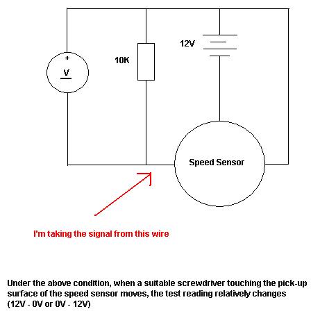

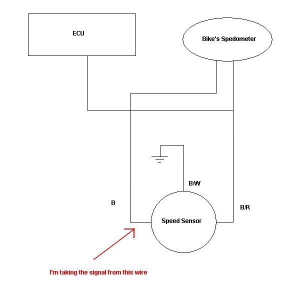

OK so let me try to explain what the problem is now:
I'm not having anymore problems with the gear indicator so when I changed the ground the problem has been fixed. The gear indicator is working perfect.
When I power the circuit installed in the bike the speed indicator is zero as the bike is stoped (no speed).
When I start the engine the speed indicator shows 10km/hr but it's not smooth and with the increase of the speed it shows incorrect readings like I posted before.
The speed sensor this bike uses is attached as reference, please see if I took the signal from the correct wire.

Am I right in thinking that the ADC part is working correctly and the problem is with the pulsed speed input?
Assuming I'm correct on the above assumption, it sounds like you are getting noise interference. Try connecting a 1K resistor from the sensor to the pic and a 0.1uF capacitor from pic to ground. If you still get noise then increase the capacitor , if you get no reading then reduce it. If it only works at certain speeds then post back.
