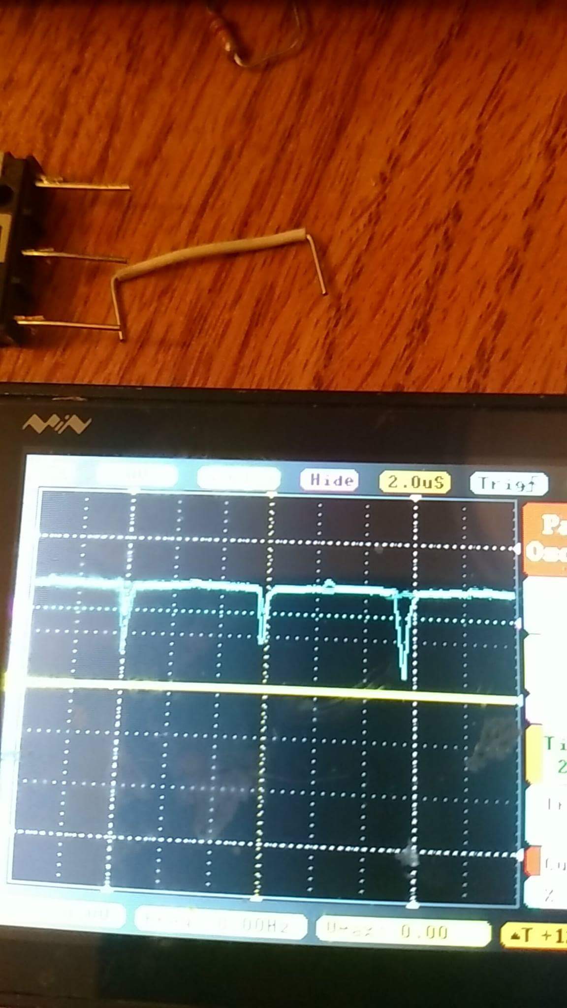

Okay this is interesting. I took another look at the CT after replacing my mosfets. I decided to look at the signal out of the inverter that the CT is making. I had it running off my antenna, sent my CT output through two inverters and scoped that second inverters output, open(to scope only), as well as my antennas output from the inverter. My CT signal was almost at 98% duty on time (Pic below). For some reason it wants me to have my DC blocking cap prior to my D10-D11 diodes. (Lonescience has the cap after). Once I placed the cap prior to the diodes I got a square wave that was identical antenna inverter output, it just was about 1Us faster. So this showed me I am getting somewhere.(Pic bellow "CT_InvOutOpen_Antenna_InvOut.jpeg." CT inverter output is blue, antenna is yellow.)
Now I tried flipping phase anyway possible. Reverse secondary ground direction through toroid, one inverter not two, then swapped pin 1 with pin 2 on the CT. Still nothing, what the hell. I then tried the circuit bellow and it worked.
Although this runs like this, with CT straight to gate driver, this is not something to do on any higher power supply. (pic below CT_Out). This shows a sine wave with the top and bottom cut off(clamped by diodes) so it is slightly a square wave but the rise and fall are slow."curved". This signal is not being cleaned up by the Schmitt making it dangerous to use at high currents. So any thoughts on this? Why I cant get this signal out of either type of inverter to work when connected to the driver? This doesnt make since to me, so I'll try moving it on my breadboard, maybe a portion of the board is screwed. The inverters will clean it, as well as output the CT sig but only connected to the scope. If I connect the CT inverter output to the gate driver it just goes flat. If I place my scope on scan I can see it try when I first power up the driver, like a couple pulses then flat.

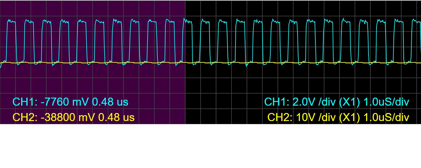

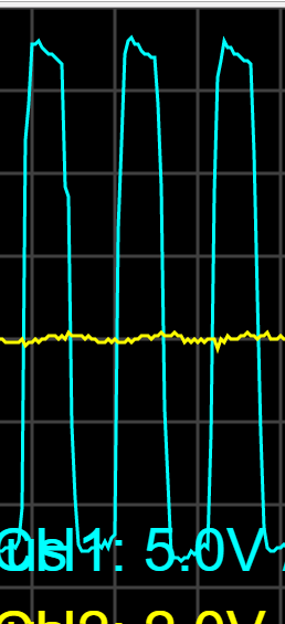

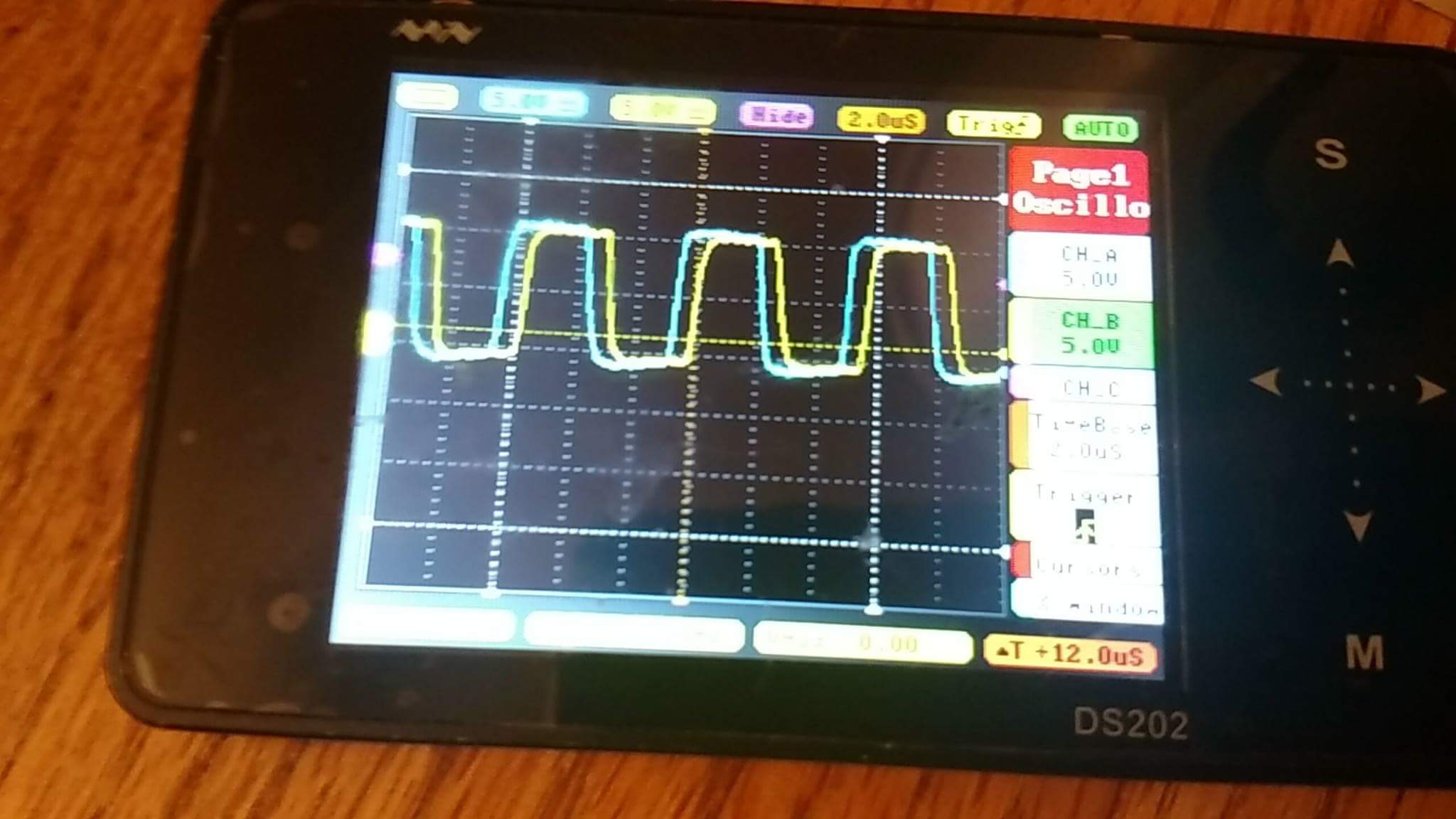

A side note here, You say my scope sucks but from what I see the 74HC14 is faster but the CD40106 outputs a 30% cleaner signal from what I see...Is this chip fried? I have another to try..pictures are labeled below.
Your scope does "suck" and you're still not seeing the entire picture because of its low bandwidth. It's incapable of capturing the high-speed events that are very important to see when playing with Tesla coils.

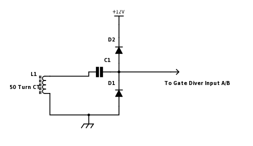

I'm wondering if the junction capacitance of the clamping diodes is coming into play (I'd have to do some more digging into datasheets). If the lower one was acting as a capacitor it would shunt the output from the CT to ground, thus giving you a flat line into your logic. I have never seen this happen, and I wouldn't expect the junction capacitance to be a problem until you get into extremely high frequencies, but I can't say for sure. Then again, if this was the problem then I wouldn't think placing the DC-blocking capacitor before them rather than after would make much of a difference.... I'll take a look at the datasheets when I get home from work if I think of it.
Okay sweet thanks, I am still on the 1n,4148's. I tried a bunch of those 5819's and they wouldn't work. Looks like the other 74hc14 is working better, still won't work with the CT and driver. The ct output looks great through the inverter by itself. Very confusing that I get a inverter output but not once that output is connected to the driver..

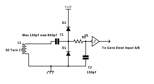

So I finally solved my CT issue Ugh!!!!!!!Yay!!!!!!Okay maybe you can explain whats going on here, I have 3 schematics that I'll explain. Inverters are now 74hc14's, on 5v rail, with D2 - 5v. D1-D2 are 1n4148
#1
Okay so I started to notice that as I changed the DC blocking caps value, I could get it to slightly spark up, sometimes it would hold steady. If I came close to the top load with a ground probe it would spark and go out at a certain distance.

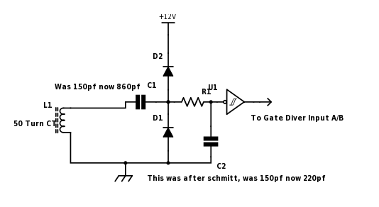

#2
Now this is when it actually worked, Great actually!! I have a momentary button on my driver supply at the moment. as fast as i click it works every time. As well I can come as close as I want to the top load with a ground probe. So this setup acts exactly like my antenna, slightly better actually, If I quickly touch the ground probe to the topload it would loose signal on antenna, Now its solid!!!

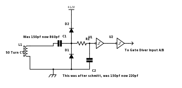

Okay, so in this one I had to reverse the direction of the secondary "ground" through the toroid to 180 my phase, This alowed me to add another inverter. Now this one does work although it will hesitate to start up sometime. I cant click my driver circuit on and off fast, after turning off I have to wait to turn back on. It also sometimes wont start right away.

Now is this okay to leave this going through one Schmitt? Two cleans a bit better right? Can you see whats going on here? If so and two is better then one, do you know how to make the two schmitts act like one?
The number of Schmitt triggers determines the phase of the output. If you only have one it inverts the signal from the CT (shifts it roughly 180 degrees out of phase). Adding a second trigger puts the output back in phase with the CT. If it works with one Schmitt trigger inverter, but you want to add a second one, then swap your CT leads and add the second inverter. This will put everything (roughly) back in phase. I say roughly because there are delays caused by C1, R1, C2, and your Schmitt trigger inverters that will also shift the signal slightly.
What you've done with C2 is created a low-pass filter with a critical frequency fc = 1/(2*pi*R*C). The critical frequency is the frequency at which the output amplitude is decreased by -3dB. Beyond that point, higher frequencies will cause the output amplitude to be attenuated drastically. Simply put, it will try to "block" frequencies beyond the fc. Assuming R1 is still 1k, with a 220pF capacitor your fc = 1/(2*pi*[1k]*[220pF]) = 723.4kHz. With this filter you may be blocking the harmonics that Guangyan mentioned in his notes on his schematic. However, you are still creating a phase shift, as mentioned earlier (the time constant of your RC is 220ns!). There is a good chance that you have added so much delay that it can no longer trigger at the correct time in order to sustain a high voltage arc. If your MOSFET switching waveform is out of phase with the actual current resonating in the secondary circuit, the waveforms will cancel each other out and you will lose your output. This is just a guess, but it would make sense. I suggest getting rid of as much delay as you can. Remove C1 and C2 and stick with one Schmitt trigger inverter (this should be sufficient to clean up the signal) and just make sure your CT leads are connected in the correct phase. Try this and let me know what happens.

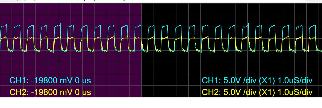

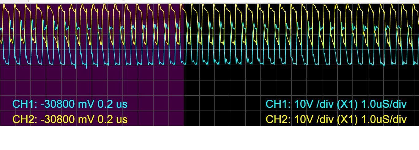

I scoped the antenna and my #3/#2 setup on CT they is in phase to each other. (antenna/CT) . this pic is labeled "Antenna-40106_CT-74hc14"
When first getting this to work I did not have C6. Now that C6 is in here it works very well with 2 inverters.

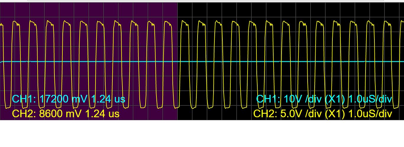

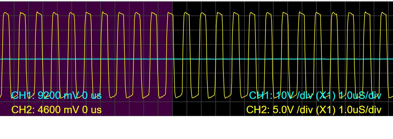

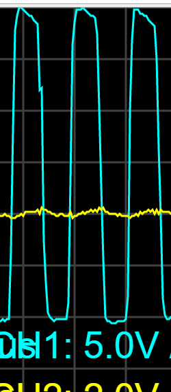

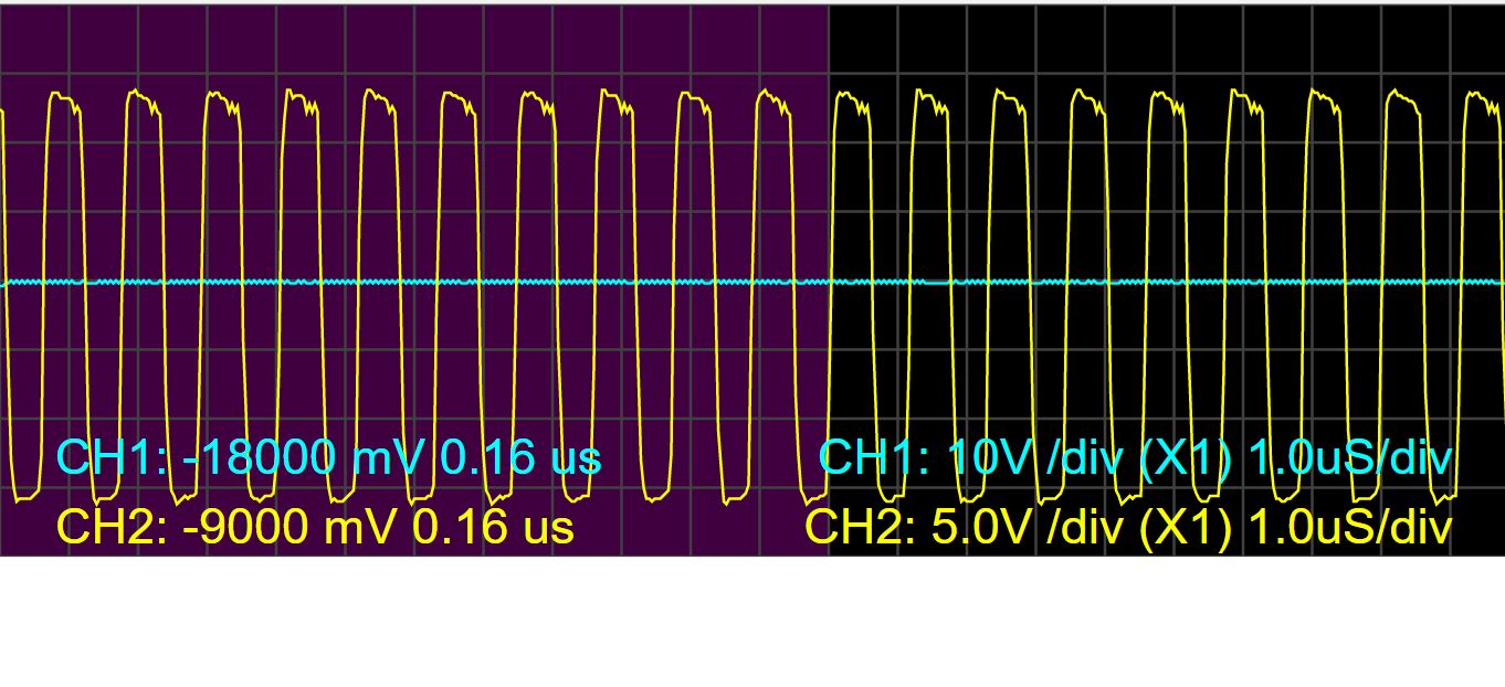

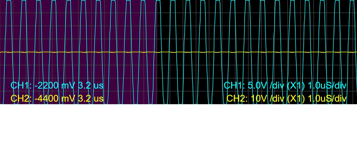

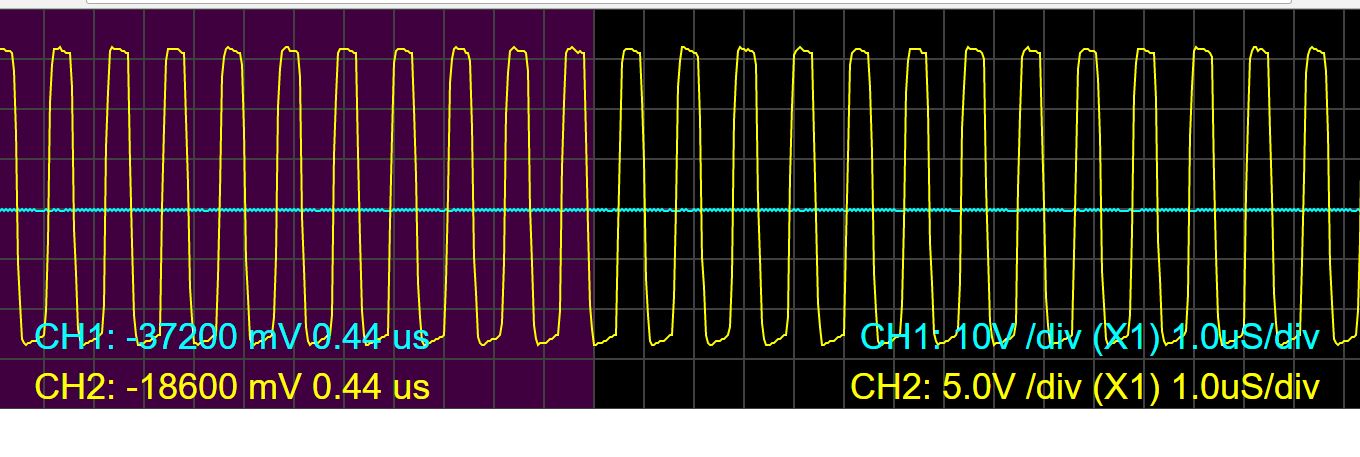

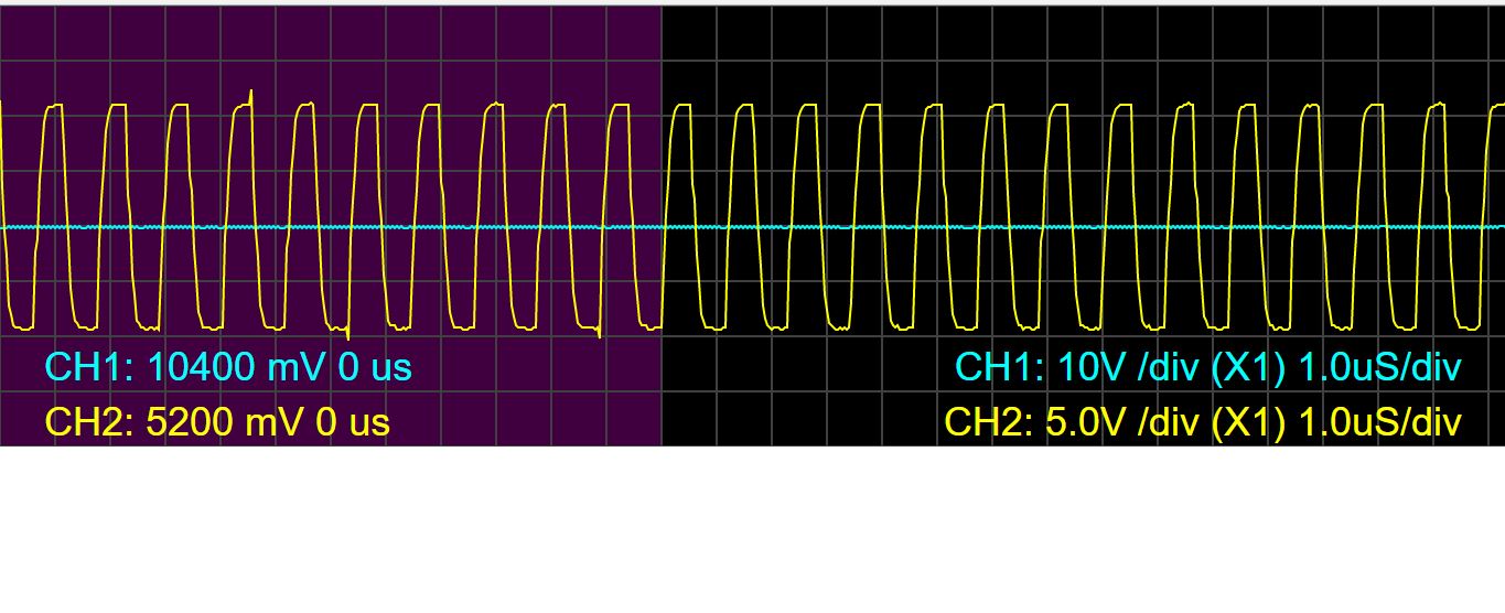

Okay here are scope view of right now. These are .SVG files, the open in any browser. Each file can be zoomed way in or out as well scroll quite ways off the screen(right). then you can hover over any part of picture with your mouse and it will display the voltage and time below. I have ordered these from start to finish. I will state connection as well as how it was tested (Signal - Scope connections)
  1. CT signals output - Dig Gnd / CT pin 1 (this one is a sine but cuts off at top, in file)
  2. Inverter out. Cleaned CT signal - Dig Gnd / U2 pin 8
  3. Gate driver out "GDT Primary" - Gnd OutB / Probe OutA
  4. Mosfet Gate T4 - bridge Gnd / T4 Gate
  5. Mosfet Gate T3 - bridge Gnd / T3 Gate
  6. Mosfet Gate T2 - T2 Source / T2 Gate
  7. Mosfet Gate T1 - T1 Source / T1 Gate
  8. Bridge Output - PriOUT1 / PriOUT2
All Pins and scope views correspond to the new updated schematic below.
