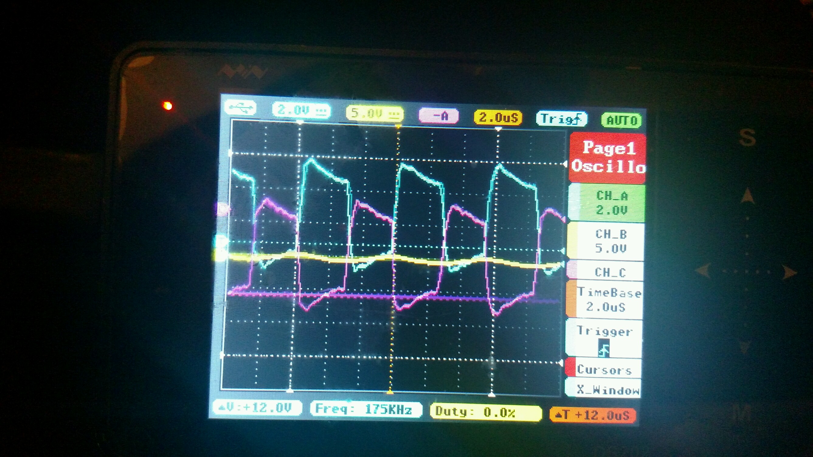

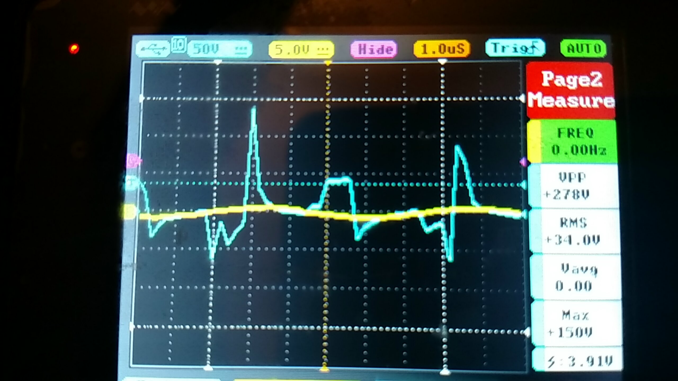

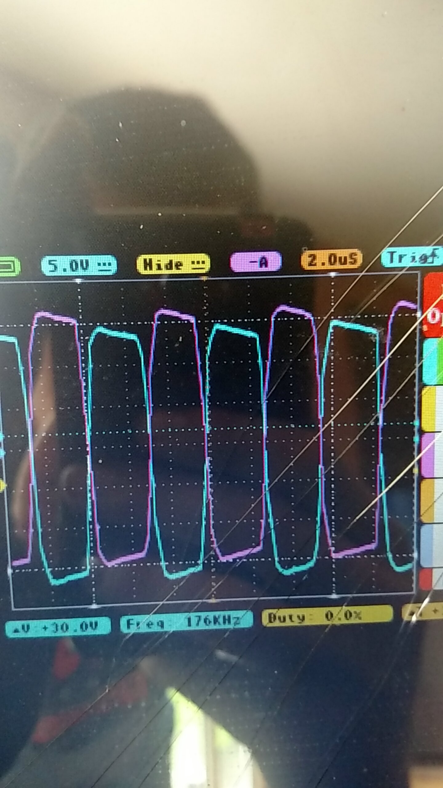

I think I found my issue. If you look at my Gate driver output, it is triangled slightly on the top and a bit better square on the bottom. This is making two fets turn on longer then the other two. Derstrom got me worried about R7 and C2 causing unnecessary charge delay. So today I was able to remove R7 and reduce C2 down to 68pf. Hopefully that helps that situation. This Gate output is the same between those two orientations. So this is where I'm stuck, I dont know how to square that more evenly, I figured the inverters would take care of that. The only thing I can think of playing with is the CT toroid since this is the signal I am getting from. I dont think the turn could will change how the inverse of the wave will look. So Im stumped here. I also tried adding another two inverters but signals the same.
The picture below is a image of a Low Side Fets GDT Gate signal. The purple is the inverse, you can see the tops of the purple are pointed compared to the blue.
I know this wil be the third time correcting this, My meter was about dead. I did only pop 2 fets on the last run. Same switch, opposite output rail. these two where ones with the pointed waveform(purple)

Hey so I'd figure I'd at least continue.. I'm getting closer for sure.
The only thing to me which may be wrong, is the trangled inverse of my gate waveform was in my opinion due to added stray capacitance from using a Breadboard(I read every connection can add 2-25pf, WOW). So I. Made a driver board as u can see below.

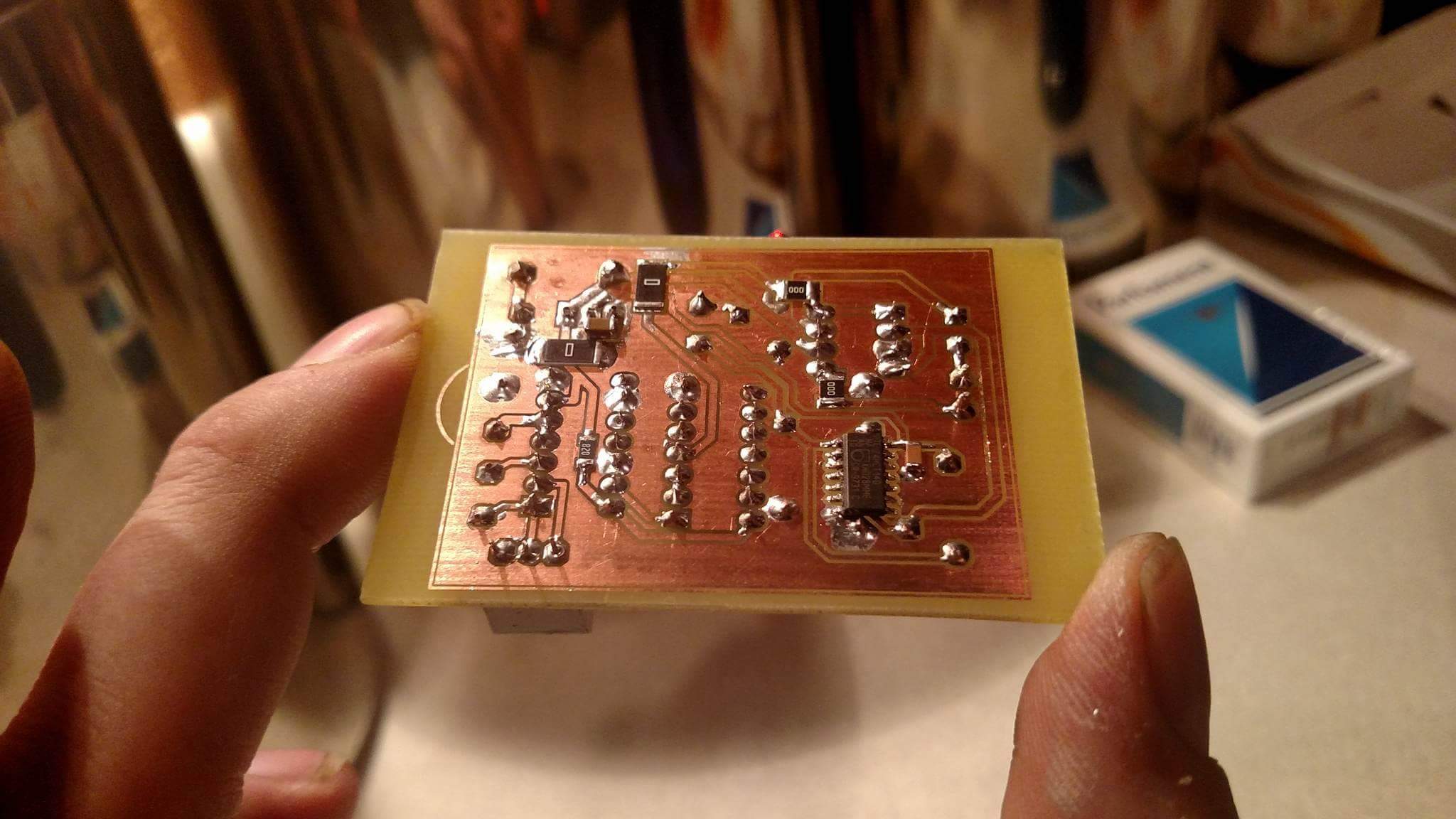

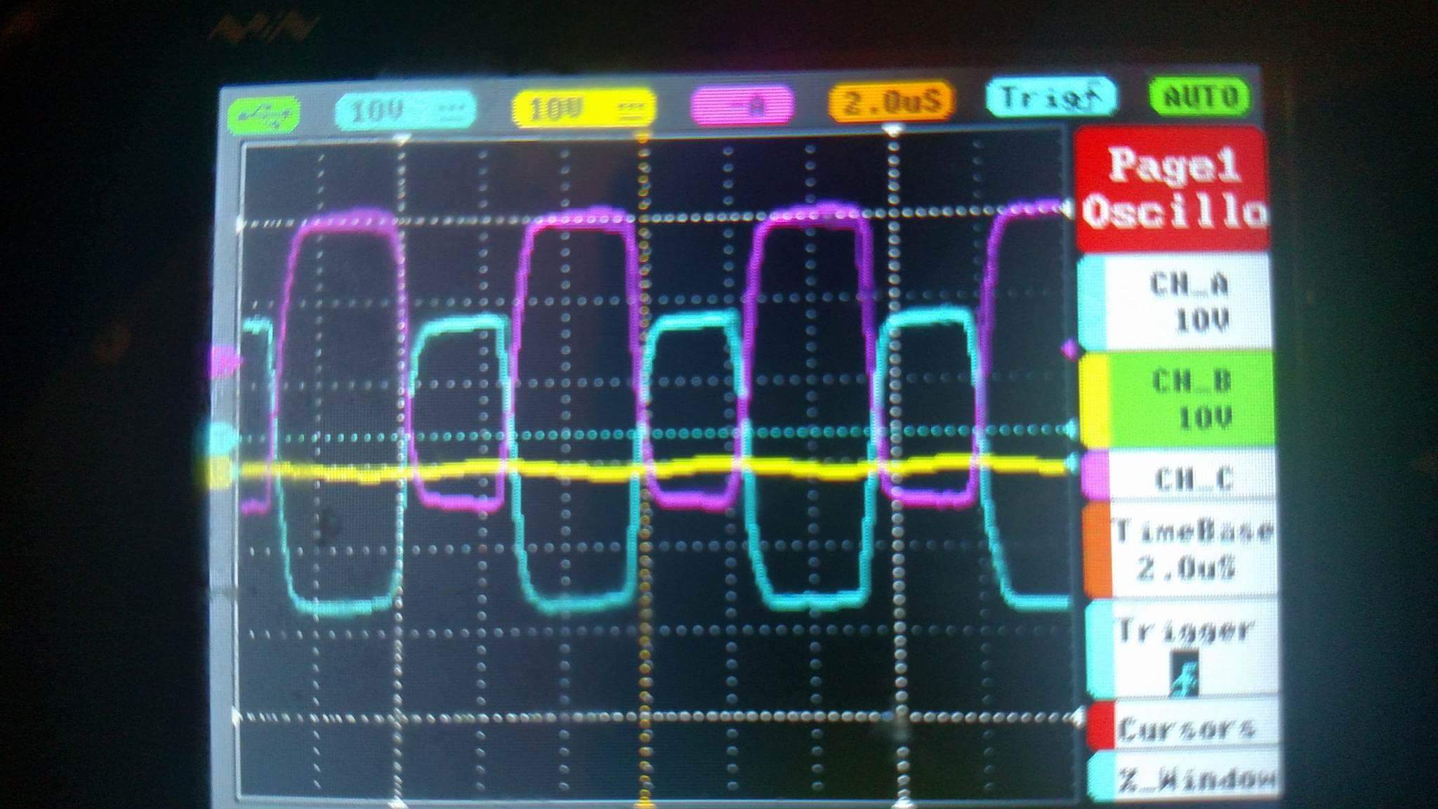

After changing this to printed board I then viewed the Waveforms, way more square, especially my CT inverter output(pic 21501). That was a gigantic difference. Ill probably play with those cap values a bit more since every waveform is way different. (you guys called the hell out of that)
I then probed my Mosfet gate waveform. I posted pictures below, the higher voltage looking one(1402.jpeg) is with a 1 if cap(DC blocker), the shorter version(4727) is with an unknown value cap, I'll check tomorrow but its one of the brown polyester film types 250v(Not in picture below). So to me that one looked the best to me. These waveforms looked a ton better then on the bread board.
The one issue in the Waveforms that I can see is the duty cycle not even. My scope is reading 55% duty. This goes all the way back to CT/ or antenna. Is this normal? If this is not okay, how do you change the duty cycle if its generated from my feedback signal(CT turns maybe)? This will cause one side of my bridge (2 fets) to be on for a shorter period then other two. Not sure if this is bad, or how to change that.
I am also not sure on the best Waveform for your gdt. I did find a cap value that looks fairly square but with a slight overshoot on the rising edge. So tomorrow I will also post some scope pics of a few blocking cap variations.
Wow, who told you that? When did it finally sink in? Couldn't have been anyone here, since you kept resisting our telling you that. :)
Hahaha hey hey that was the first things I did. Lol yes it took me two weeks for both, and one more try after one was made. But yes thank you as well, I know you where involved in that. And yes I do understand I was straying from that but I just didn't understand how much a small capacitance can affect a high frequency waveform.
So I'm sure I'm right there tho. I did find through more research that my duty cycle being off is due to my CT blocking cap. I did try a bunch of combinations and what I has was the best. 55/45 was the best I can do. I tried adding another DC blocking cap on the ground end of the CT for sh*ts and gigs and it made my duty stray further apart. So I'm hoping 45/55 is doable for a SSTC with IGBT's.

I think the scribble is the tesla ring, or noise. when making my own pulsed input unloaded these looked just like the gate input.

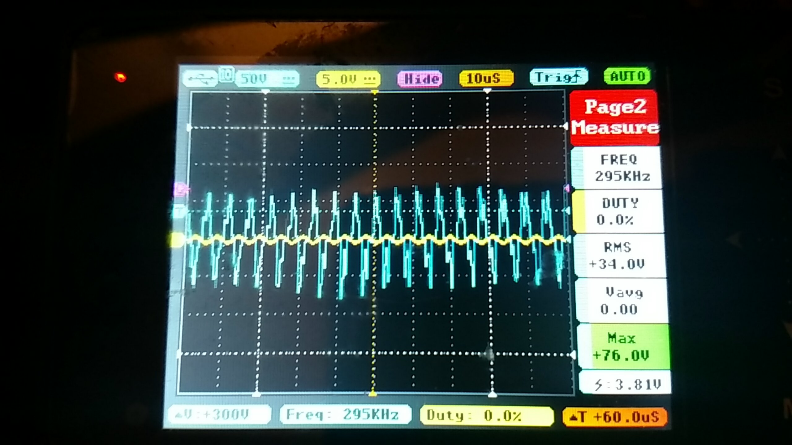

I can see voltage spikes, these rise to 64V on my low power supply. This makes me think on high voltage I'm shooting voltage transients into these Fets that exceed the rating. This make my completely understand your comment on how they can pop without heat. I thought with Zeners and shoot through diodes I was covered. This was written in a way to make me understand, as well, what a couple other people where talking about in previously read papers. From what I understand from his write-up, a Snubber Cap would seem to benefit me. I cant find a specific paper online about snubbers on tesla coils. As well he doesnt have a schematic showing what he means. So Im not sure where or how to do this on a tesla specifically. I see separate circuits with a resistor and cap in series calling it a snubber, Im sure this would differ on a TC an am not sure how to apply it.

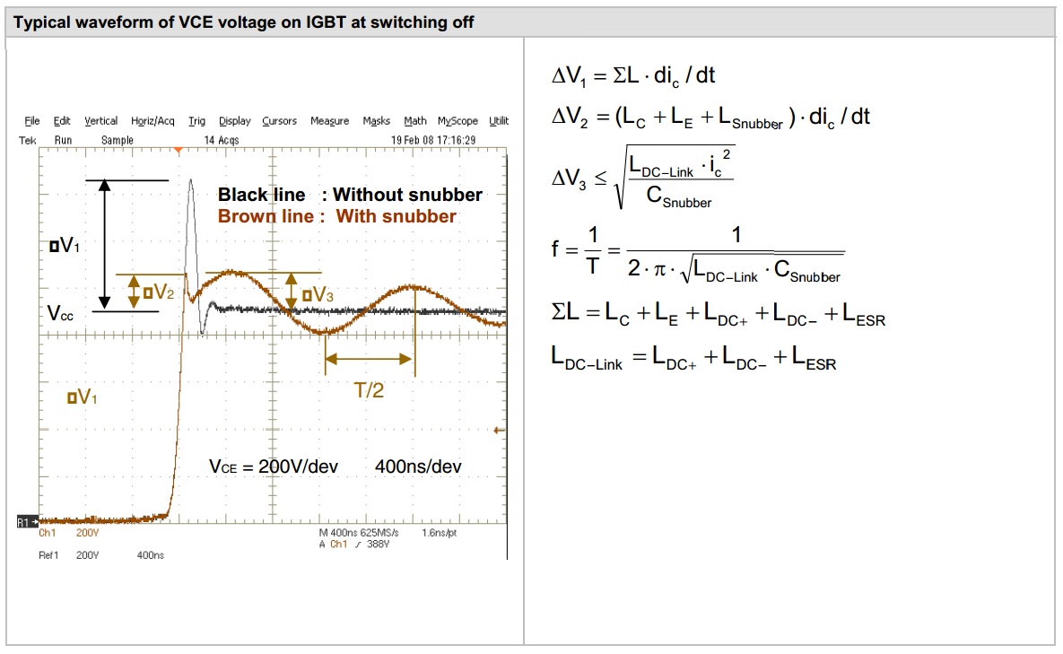

I also attached his image of how snubbers help.

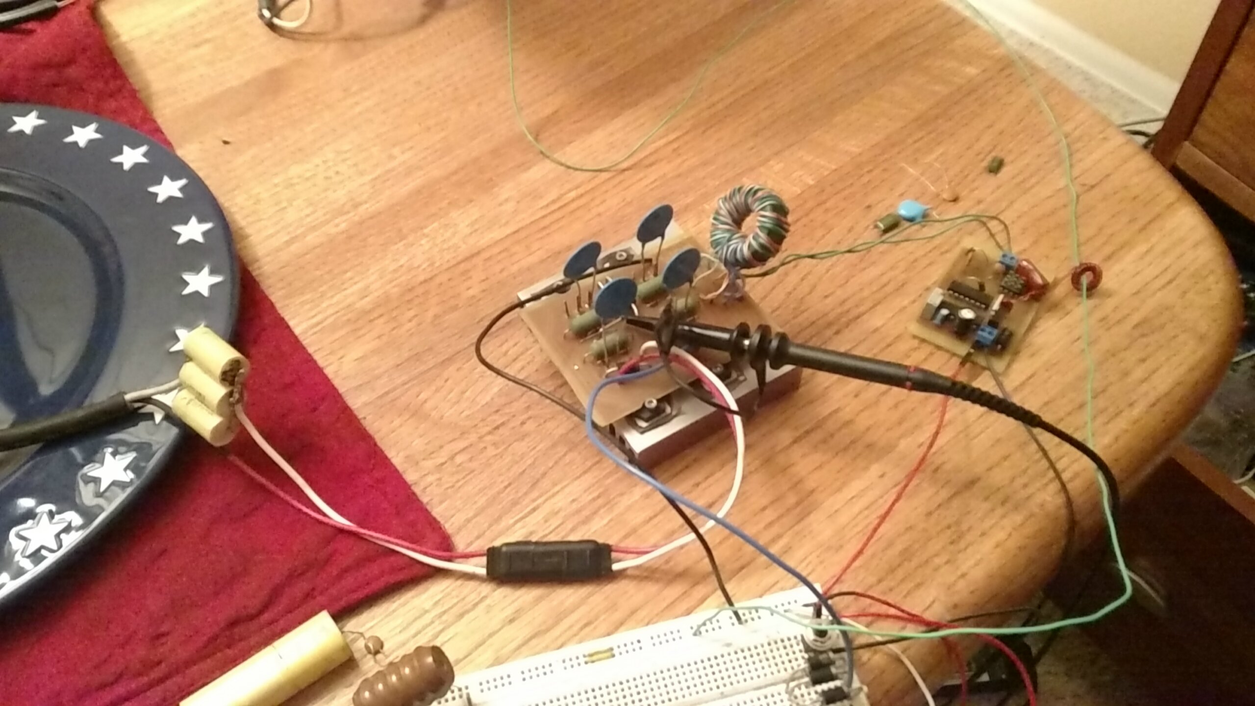

These are updated videos on the TC running with both PCB boards. It seems to run fantastic!!!! In these videos I did alter capacitance and primary for best arcs and highest currnt on my low voltage power supply. One video is in CW mode, the other is modulated. CW can run for 10mins and Fets are cool, caps and power wires get very HOT!!! LOL (Need to up wire gauge)
Primary - Helical 3 turns, 14 AWG, 4", 0.375" spacing
CAP - 3 parallel 10/10 600v caps, 310nf measured ( I think film, there in video, I'm not sure, there old)
POWER - 2 20v Laptop supplies, Pulls 4.2amp @ 20v
CW MODE
Modulated
With a little more reading on snubbers, This may be a bad idea, I read they can introduce more problems then they fix.
I did figure with the change to pcb the bridge inductance would be at the minimum. Do the wires leading to my primary from the bridge count? I see this grayed out in a lot of examples but it seems to me a long wire could make this increase voltage transients.
So I did see a couple designs with people using MOV's or TVS diodes in parallel with the freewheeling diodes. This to me sounds reasonable, Although the value to use is something I wouldn't know. My best guess on value for TVs diodes would be around 200v. I get a bit of buffer room both ways, 175v rail and fets are max 250v. Then there are the MOV's, I would guess the same voltage clamp rating(200-240) but they also have a capacitance value. This makes me think using MOV's could implicate the same issues involved with a snubber cap.
So with the wide variety of voltage suppression techniques people use I'm not sure whats the best.
Alright, So, I fished through my parts today, I had 4 20D151k MOV's. Cool! These are 70v clamp, not the ideal ones, although I can test these on my low power 20v supply since I was seeing spikes around 120-150v. As well, to ensure I minimize all of my inductance in my circuit I beefed up my Supply wires feeding my primary by 3 gauges and shorten them by half. Then soldered my capacitor in line instead of pinning to a PCB board for that capacitor. I also increased my Supply power wires.
You can see in these two scope views they are camping right around 70v. Cool no more spikes, however this is drastically killing my performance. My arcs off of my Breaking Point went from 2 to 3 cm long and about 2cm wide to then 1.5 cm long and just a straight single arc.
But then I see this if I come close with a piece of metal. A little side note here, all I had around me was some 600 volt capacitors so I bent a leg out and came close to my top load. Surprisingly I got a 9 cm thick white hot arc.WOW!! Wtf.(if I counted the bent rise of the arc it was 15cm).. I then actually got my screwdriver, came close to it, got half that length. For some reason that capacitor really like to Arc off one of its legs. Hmmmm. Anyway you can see in this photo, when I come close and arc off the top load, I don't quite get a voltage clamp as I do arcing to air. ou In this picture my max voltage jumped to 150 volts. This was about where I was arcing to air prior to MOV's.
So overall I see it has taken effect and has helped arcing to air, although I do have decreased performance as well. This doesn't seem quite logical. This also may be the value of the mov? All I can do is expect the same on my higher voltage Supply. If I ever want to come close with a chicken stick I'll probably pop my mosfets.
So I guess the next step would be to try TVs diodes although I may see a similar outcome.

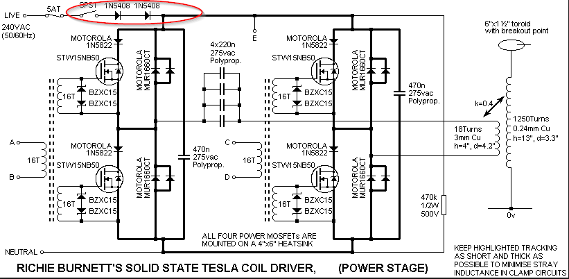

Alright!!!! So today I tried to tackle inductance, As I re-read every SSTC or DRSSTC paper out there, I see transient spike = to much inductance somewhere. I've been going off this schematic I found online showing dark black lines on your H-Bridge that need to be kept as short and as fat as possible.
I have had very long feed wires supplying my primary since they where not highlighted on this picture as well as a few others.
Even though I did just beef those wires up, I decided to shorten them a lot today. It was about 3ft now its 6". I was trying to get as much distance between the coil and the circuit as possible. Since I saw this wasn't a problem I never looked here. After shortening them up today, WOW, I was having awesome arcs with a 310nf cap prior, Now the 4.7uf works like that did!!! Sweet!!! So I think I found a big culprit, Im at 6" of 16 gauge and my transient spikes went from 150v to 63v. So I think for my final product, as well as future testing I'll use some 8 gauge sub wire. Super flexible, Same stuff I used on my SGTC. I will also try and keep length under 8".
So Im sure this my be wrong but a 20v supply with 63v transient spikes is 3X the rail. So If I want to eventually be on mains 175V, 175 * 3 = 525v transient spikes. Now Im basing this off a plan that uses 600v IGBT's, This is under there max voltage, So my understanding is that this may work. Do I have an issue that still needs to be addressed, YES. I will absolutely not call it a day quite yet, I'd like to minimize as much of these swings as I can. The next step would be to fish through some more for any high inductive areas. I have ordered some 250v and 300v TVs diodes, as well as some 250v .5uf caps to try and reduce these swings.

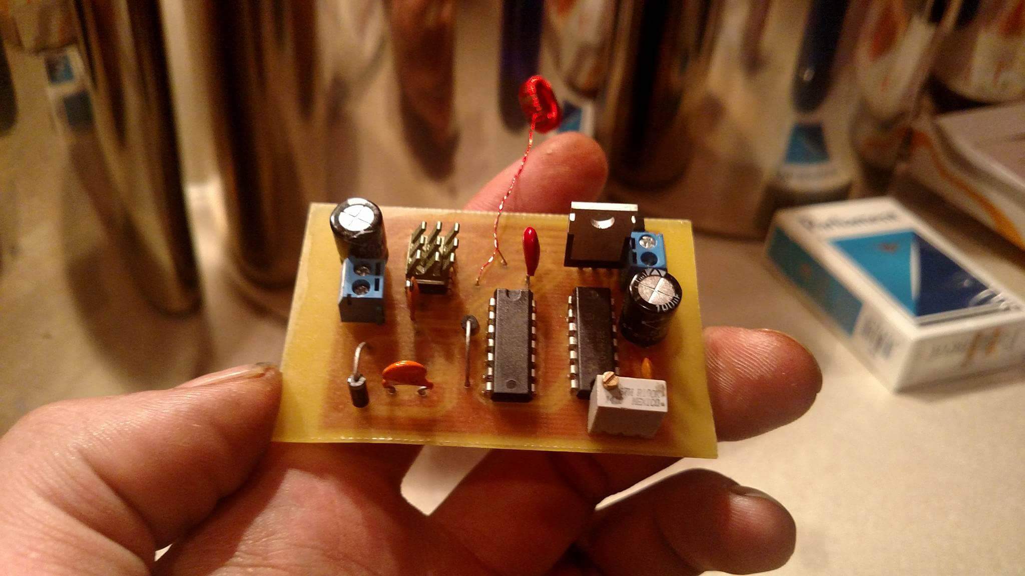

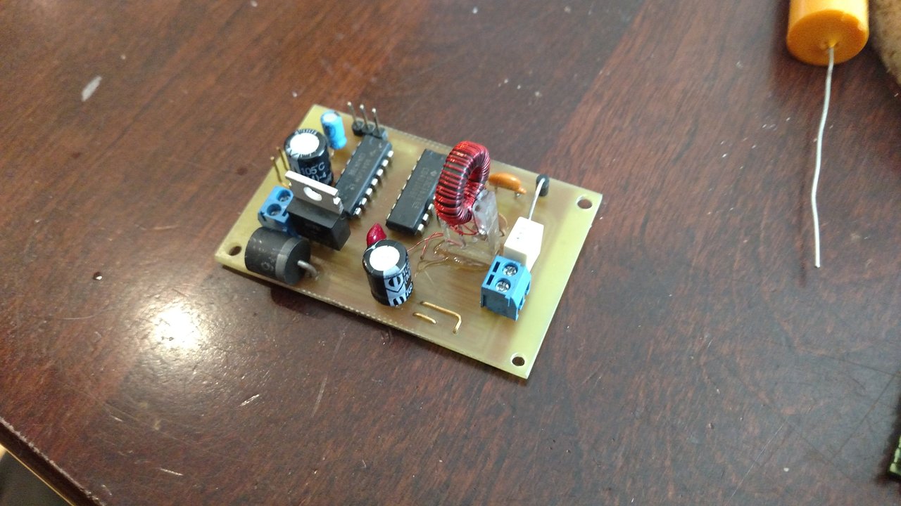

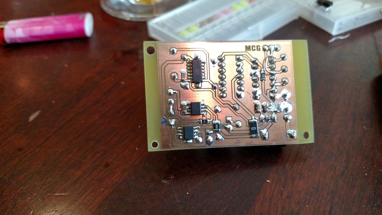

So driver board was finished yesterday and decided to do a quick test before I went to bed and POW!!! Lit up right away, Sweet!!!!! So It seems all is good now, Today ill work on my modulation box, I decided to make a battery powered fiber optic box for controlling modulation at a distance, the sparks are a bit big and scary to come close and adjust anything on the box itself. I have to order fiber optic transmitter and receivers, that's something I dont keep around. I'm going with the audio type connections TOSLINK, TORX1350(F), TOTX1350(F). Then using a 5v arduino with a lipo or lith-ion. Ill update you guys on that build when it starts.
Heres the new driver board, I went with surface mount UCC27322, UCC27321. I also added a CT stand to help hold it in place.

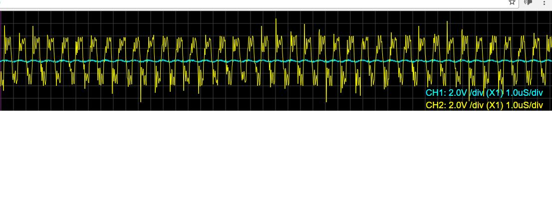

DerStorm8.. I got a new scope!!!! Can you please help me out?
So I haven't updated you guys in a wile so I figured I'd do that first. So I got everything on a pcb, switched to IGBTs, and got a variac if u guys didn't see that. I so far see it working pretty well. The only problem I have now is the fact it likes to cut output power. Sometimes I can turn it on, crank the variac to 80vac and itll throw 8inch arc great for 5-10mins pulling only 3-4 amp from variac. But other times it cuts out in 20sec of use, arc drops from 8in-1.5in and amperage jumps to 8amps... Weird....
I couldn't find anything showing on my old scope but I'm sure I'll find some stuff on this one. But the reason I also switched from a single dual gate driver to now two 9amp single drivers is because how hot the dual single driver was getting. I thought it was getting hot enough to hit a thermal protection and cut the output. Now that I have the two single 9amp drivers that stay cool and I'm having the same issue, I see that's not the case.
DerStorm8 , I'm ready to send you what ever you need and listen. this new scope has a ton of functions I'm not use to. But it's a 100mhz 1GS/s 80kwfs/s. U where right my last one was crap! Total crap!
I have seen some guys do tests where they can see the secondary notches. That stuff I'm not sure how to quite do so if you can be detailed that would be greatly appreciated.
