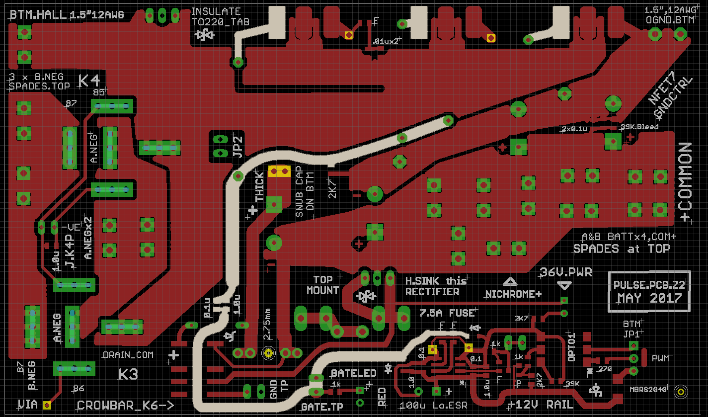

Here is my 'pulse' driver and pulse board.
The off white colored gate drive comes off the smt MCP1407 driver, 8 pin IC, goes thru a pair of ferrite bea ds and then thru a couple paralleled SMT ceramic caps then splits thru 3, 5 ohm Gate damping (thru hole) resistors and then finally into the gate pads of the IRF3205 totaling over 400nC of gate charge.

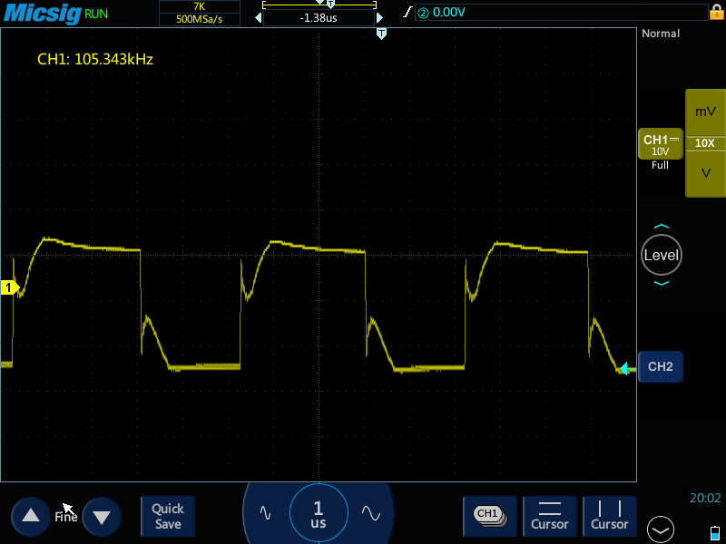

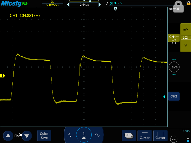

Ya anyway, I did beef up my GDT primary gauge from cat5e to 18 gauge, then changed my GDT winding ratio to 6-8.5. As well added solder to the gate output traces it didnt change my waveform but not by much. Im not sure if its good or bad.
20171026200227.png GDT primary
20171026200518.png At Gate

If the waveform is good at the gate then the transistor is happy.
Maybe what you're seeing at the primary of the GDT is ground loop interference on your scope probe.
Move the scope ground wire around and see if it changes the trace.
