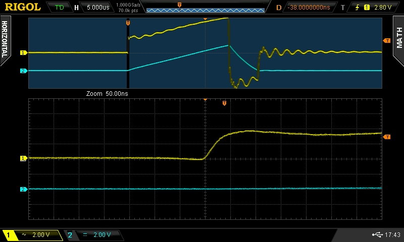

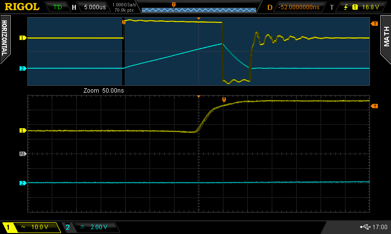

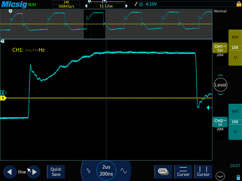

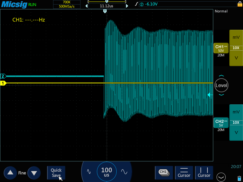

The three attached photos are of my GDT Primary signal loaded. Its not ringing but there is a weird swing. These weird swings do not show on the GDT output. also on the zoomed out photo I am not sure why it waves like that. the GDT output I think has that wave as well. Not sure if thats just interference from coil running. lol hard to scope near a TC!

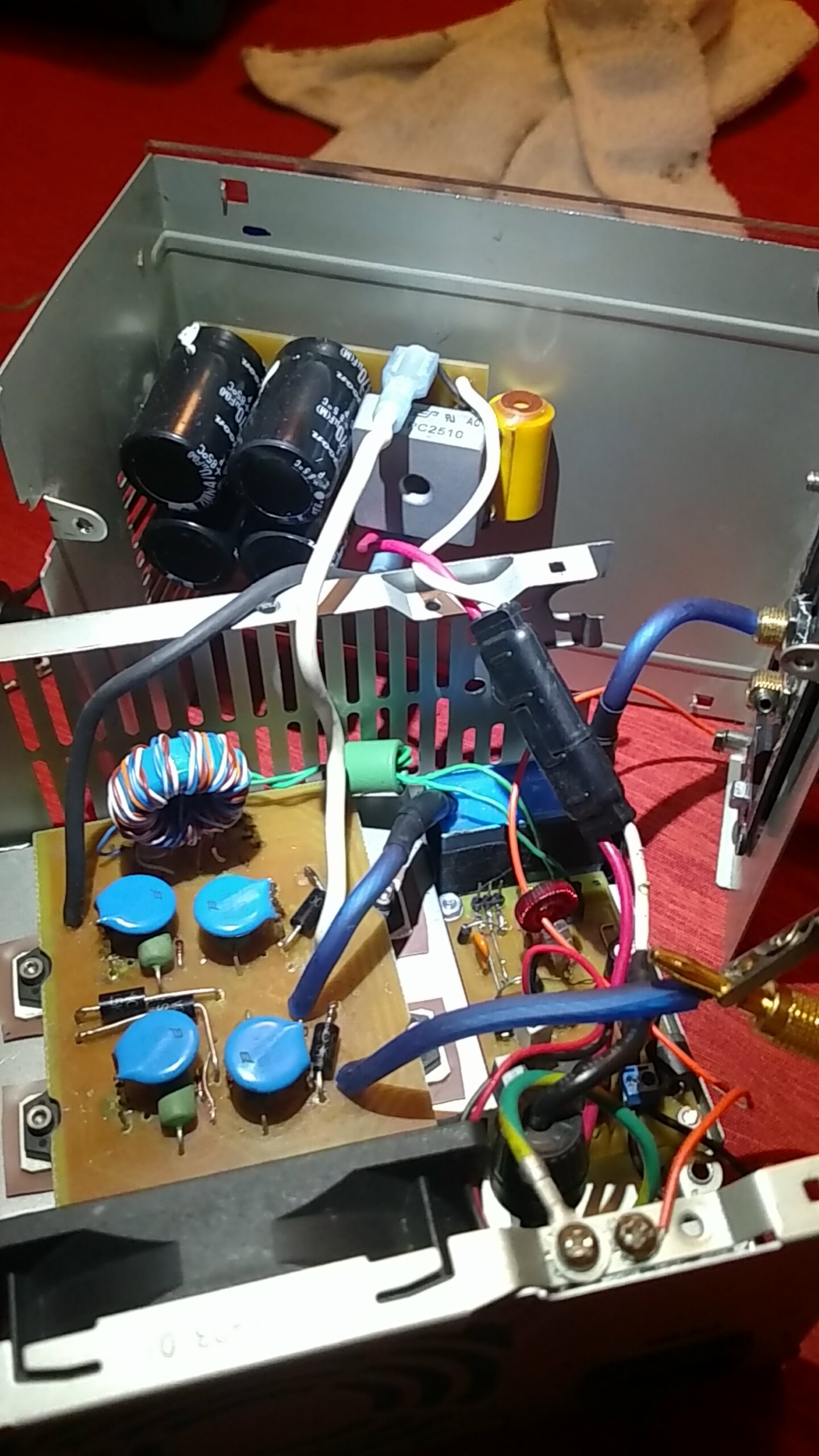

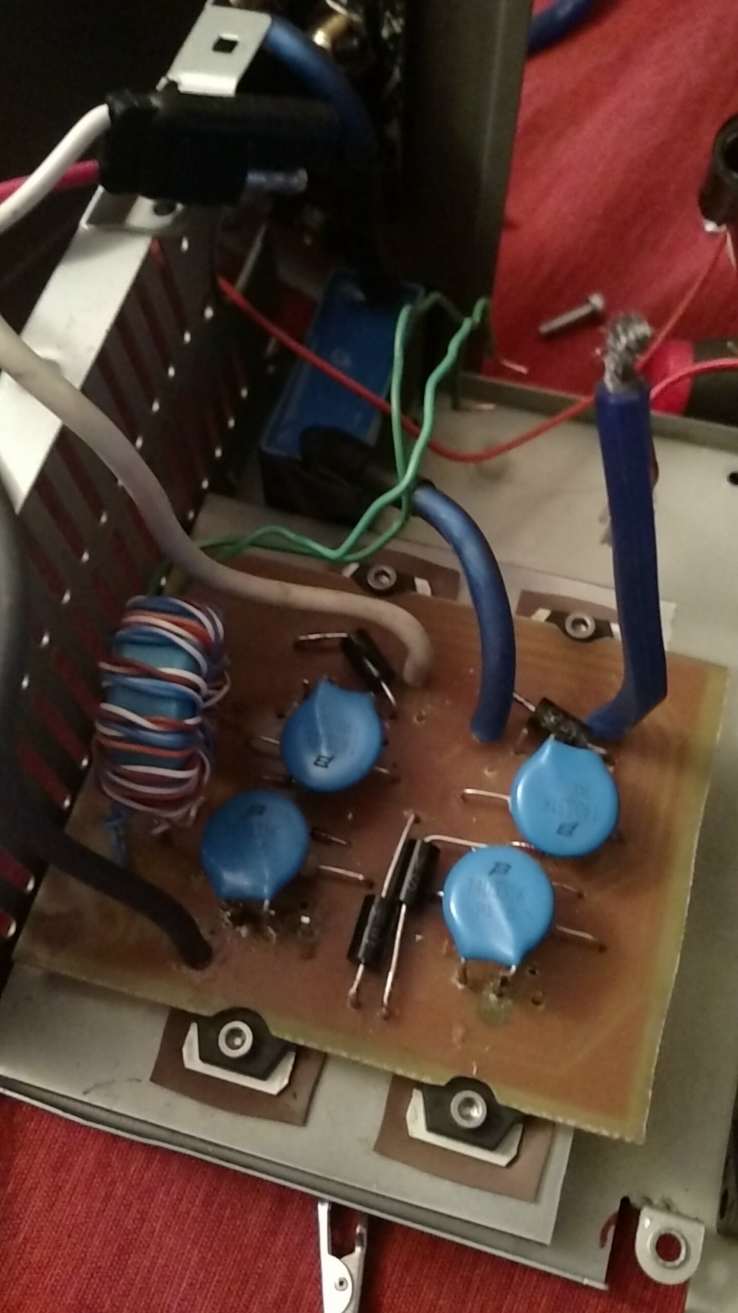

Crap missed one thing. not sure how to draw it on a schematic but both gate wires from driver to GDT wrap around a ferrite bead. I attached a pic, It is the two green wires in the back running from driver board to H-bridge.

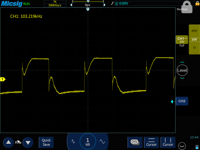

I'm at work but quick comment regarding the GDT waveforms - Ignore the initial spike and look at the rest of the waveform. It should not curve up slowly like that, it should be much more square. The slow curve indicates too high of a damping resistance. Too high of a damping resistance leads to significant switching losses, which means excessive heating. Decrease to a smaller resistance and see how the waveform looks then. Also see how it affects the temperature of your drivers.
I will try to go back to the list when I get home today.

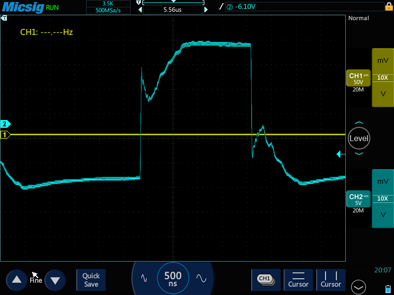

I think you are referring to the gate 10 ohm resistors? But yes I have 4.5ohm I can swap too. I will change and re-post that waveform.
Ok, clearly the switching drive is overdamped. The inductance of the transformer coil would be slowing the required switching transition. After all it is the tuned inductance & capacitance loading in a square wave driven CLASS E amp that smooths out the switched edge harmonics.
If dropping the gate resistor values don't do the job, I'd consider direct driving the gates with the drive chips and use low ESR 10nf and 100nF paralleled capacitors in the drive lines for DC isolation.
Note the square FET switched wave form with a good gate drive below....the Batt pole 'Load' voltage image (#2) shows the effects of about 3uH of cabling on the voltage...causing a ramp compared the the 50nS rise time of the square wave from the FET Drains. The blue trace is the CT transformer monitoring the load's current flow....so u can see how that tracks with the actual voltage rise time at the load. All due to just 3uH of inductance.
Okay so is there any options other then direct drive? I'm a bit nervous doing direct drive with my skill level, scared of frying my driver board.
Would dropping my gdt windings lower this inductance enough? Maybe trying 5-8? Also I am probing my gdt primary at my driver board screw terminals. So prior to my ferrite bead. not sure if I need to test right on the gdt primary or if after or before the ferrite bead may change my reading.
Or possibly changing wire thickness that runs from driver board to h-bridge. Increase trace thickness of driver output traces(beef up with solder for now) increase on finnal etch
Yes, dropping the overall turns would speed things up some concerning the edge of the pulse.
Rather than changing the driver wire thickness, use double or quadruple point to point twisted driver wiring as inductance works like resistance, it drops with paralleled inductance.
Also solder thicken the gate drive traces and widen them if possible. I use desoldering braid to boost trace conduction for higher pulse currents.

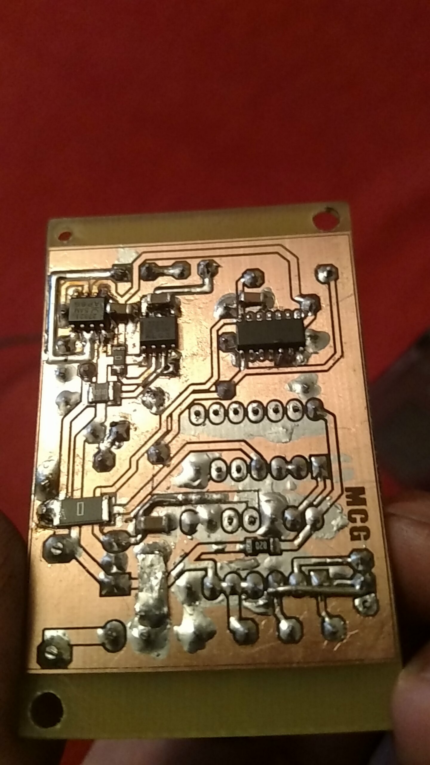

Okay, well just for ***** and gigs I took my driver board out added some solder to the traces. bare with my on the horrible looking solder job I have removed and replaced stuff like 15 times lol. No clue if that'll help but wont hurt. Also found I already did add a 10uf ceramic cap right next to each driver chip. And I my toroid for GDT is 8500u, I think thats high enough.
Mosaic- Do you mean to double up or increase size on wires from my driver board to H-bridge? Im not doing point to point. look at pics, that's my setup, So beef up my green wires?

U have a 0.1uf, 1 uf and a 100uF low ESR capacitor near to each driver chip as well to cover the gamut of transient response and reservoir stacking? That alone might do the trick IF the sag on the scope square trace is at the output pin of the Driver chip.
If the sag is at the output of the the GDT (not the input) then it's inductance can be the issue.
If the sag is ONLY at the Gates themselves then the area of concern is the connection from the GDT to the gates.
