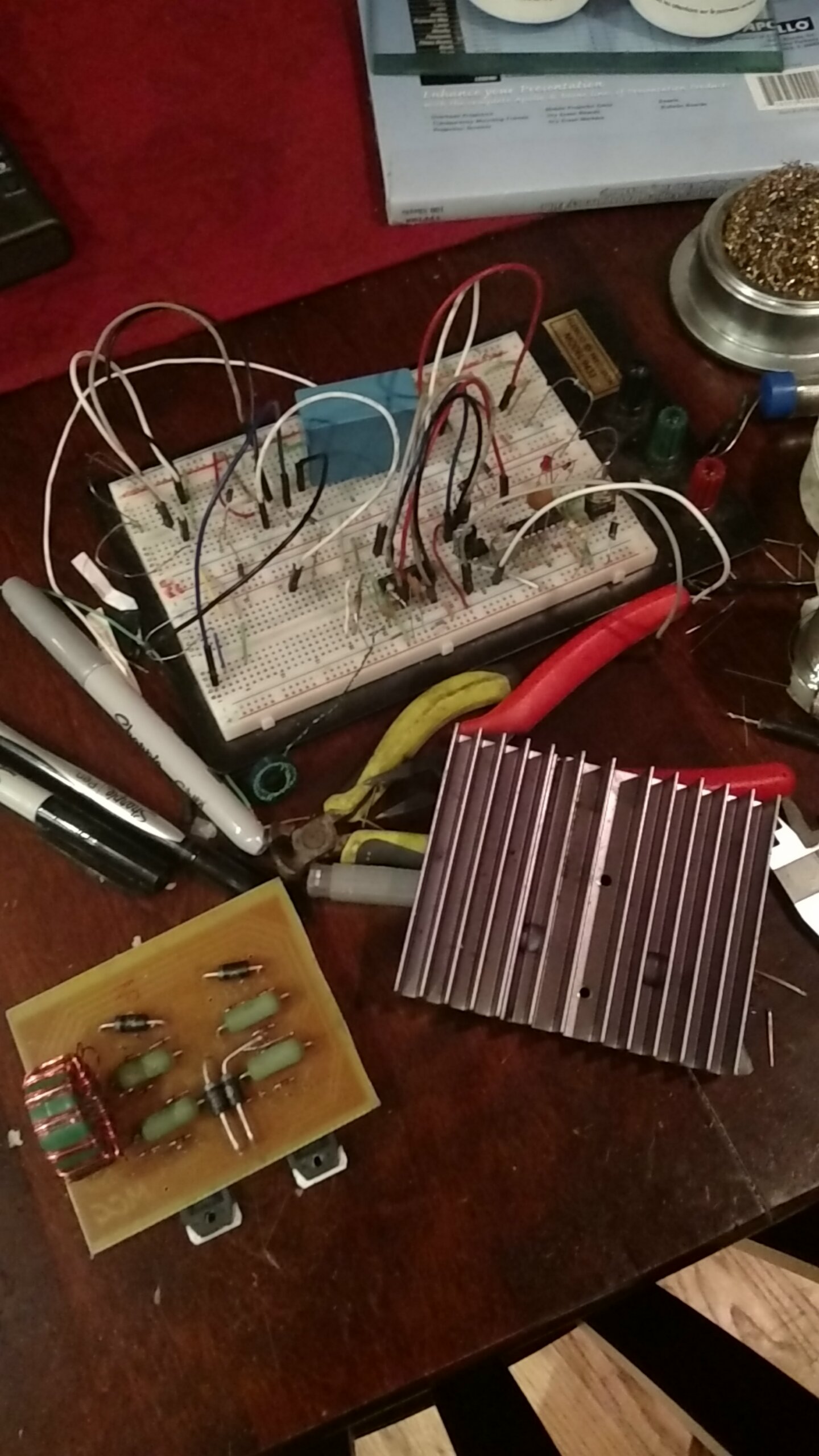

Solid State Tesla Coil Burning Mosfets
I just read up on some of the specs of the DS202 and my suspicion was confirmed -- It only has a bandwidth of 2MHz. This means you will not see any of the artifacts I'm looking for in the bridge switching waveforms. As I said before, the DS202 is NOT SUFFICIENT for this sort of project. Even a 20MHz scope will not show you everything you need to see. You really MUST have a bandwidth of 100MHz or higher.
What I am looking for, specifically, are the large spikes every time the bridge switches. These spikes are due to the MOSFETs trying to switch the direction of current in the primary coil when there is still current flowing through it. The goal is to switch the direction of current when the current is crossing zero. This is called Zero Current Switching (or ZCS). This prevents the large inductive voltage spikes which can damage your transistors. This is the purpose of phase lead. Phase lead allows you to adjust when the H-bridge switches. You can adjust it to switch exactly when the current is crossing zero, thus protecting your transistors. Otherwise, as I mentioned before, your MOSFETs end up switching a little bit too late (due to the hundreds of nanoseconds or several microseconds they take to turn on after they first receive the signal on the gate) which means they try switching the direction of the current in the primary when there is already current flowing through it. Again, this generates the voltage spikes that can cause shoot-through (an arc within the MOSFET that shorts the drain to the source).
Which can also a be an artifact of the breadboard. I don't understand why that can't be understood in this?:confused: If you think all of your "work" will transfer when going to a true PCB after doing this on a breadboard, get ready to do it all over again there.:arghh: It doesn't need to be "pretty" now, just off of a breadboard.

Exactly right. Anything you (the OP) does now is ultimately meaningless because it will behave in a completely different manner once you do eventually transfer it to a PCB. Designing and building a DRSSTC is not a simple task, and soldering/desoldering IGBTs is probably one of the easiest parts of the process. Better get used to it.
Even the original form of breadboarding, using a piece of wood, small nails or tacks, and point to point wiring would be better than a plastic modern breadboard. But it's not my time and components being wasted, so do as you want.

So I think this leaves two outcomes, One the bread board is causing massive problems, Or two the driver circuit being open to air, same height, and within 4 feet of tesla is introducing RF interference making fets wrongly turn on. So I will post these scope views tomorrow. I'll then Cage my driver circuit as well as make a temp PCB board for my H-bridge before my next test. So lets hope this is it!!!

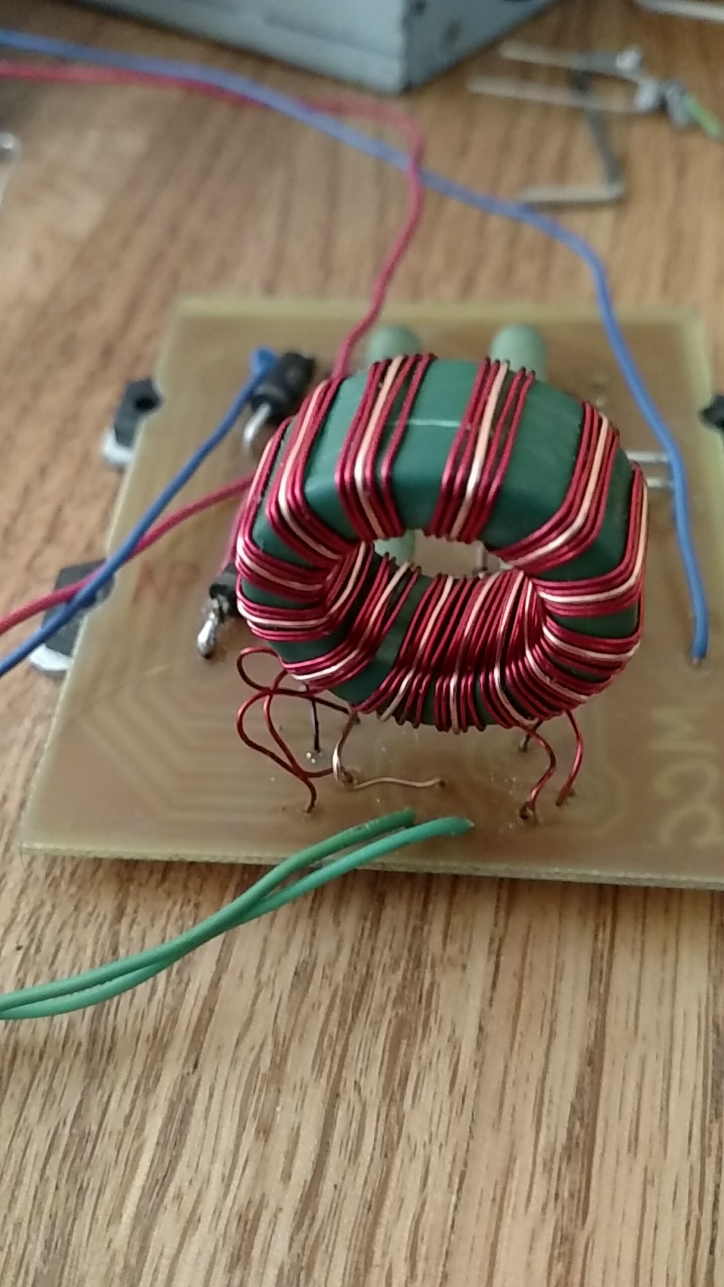

Also I cannot for the life of me get that guys feedback transformer to work. its simple 50turns with secondary ground ran through the toroid ring. I tried flipping connections and way the wire went thinking phase was off. but I cannot get a signal when on transformer leg is grounded. If I leave one end open and other as feedback to inverters it works but isnt that just a wound antenna then? I tried a number of different cores and just cant get it. its like when I ground one of the two pins I just am pulling the inverter to ground so then not pulsing at all ...WTF??? any thoughts on that?

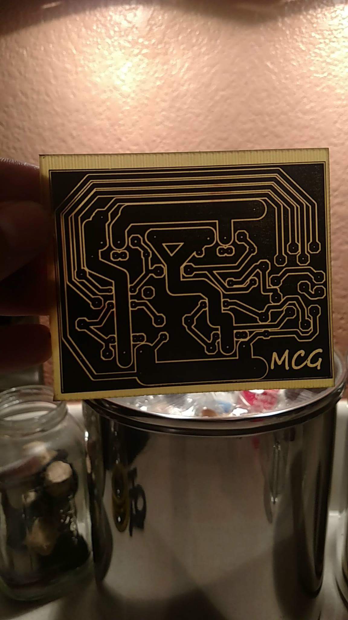

This is my temp board. I hope I did the traces thick enough. I got 90mils wide on my calculations. So I did 180mils. Supply lines are 240mil.

Quite honestly, until you show that you've done your research and demonstrate that you have a more complete understanding of how DRSSTCs work, I'm hesitant to help you any further. I am glad you made a PCB, but that is only one of our suggestions that you followed. You seem to be ignoring everything else. And someone asking questions and then ignoring the answers does not reflect well on them, and often turns away other people who would otherwise want to provide assistance.

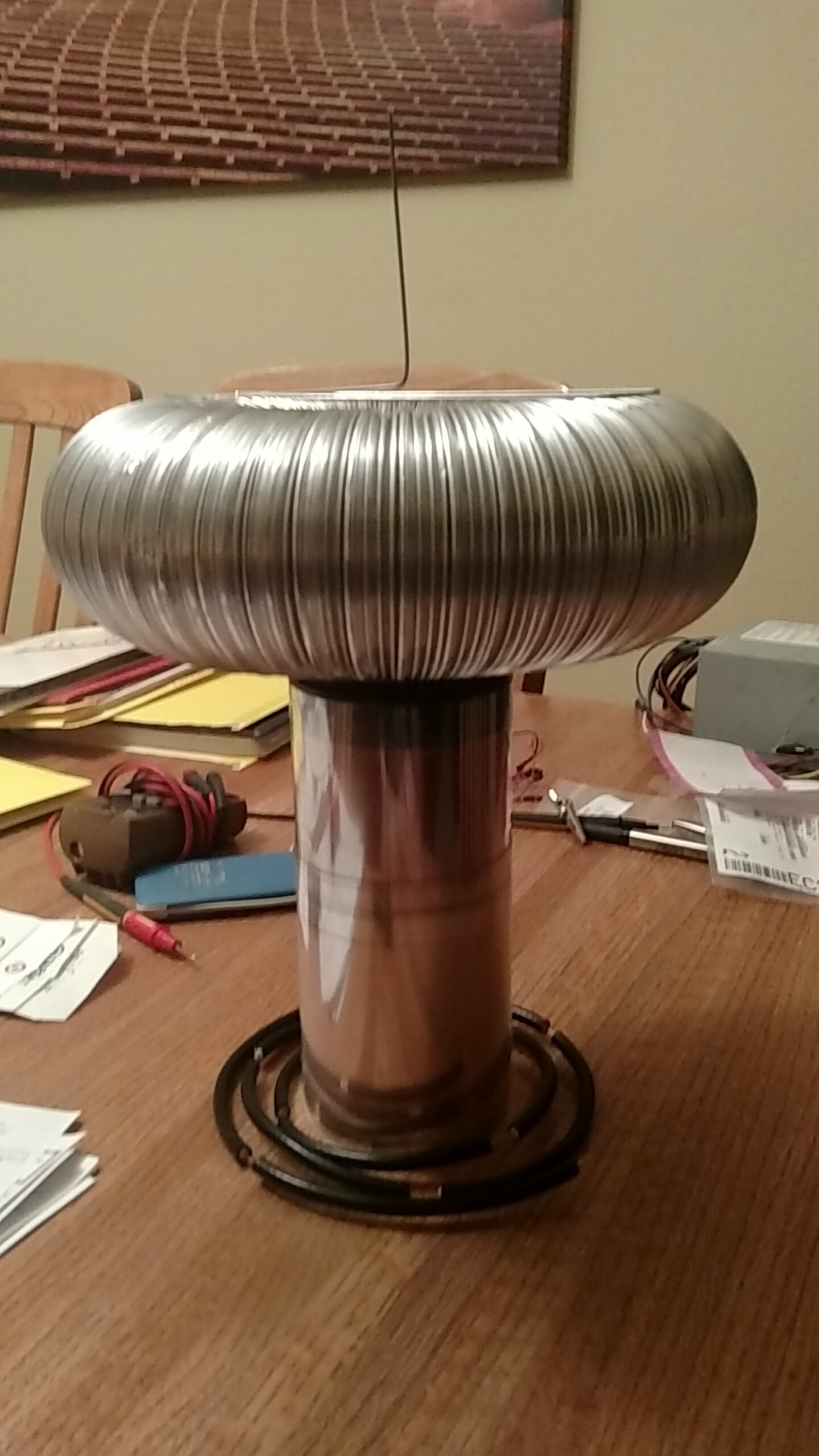

SECONDARY
  1. 3.5" OD ABS
  2. 1210 turns
  3. 36 gauge ( I know that's a bit small, it what I had, if it fries I'll make a 34 gauge)
  4. 3 coats of clear acrylic
  5. 54.487863mH 4.346pf Calculated
TOP LOAD
  1. Toroid
  2. 3" ducting
  3. 4" cooking Pans for center (x2)
  4. 11.122pf Calculated
Secondary with topload resonant frequency: 174.049KHz Calculated (173.3KHz read when self tuned)
PRIMARY (Helical)
  1. 4"
  2. 14 AWG
  3. 6 turns
  4. 0.375 spacing
  5. 28v 1.5amp power supply was best tuned to 2.75 turns with 4.7uf Cap
  6. It will stay lit up to 4 turns, 4+ does not light up
PRIMARY (Flat Spiral) made this due to secondary arcing when testing on dimmer
  1. Center 3.85"
  2. 3 turns
  3. coax cable
  4. 0.5" spacing
  5. best tuned at 2.5-3 turns

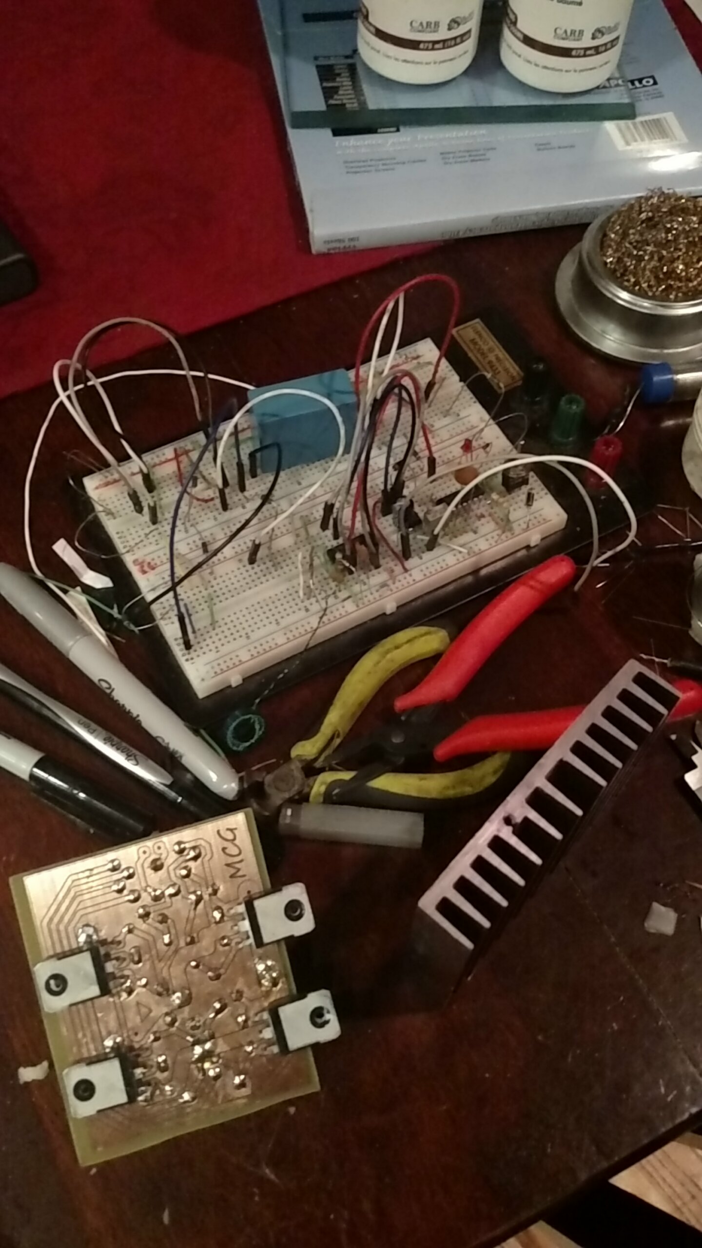

The breadboard to me sounds most likely, it ran for 25 mins total at 60% or less power, Once I cranked it with the 120w halogen I went way beyond the rating of that dimmer.(this was also theoretically on a somewhat half bridge(3 fets) since one of my low side fets output was not connected) That failure could very well have toasted that breadboard to the point of still working on low power but once power is high enough it maybe internally shorts. just a thought.......
Now I will add the arduino and try the pulse width you stated as well as try the PCB, is there any other suggestions you can make prior to going to IGBT's. Maybe something to help the fets, loose the 4.7uf tank cap for now? The cap is a 630v Polypropylene, Blue cap in videos. Possibly add more filtering on the antenna end? Any thing really, just to rule out on my next test.. Also did you see my post about the feedback transformer? any thoughts on why that wont work grounded?
Here are some pics, I will be working on the circuit itself tomorrow so I will add some updated scope photos.

Thank you for finally providing descriptions and images of your setup. A few things I noticed and a few answers:
1) You are running this in CW ("Continuous Wave") mode, which means no interrupter. That is an excellent way to destroy transistors (whether MOSFETs or IGBTs).
2) I did not look closely enough at the series capacitor value. 4.7uF is indeed for DC-blocking, and not for resonance (this is a bit embarrassing that I did not look closely enough at the value, so my apologies there).
3) Being a basic SSTC rather than DRSSTC, the currents will be lower so you may be able to get away with FETs after all, provided they are fast-switching and are rated for a high-enough voltage/current.
4) In a DRSSTC the resonant capacitor is connected in series with the primary, because the H-bridge needs to be able to switch the direction of current through both of them. Electrically you can have an LC resonant circuit with the cap in series or in parallel, but in an H-bridge (or half-bridge) they must be in series.
Which post has the question about the feedback transformer? Have you probed the waveform yet?
Also I cannot for the life of me get that guys feedback transformer to work. Its a simple 50turns with secondary ground ran through the toroid ring. I tried flipping connections and the way the wire went through thinking phase was off. but I cannot get a signal when one transformer leg is grounded. If I leave one end open and other as feedback to inverter it works but isnt that just a wound antenna then? I tried a number of different cores and just cant get it. its like when I ground one of the two pins I just am pulling the inverter to ground so then not pulsing at all ...WTF??? any thoughts on that?
Yes, when scoped, if one pin is grounded I get no reading on the other. If one is floating I get a decently clean wave on the other, isnt that a wound antenna tho?
Yes, if you leave one end floating then it becomes a basic antenna and not a current transformer. I am curious how you built your transformer. What are you using for a core? If I had to guess I would say you're using the wrong core material. Powdered iron toroid cores, for example, are extremely common and used in all sorts of applications (power supplies, especially) but are TERRIBLE at high frequencies. They are most often used for chokes, rather than transformers. For a CT you really need something with an extremely high permeability (>10,000). The cores I use can be found on Digikey (https://www.digikey.com/products/en?keywords=495-3868-ND). I would expect this is the most likely reason for failure.

On the core of the feedback transformer, I tried 4 different ones Im using toroids. I guess they all may not be ferrite. Ill poke around in my crap for some others. I usually try to use audio ones, I have had 100% luck with those but there a little big for this.
I never recommend using salvaged transformers for Tesla coil CTs because it is very difficult to know what they are made of. Unless you have a lot of cores and want to do a lot of trial and error, you'd probably be much better off spending the $3 and buying a brand new one with known specs.

Okay so I did test the PCB bridge on low power, Success!!

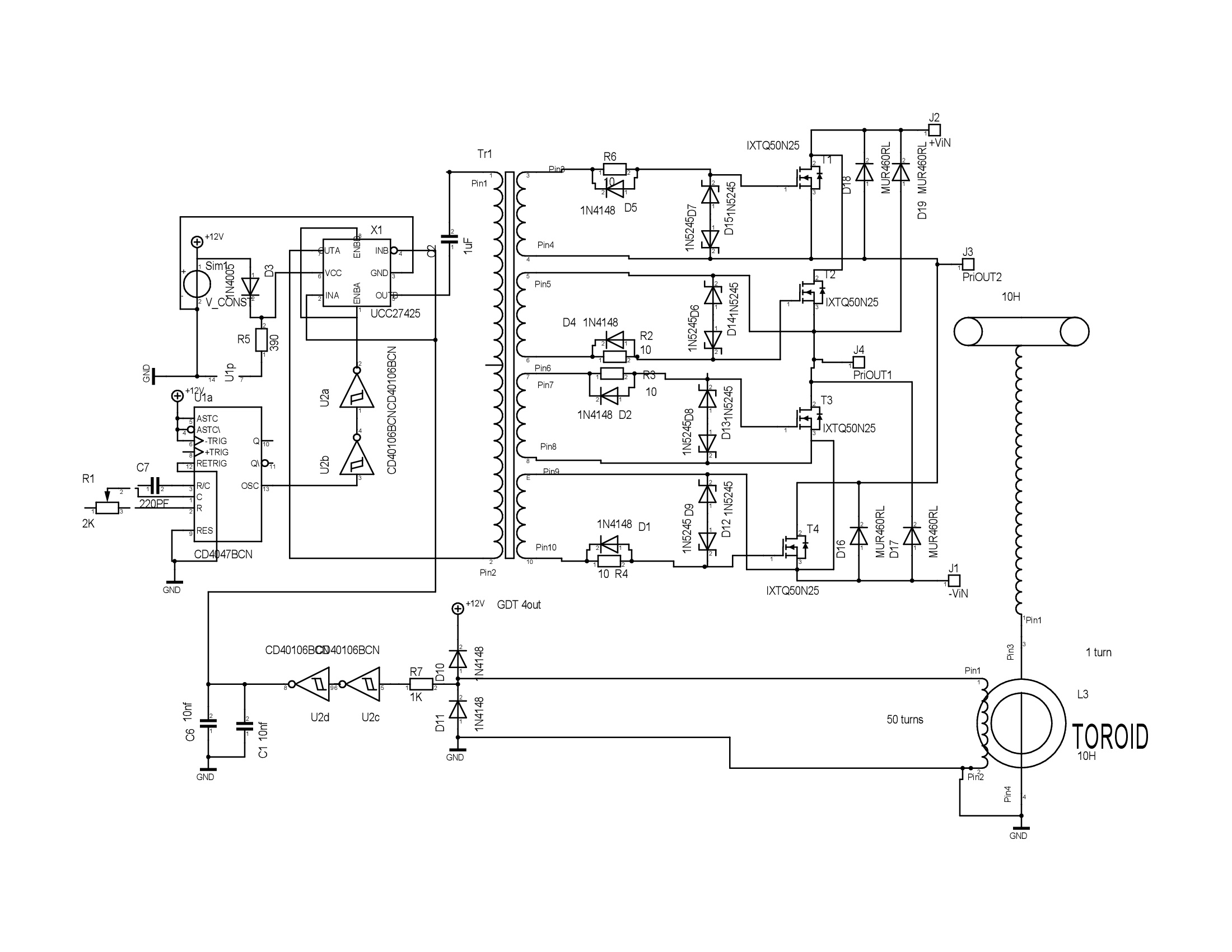

I also posted a schematic of what I am doing now. I added how i am connecting my feedback trans. maybe somethings wrong with it..

Thank you for FINALLY providing a schematic of what you're ACTUALLY doing. We've only been asking for this since the start :p
Right off the bat I see a few problems:
1) You should be using 74HC series logic. CD4000 series is probably not fast enough
2) The feedback section must be referenced to +5V, not +12V (important when you use 74HC logic)
3) C1 & C6 are a huge mistake. If you look at Guangyan's schematic he uses a 0.1nF capacitor (that's 100pF). At 170kHz the reactance of the capacitor is 1/(2*pi*170kHz*0.1nF) = 9.36k ohms. You, on the other hand, are using two 10nF capacitors in parallel which equals 20nF. The reactance of your equivalent capacitor is 1/(2*pi*170kHz*20nF) = 46.8 ohms. You're creating a low-impedance path to ground at your resonant frequency, which pretty much guarantees the driver will not receive a sufficient feedback signal.
4) How are your GDTs wired? What are the turns ratios? I ask because your driver is only driving them with 12V, and the MOSFETs may need a higher voltage than that in order to turn on fast enough for your purposes.
5) Where is your reservoir capacitor between VCC and GND of your driver chip?
These are all just at first glance.
These have a prop 60ns, trans 40ns, 74HC14 have prop 20ns trans 6ns, Now yes its slower but ur telling me 60ns cant switch 170khz? accurately? It Ran my 600khz secondary just fine. I can post a scope of that out put, looks great to me.
Im running 12v because Im not using 5v logic... That was part of my design I liked 12v. Are you saying I cant do that, if so why? I understand its different from everyone else but ur saying u cant run the driver at 12v?
That was a mistake, Sorry those 2 are not there, there is one 151 there, so 150pf...
Since Im driving at 12v I did 12 primary 12 on secondarys, I get 10.7-11.2v out, I was thinking of dropping a turn or two on primary to up to 13v ish.
Right now my driver is powered from a PSU 12v rail. I did stick a 100uf cap there yesterday but no change but i left it.
