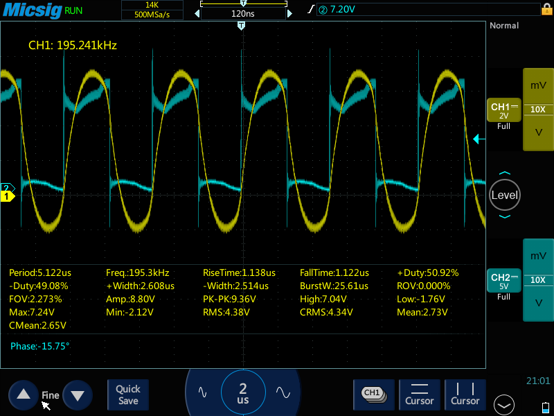

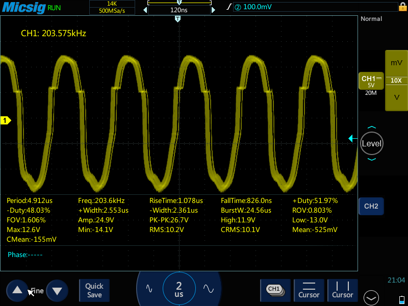

I took a look at my gate signals and they are very rounded. so, Im also going to re-create my driver on a bread board again, just to see whats going on.. I did realize the issues of the CT not working for me where due to the type/model of 74hc14 i was using, I tried a different one and it wouldnt work with those capacitor values. I got some other types of 74hc14's so Ill try to recreate this and See whats happening with the new scope.
Okay so after setting up a bread board version, Same as schematic but with changes on signal input. I am debugging so my input is now an arduino outputting a 170.3khz wave instead of using the CT or wile operating the TC. The arduino output goes through two CD74HC14iM96 with no filter capacitors at all So arduino->CD74HC14M96_x2->UCC Inputs.

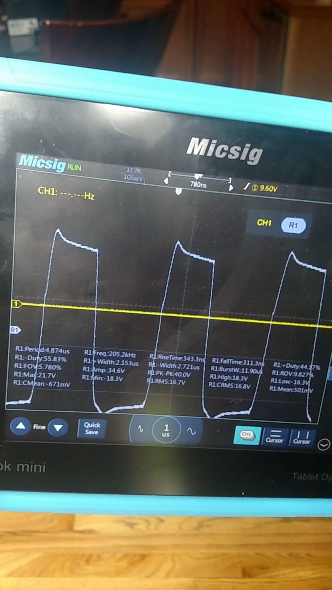

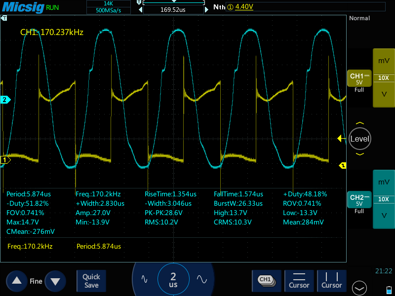

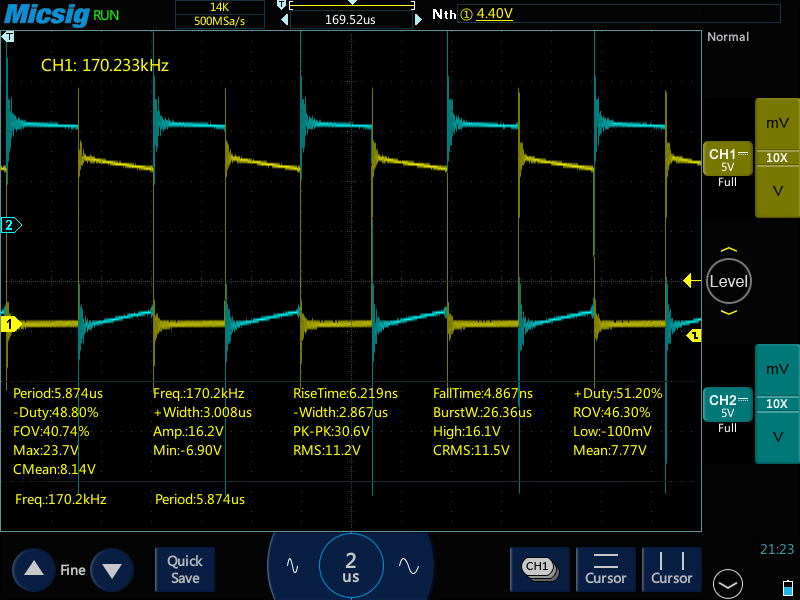

So I got worried once I saw my GDT output was almost a sine wave. So did these tests....
Yellow CHA Is Gate driver output from UCC3721
Blue CHA is showing the GDT outputs bellow
Img#1- Arduino->inverter_x2->Gate drivers->1uf on GDT input from UCC3722, UCC3721 straight to GDT->GDT outputs on PCB to gates
This GDT is the one on the circuit, new, I ordered 8500u... this is in bridge circuit.

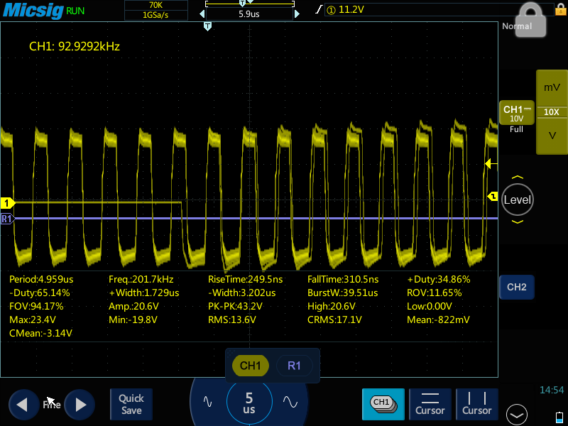

Img#2- Arduino->inverter_x2->Gate drivers->1uf on GDT input from UCC3722, UCC3721 straight to GDT->GDT output OPEN/Probe to one/GND to other
This is the old Toroid I was using first, with output only to scope(No Load), you said to get a known value but this seems to work well. Of course I cant see what the current (Known value GDT) looks like out of circuit since its on the PCB but this looks great.

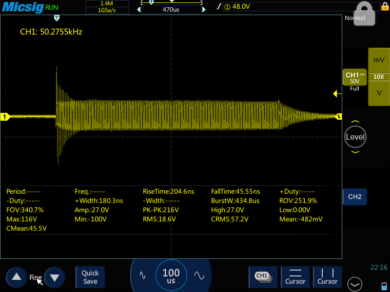

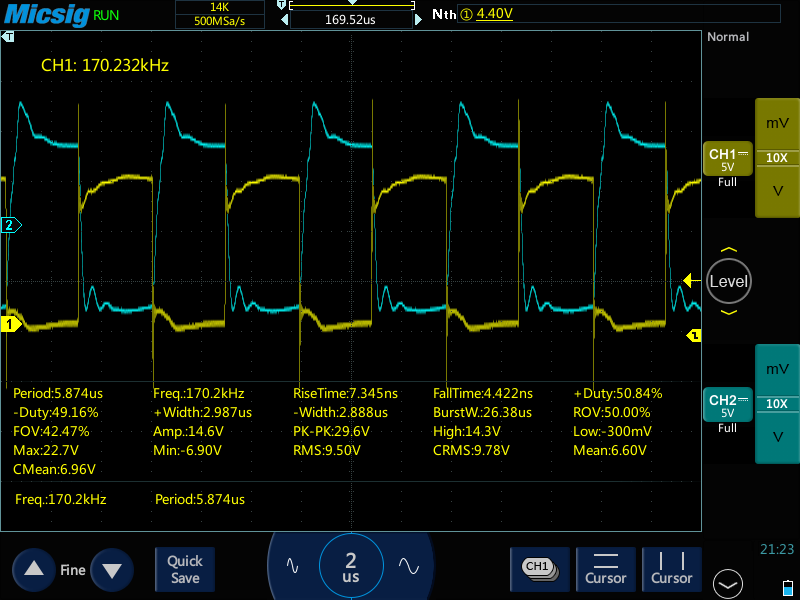

Img#3Arduino->inverter_x2->Gate drivers->1uf on GDT input from UCC3722, UCC3721 straight to GDT->GDT outputs --- probe GND to IGBT source/ then Probe to IGBT gate
This is the old GDT again but the output I am probing/grounding and I connected it to one IGBT's source and gate. So now this GDT output is loaded.
From what I can tell here is my old(unknown value) toroid looks cleaner, Does this mean the permeability is higher? What is your opinion on this? keep current 8500u or go back to the old toroid?

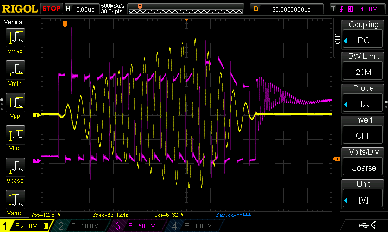

I have just been given a 1000:1 attenuator lead for an oscilloscope. Are they a useful tool for tesla coil technology? It says it's rated for 20kV (40kV) If not, what are they used for?
C.

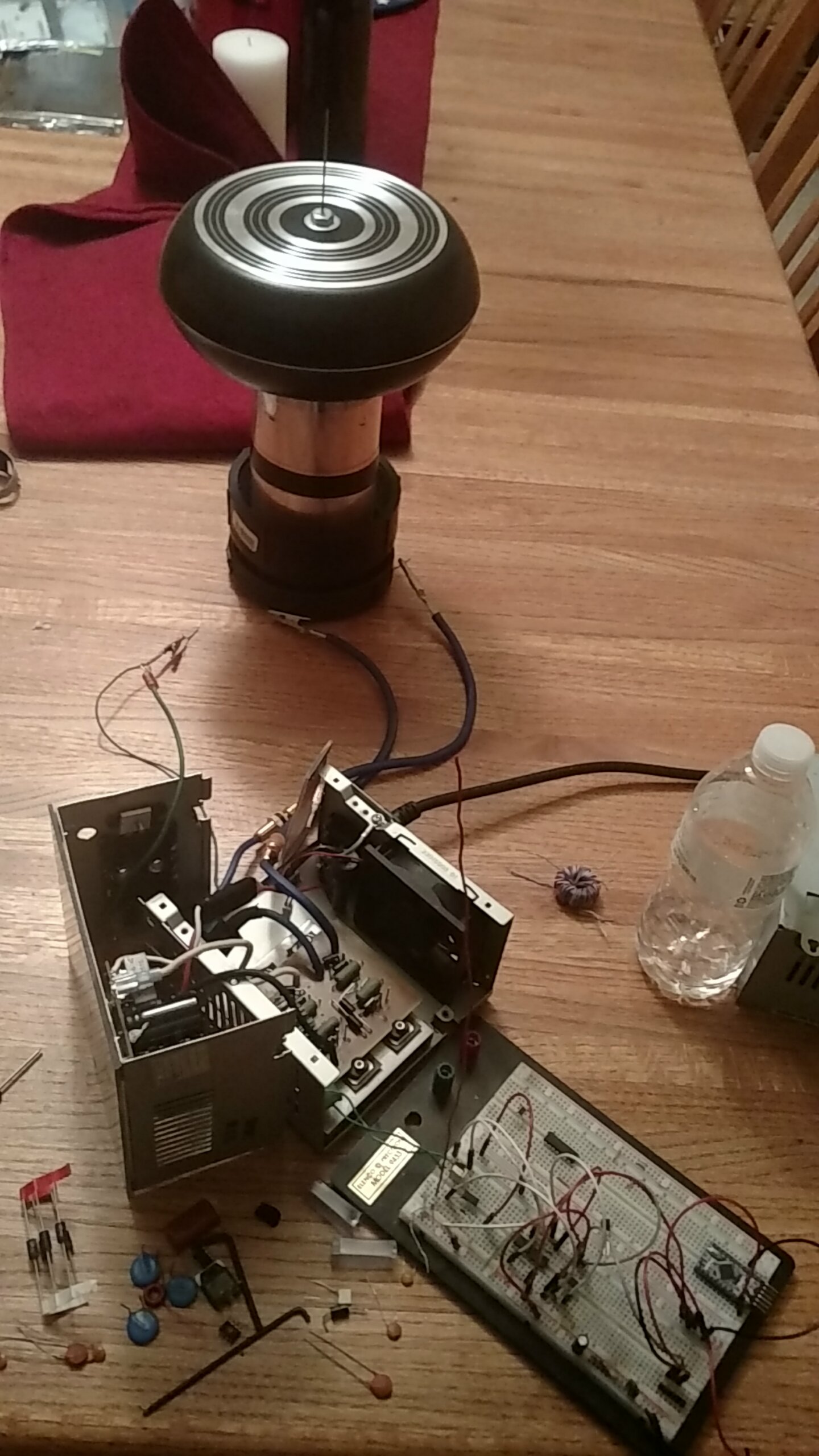

So as I said before I was getting a power output cut. Best way to explain this is
, I have my driver board powered up, Variac goes to a 30amp rectifier then 4 470uf 200v Electrolytics. My PSU box was together but not tight. If I slowly increased the variac I can see it light up at about 20V 0.58Amps AC, I could crank to 90VAC no problem for about 5 straight days each about 20 2min runs, working so well I started to work on my arduino and music modulator . all the sudden one day as I continued increasing it just cut out. It will drop at least 80% of arc length and AC current almost doubles. It was very rare that this happened, then became more and more common. Most these good runs where with this PSU box open and TC on the side.
Then It started to do this all the time, if i assembled the box. It was constantly pulling twice the current and barely any arc. If I disassembled the box and laid it out on the table again, it worked!, just fine up to 90VAC no problem. I searched and searched for anything contacting or causing stress on anything that shouldnt...Nothing! So I tried again to put it together thinking im finally done and same issue... WTF..... then for the third time took it apart and laid it out on table. tThis was the last time I did, it then started to cut out like crazy, even apart on table(never happened this much before). It got worse and worse in 1 hr of testing to the point where I cannot get it to output a good arc anymore..
This is when working great. This was @ 75VAC 3.8amp AC...Then box was together just not screwed tight/pressed together. I started having these troubles after just pinching the PSU box shut, less then 3mm more then this picture, screwed it together and put TC on top and thats when problem arose. as you can kind of see I have 1/4in acrylic on the top.
another view
orca-image-1503114909518.jpg_1503114909974.jpeg This is how it looked the final time I had it laid out, this is when the problem got worse and worse.
orca-image-1503114929244.jpg_1503114929660.jpeg This was todays testing, with a newly made antenna driver on bread board, was looking to see if my driver was the problem. This showed its not my driver, Still barely any arc and lots of current draw.
IMG_20170818_211047503.jpg This pic is from today, with new bread board antenna driver. 65v 5.3amps AC. as you can see here its a super weak arc for what I have seen this do.
Could this maybe be that my 470uf 200v storage caps are dead? Maybe one bad sucking my output down. maybe I was seeing it slowly fail since I was finaly pushing this TC?

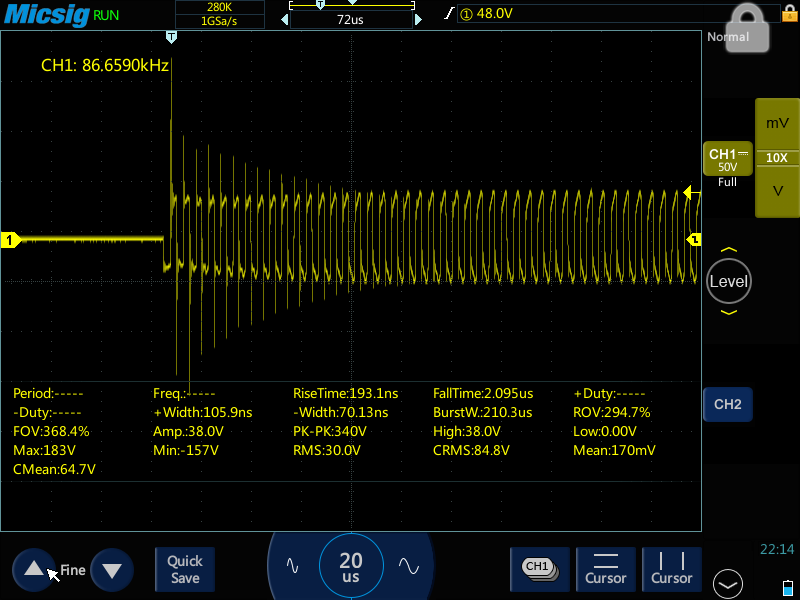

Before I get to the problem I have found and fixed, lets look at what my waveforms looked like.
20170818210136.png Yellow is antenna signal. Blue is Gate Driver output.----- to me these look pretty well

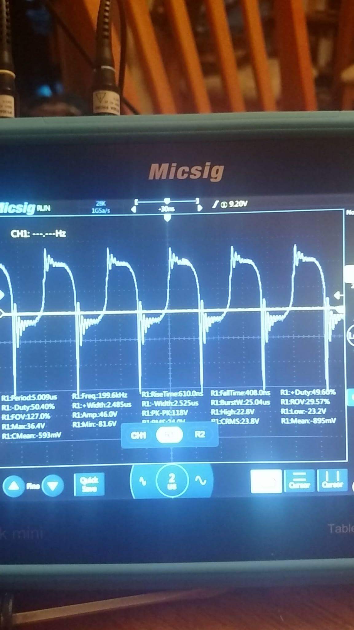

20170818210421.png This image is my IGBT gate signals... ouch I didnt like this
received_10209141487686665.jpeg Sry this was with my phone, But this is my bridge waveform loaded... ChnYellow GND to one side of my primary and the probe to the other. I noticed the side of my bridge without the DC cap had one massive spike going on.
So I have so far made a new driver, Replaced my MOV's, TV's diodes, GDT, DC Blocking CAP, Power storage caps and rectifier, and my primary. Still has barely any output. This Insane Spike on half my bridge got me worried... I found what it was!!!!

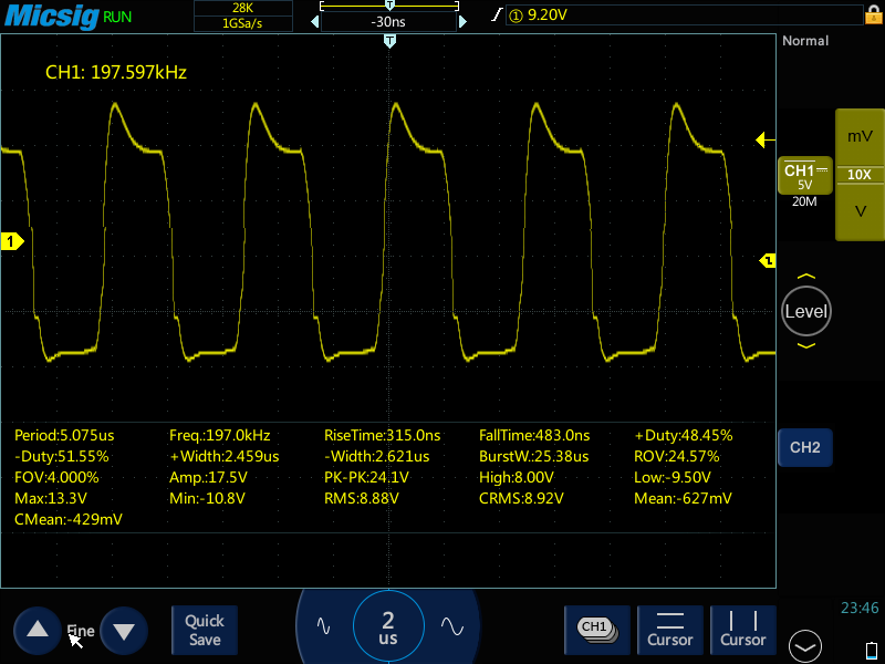

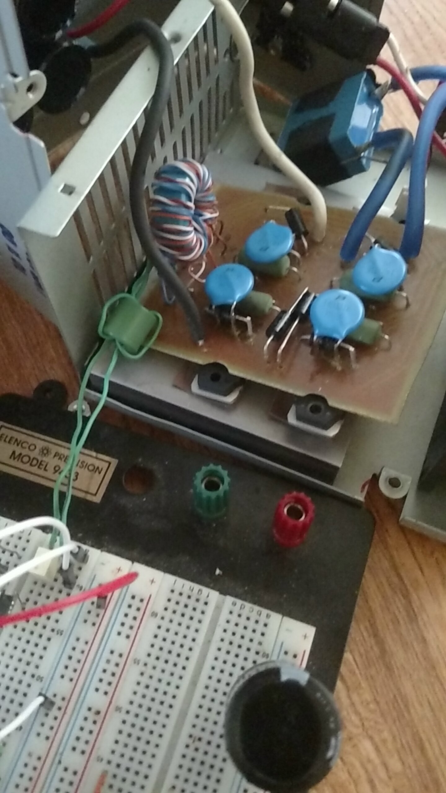

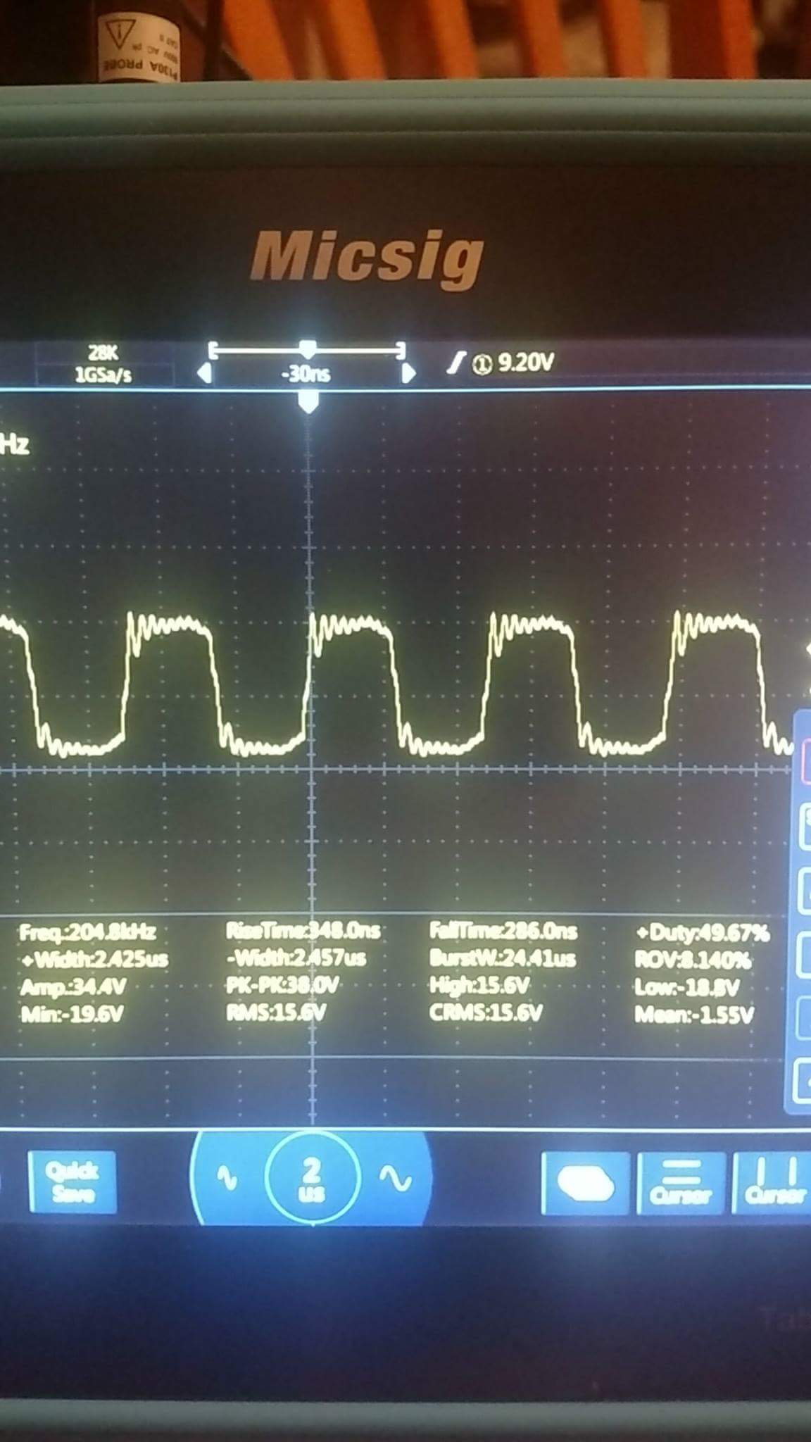

orca-image-1503254364543.jpg_1503254365067.jpeg This..... You can see my GDT in this pic, The green wires are from driver to the GDT primary. I had a ferrite bead on this to help noise. I always had both wires going through but on a different forum I was told to only have one of the two wires wrapped around the bead. Now that I thought of it this cutout problem arose right after i did that. So just for grins I decided to wrap both wires around it again.
20170819234613.png What a difference, WOW. Look at my IGBT gate signals now. I still dont know why its flat on the bottom and slopped on the top.
received_10209141529847719.jpeg Now heres my bridge output loaded.... Spike is gone!!!!! WOW that changed a lot!!! Maybe Matt can explain what happened here..I have no clue but its a ton better...
So even though I cant find a bad IGBT with my multimeter I think that spike fried one, I know from experience it only take 3 working switches on a full bridge to light up, you get a huge reduction in power. So other then my primary those are the only things I have not replaced/ruled out
Okay I Found my Problem!!!!!!!!!
I have a clamping RMS AC/DC current meter, I was getting 6.25 amps at about 40VAC on my variac. I then decided to clamp on my primary wire, Only showing 0.75amp... WOW.... Losing 5 amps somewhere.. okay so I changed my IGBT's, Same issue. That leaves two things, My secondary and my gate clamping diodes.. So I looked at my gate waveform again...
So the cause was the fact i took one of the two wires out of the ferrite bead. The failure was my 1.5KE20CA tvs diodes clamping my gate. I'm a retard and didn't look at the voltage on my gate waveform at first, you can see in the sine wave pic I was around 12v. Once I fixed my bead wire, I then got more of a square wave but my voltage was only 8v. You can see the diode conducting, causing the droop on the top of the waveform... ouch.... I had this at 18v So WTH man... Okay de-soldered the TVS diodes and wallla 18.3v Yay!!!!!...
So I take it that my issue was the TVS diodes conducting way to early, This then caused my gate voltage to drop in the linear "ON" region of these IGBT's. All that extra power was being dissipated in the IGBT's. I wasn't detecting any heat since I was only pushing about 2-300Watts, these handle 650w. Overall a bad output dude to the switches not being fully on. Cause was the wire through the ferrite bead, Why?, No clue.... Matt?? LOL

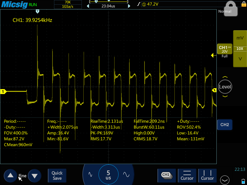

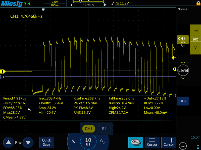

Okay not to confuse you Matt I'm okay with starting from the top but I just found this... My gate input(GDT output) Is Glitching like crazy. I can lessen this glitch as I decrease "ON Time" with my Arduino, as I decrease I see current fall(of course do to less on time) but I can go low enough to where the glitch disappears, when it does I drop almost 2 amps right away! This may be my output reduction problem.
Matt, really not trying to confuse you here. I just know I'm so close, So I want to try what I can. It's all I'm doing today, Want to NAIL IT!
This Is when I get rid of glitch and amperage drops like all hell
so this guy on 4hv.org (https://4hv.org/e107_plugins/forum/forum_viewtopic.php?144747.30)
He was having the exact looking glitch signal I'm getting. He fixed it by a resistor across bridge?? Took him 3 years to fix it, wow I hope this doesn't take that long..lol
EDIT:
Okay , This isnt a glitch....I think. Its me not knowing how to use my new scope LOL. My modulation pulse doesnt pulse in sync with my ct input. The rise of my modulation pulse triggers in no relation to my input pulse so sometimes it'll switch when my input is high, low, inbetween etc. If i trigger it on the rise of my yellow(gate output sig) it can be right at the start or half way through a pulse width(all depending on where modulation triggers in relation to this input), then causing it to gitter.
If I set this up so my modulation signal is every so many input pulses(in sync) Im sure I would not see this gitter anymore. The reason it looked clean when I lessened my on time was that it fell in sync. weird lol.
