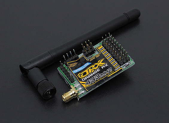

I've been using pairs of these: OrangeRX TX/RX
They seem pretty good, and can be programmed, I changed frequency to the Uk legal 450MHz I've made a receiving Yagi, for better reception. And the range should be long.
I send GPS signals back to a computer.
