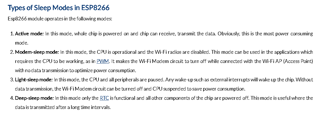

Hello. Im almost done with the sketch for the transmitter but i have a problem. So i need to put the transmitter to deep sleep to keep the battery alive as much as i can. The best way to wake up the esp is with external mode. BUT i need with some way to do it from the rst pin. So how can i do this? I break my head but i cant find a solution. How to wake up the esp when my circuit is close? I will give different source of power to the circuit and different to the esp. How can i do the rst pin goes LOW? :/

Processor starts and disables its own reset circuit.....temporarily......performs the
messaging, then checks for more bounce before re-enable, or uses period delay
or processor does not go back into sleep until host (user) presses on hostESP8266
a button to transmit message to go back to sleep (after removing fish).....
Regards, Dana.
