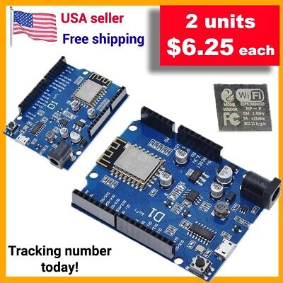

5) There is a dev type board also to have that is useful in your lab :
I just randomly picked this seller on ebay as example.
