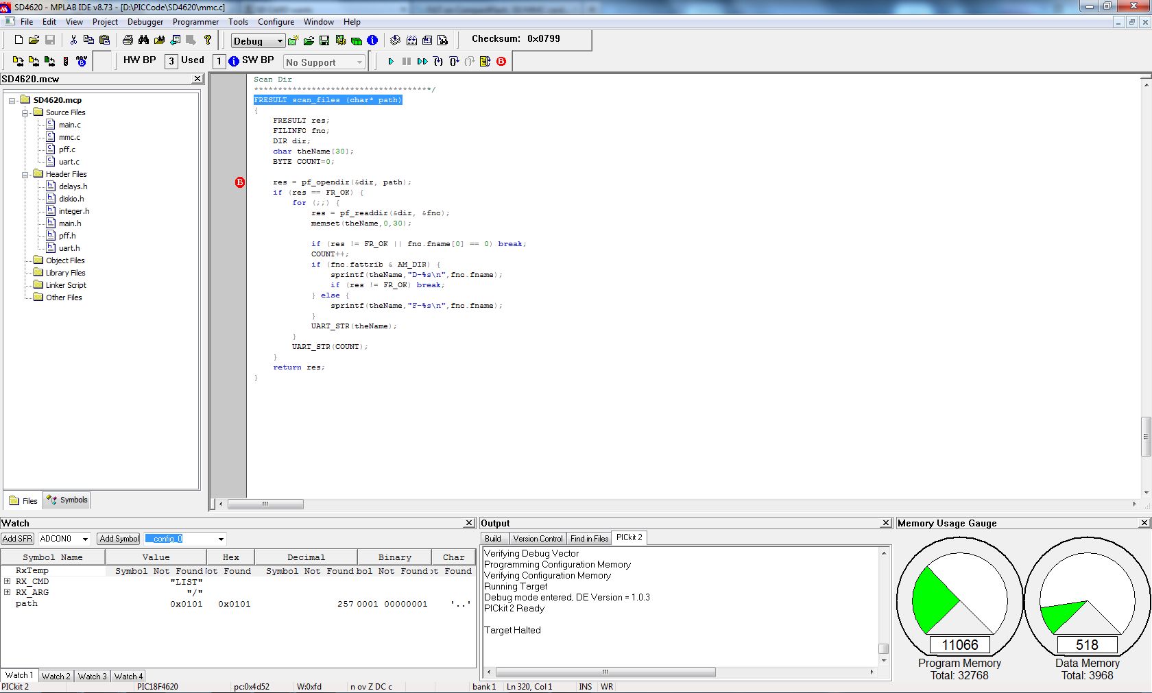

OMG the way PIC handles memory sucks!
I cant seem to send one string to another funtion.
This is in my MAIN function:
	if(strncmp(CMD[LIST],RX_CMD,4) == 0)	//Send out directory listing
		res = scan_files(RX_ARG);
		return;
Now i know for a fact that RX_ARG is 128 bytes long and containes "/" only the rest are zeros. Why in the world when i pass it to
scan_files(RX_ARG);
It says its 0x0101
This is the function:
FRESULT scan_files (char* path);
I dont have this issue with the EXACT same ARM code so i assume its a stupid PIC thing... Can someone pls help me out... thanks

Ok figured it was showing memory address now it has the correct one at least
EDIT: Also i forgot
#include <stdio.h>
for the sprintf :D
