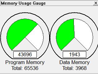

Ok i got the parsing down, so the user part will work now im testing the actual WRITING part. Will it create my FILE with the data in it???? lets see :D :D
If it passes it will send the USER the amount of bytes written to the file. If it fails it will send the user a 0x00
YES!!! Works great so far! Have to work on APPEND now :D should be easy since write works now. I can simply reuse the write with a jump to end of file for append. Like i would read until the end of file and get a point to location and add to it :D
