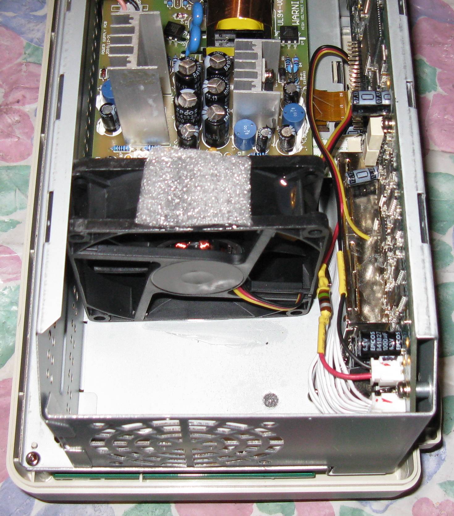

I'll going to void the warranty on the Rigol DS1052E and change the fan.

I'm thinking if I use a series resistor I can slow this fan down to maybe 1700rpm
and get close to the same noise level and air flow as the Noiseblocker.

There is just enough room for an 80mm fan mounted away from the case grill.
Any thoughts?

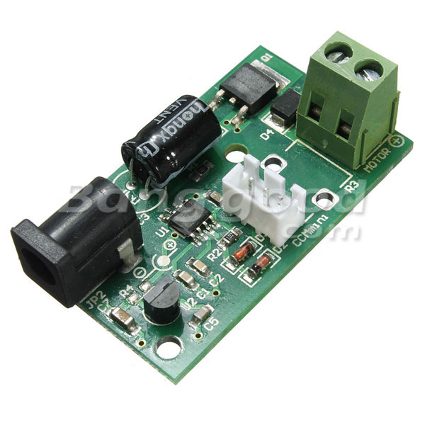

I'm collecting information to build a 555 motor speed control as another option.
Might be overkill but BangGood.com sells speed controller boards for about 2 or 3 Euros.
I expect I'll try the zener.
The Chinese PWM motor speed controller is very cheap. I wonder if it will work properly, let us know.

Looking at the pretty picture we can see that there is no real heatsink but one could be added.

Specification:
Material: PCB and electronic components
Input voltage: DC6V - 28V
Sustained current: 3A
PWM euty cycle: 5% - 100%
PWM frequency: 21KHz
Module dimension: 50 x 29 x 16 mm / 1.97 x 1.14 x 0.63 inch (LHW) (approx)
Cable length: Approx 200 mm / 7.88 inch
Do you believe the specs from BangChang?
Look closely at its R3 and R4. They got so hot that they de-soldered themselves.;)
Perhaps he defected.
In Southern USA there are tunnels under the border from Mexico. The big holes on the pcb for R3 are like those tunnels.

Rigol new fan
60mm fan replaced with 80mm.
Glued to chassis and a packing foam glued on top of fan.
When shield is in place it will help to hold the fan in place.
We will see :)
a 15 ohm 1 watt resistor in series with the 11 volts provided for the fan
has the fan receiving just under 8 volts and it is fairly quiet.
To make it adjustable would mean I would always be fiddling with it :)
The fan still has adequate torque to always start when I stop it with my thumb.
With shield in place I can feel no hot spots and the only place that is warm
is where the air leaves the instrument.
An adhesive heat sink has been attached to the 7905 regulator.
