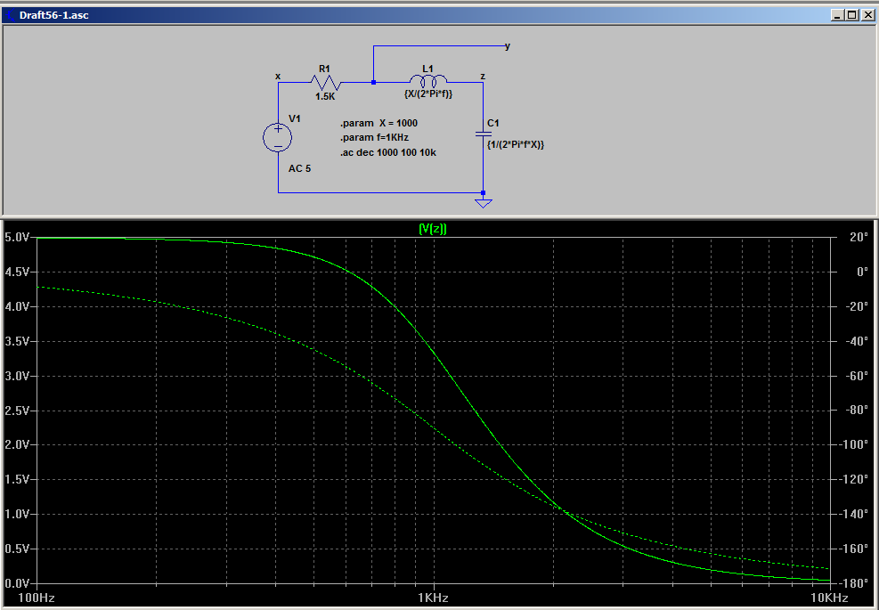

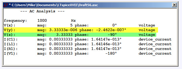

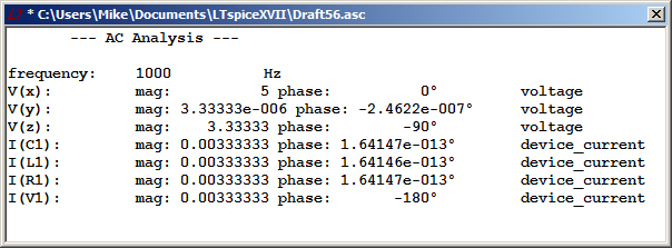

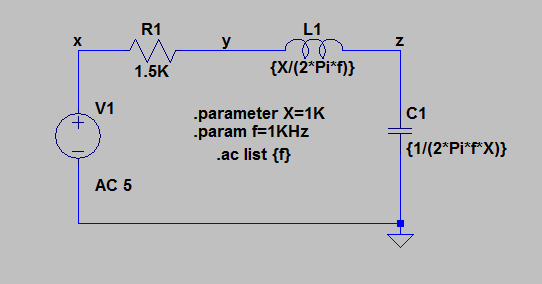

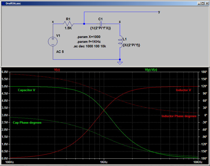

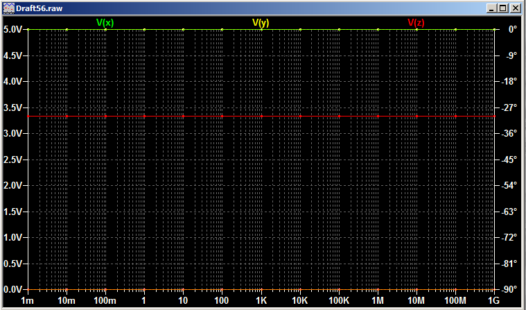

The circuit is intended to demonstrate that at one specific frequency, there exists a value of inductance and capacitance that makes the reactances equal but opposite, leaving only the resistance, which at that one specific frequency, determines the current in the circuit. Look at the following, where X represents the reactance (specifically 1KΩ, but the simulation works for any value). The frequency is f Hz, and the simulation also works for any value:
Here is the result where X=1KΩ and f=1KHz:
Note that (within the computational accuracy of the simulator), V(y) is essentially 0V, meaning that at the resonant frequency, the entire 5V input appears across R1, which makes the current in all four series elements 5V/1.5K = 3.333mA (at a phase angle of zero degrees). Look at node V(z), which has an intermediate voltage, but is in phase quadrature with the input.

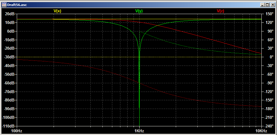

To show that my circuit works for all frequencies, here is a plot of the magnitude and phase of V(x), V(y), and V(z) for all frequencies between 1mHz and 1GHz.
Finally, to refute Colin's stupid, insulting babble, here is the practical use of this circuit: If we vary frequency while keeping the reactances fixed, the output from node y makes the circuit into a highQ, very narrow notch filter. If we take the output from node z, then it makes a low-pass filter. Look at the Bode plot:
btw: This was brought to you by a retired professor of Engineering who learned about ducks long before he started as an electronics technician...
For those of you who might be interested in using LTSpice to do analysis in the frequency domain, I include the .asc file...

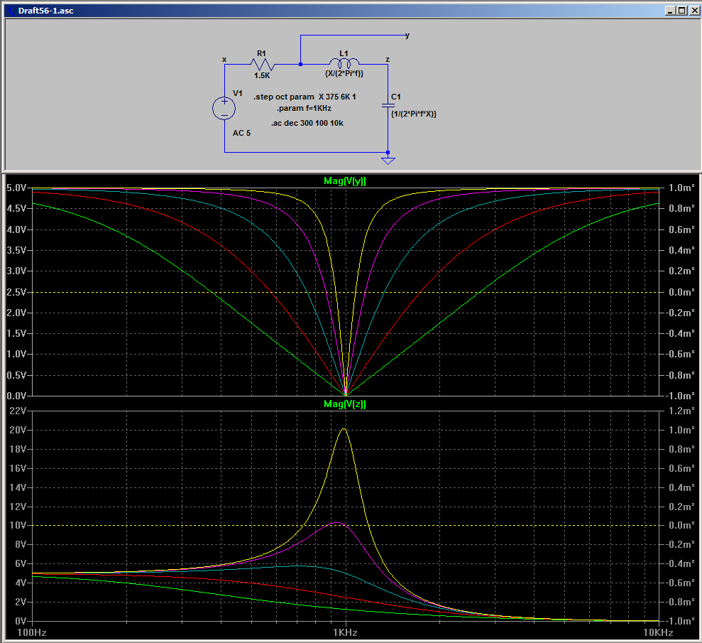

Your point is well made, the circuit is not a practical example of a tuned circuit, but something to provide a theoretical learning experience.
I take issue with "not a practical example". Look what happens to the circuit as we change the Q (ratio of X to R1=1.5KΩ). The plots are for Q = 375/1500 = 0.25 = Green, Q = 750/1500 = 0.5 = Red, Q = 1500/1500 = 1 = Blue, Q = 3000/1500 = 2 = Violet and Q = 6000/1500 = 4 = Yellow.
Who is to say that low Q is not more desirable with respect to ringing and/or transient response than high Q. Both low Q and high Q versions of this circuit could be "better", depending on what the goal is...?

MikeMl: Your reply was really helpful. The frequency of 1000 Hz is a resonant frequency. The magnitude and phase of voltage V(y) is almost negligible. But the magnitude and phase of V(z) is relatively quite large. It should have been ideally zero like V(y). Could you please help me with this? Thank you.

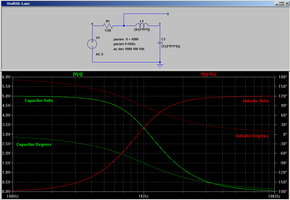

At resonance, the Magnitude of V(z) is a function of the ratio XL/R1 = (2*Pi*f*L)/R1. Note the lower plot in Post #6.
If we set X to 1kΩ (the original problem), sweep frequency from 100Hz to 10kHz, and then plot both Mag(V(z) and Phase(V(z)), here is what we get:
As near as I can read the plot, at 1kHz, the voltage at V(z) is 3.333V at an angle of 90 degrees.
Look at the table you posted. Note that at resonance, the current everywhere in the circuit is 3.333 mA and the reactance of the capacitor (and the inductor) is 1kΩ. By simple application of Ohm, doesn't it follow that the voltage across the capacitor is 3.333V, but lagging the current by 90 degrees?
Do you understand why at much below resonance, V(z) approaches 5V, and much above resonance, it approaches 0V?

V(y) is ~zero. The current is not. Therefore, the SUM of the inductor voltage and the capacitor voltage must be Zero.
I was under the impression that the individual voltage across inductor and capacitor would always be greater than the source voltage. I was wrong. It might be but not always as your example proves.
Depending on Q, the voltage can be either smaller than 5V (the input) or larger.
Using your example from post #5 capacitor is 0.1592 μF and inductor is0.1592 H. Using equation 8 from this pdf: https://mlg.eng.cam.ac.uk/mchutchon/ResonantCircuits.pdf. It gives individual voltage of 3.33 V across inductor and capacitor with 180 degrees phase difference at the resonant frequency. For some reason, the value of V(y) at the resonant frequency given in the table of post #5 seems really inaccurate at least to me. In my opinion, it should be same as V(z) with +90 degrees phase. In the table it is given as 3.333 e^-006 (3.33 x 10^-6) with phase of -2.4622 e^-007 degrees (-2.4622 x 10^-7). Where am I going wrong? Could you please guide me? Thank you.
If the voltage across the inductor is equal but opposite in sign to the voltage across the capacitor (definition of series resonance), then the theoretical voltage at V(y) should be Zero. The simulator calculates 3uV, which with its default convergence settings, is as close as it can get. This is due to how the simulator does its calculations, and also because even its capacitor model has some "leakage resistance", and its inductor model has a bit of "series" resistance...
The following plot may help you visualize what is happening. I plot the vector voltage across the capacitor V(z) Green and add the vector voltage across the inductor as the expression V(y)-V(z) Red. Note that at 1kHz, the voltages are the same, but their phases (relative to V1) are -90 and +90 degrees, respectively. This is what makes the voltage at V(y) very nearly zero...

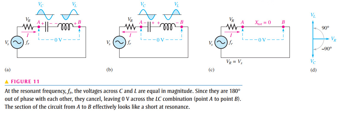

Thank you, MikeMl , MrAl.
I think that I understand it now. The ground and node 'y' are at the same voltage.
I was looking at the picture shown at the beginning of this page: **broken link removed**. It looks like that the polarities shown are misleading; at least this is how it looks to me but I might be wrong. I have redrawn it. Please let me know if it's correct. Thank you.

Two points can be made here.
First, your interpretation of the polarity is a little flawed although you could do it that way. The main point to be made though is that the ASSUMED polarity does not have to agree with the actual MEASURED polarity. When we assume a polarity at the beginning of a problem it can be virtually anything. You are assuming that the inductor voltage is (graphically) - + while they assume + -. That means if we call the inductor voltage vL then your voltage for one circuit condition might come out to:
vL=+2.65v
while theirs would come out to:
vL=-2.65v
They are both right though because of the assumed direction at the start of the analysis.

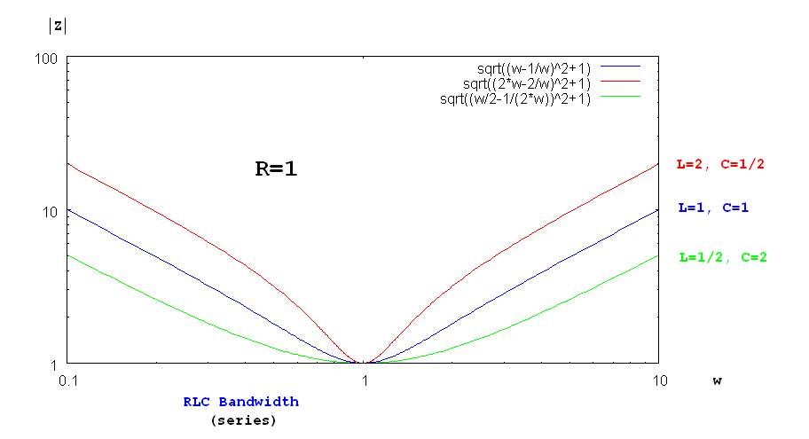

The second point to be made is that it was good that they had shown the sharpness as R is varied, but the more important graph would be to see how the sharpness changes as L and C are varied. That's because the load is usually constant. In the bigger picture though it is good to see both.
Attached are two pics with three graphs. One is for the series circuit alone when L and C are varied. The other has two graphs where L and C are varied and has one hand drawn plot for the series circuit and one hand drawn plot for the parallel circuit. The series circuit in that plot is approximate but is still representative of the way the response gets sharper or wider in bandwidth as L and C are varied. That paper is from my notes from a long long time ago :)
Note that in all of my plots the plot is |Z| vs w not current vs w, which is a little different but if you want the current then just think about what it might be with the given impedance. It is max when |Z| is min and lower everywhere else.
It might also be interesting to note that the curve is symmetrical in log coordinates so when w=0.1 we get the same |Z| response as when w=10.

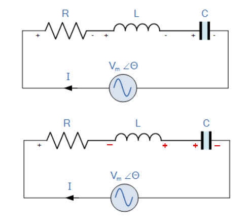

How is it so? I was thinking more in terms of this picture where capacitor in connected in the middle rather than an inductor. Thank you.

Just a point of clarification about how LTSpice (and I) report voltage at a node: V(x) means the "voltage at node x with respect to Gnd" (the gnd symbol)
V(x,y) or the expression V(x)-V(y) means "the difference in voltage between node x and node y".

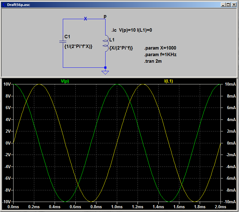

A lossless parallel resonant circuit has only two nodes, in my example node p and ground (gnd symbol). You can only talk about the voltage at V(p) because by definition V(gnd) = 0.
Imagine that we initially cut the wire at X, and we pre-charge the capacitor C1 to 10V. There is initially zero current in the inductor L1, and then, at time = 0, we connect the wires at X.
Here is what plays out as a function of time...
This shows how the energy initially stored in the capacitor transfers to the inductor, and then back again... Since this is a lossless circuit, this would theoretically go on forever. Note that there is no voltage source other than what is implied by "precharging" the capacitor...
There is only one voltage to display. The energy exchange is shown by the quadrature relationship between the voltage V(p) and the current I(L1). Note that this is a series circuit, so I(L1) = - I(C1).
Why is the peak current 10mA?
I forgot to say, this circuit is the electrical analog of a pendulum, where potential energy transitions to kinetic energy and back again...
