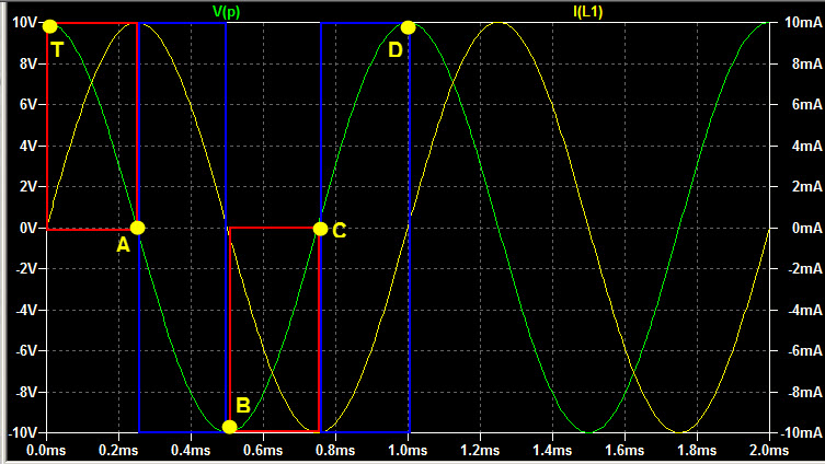

Please have a look on the attachment.
Point A: The capacitor has fully discharged. The inductor takes over and keep pushing the current in the same direction.
Point B: The magnetic field of indcutor has fully vanished and hence no more stored energy. The capacitor starts pushing the current in the other direction.
Point C: The capacitor has fully discharged and the inductor takes over and keeps the current flowing in the same direction.
Point D: The inductor has fully discharged and at this point the capacitor takes over.
The energy exchange takes place four time in a single cycle; therefore it was really "half cycle". Please let me know if I'm wrong. Thank you.

I would just say that the capacitor and inductor exchange their energy twice per cycle. Added a plot of 1/2CV^2 and 1/2LI^2 to the previous plot...
peaks at 7.95uJ
Thank you but sorry I'm having difficulty understanding it. I still think that energy is exchanged four time each cycle between inductor and capacitor.
rlc_111_2-jpg.109068
Between point T and A: The capacitor delivers its energy to inductor.
Between point A and B: The inductor delivers its energy to the capacitor.
Between point B and C: The capacitor delivers its energy to the inductor.
Between point C and D : The inductor delivers its energy back to the capacitor.
Could you please guide me where I'm going wrong with it? Is it just a difference of viewpoint? Thank you.

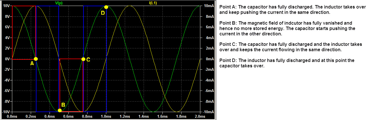

That's not what appears to be happening. If you look at Mike's plot you see the EXCHANGE happen just two times for one cycle, and if you look at the mathematical derivation you see the "2*t" instead of just "t" in the cos() expression which says that there is something happening twice as often not four times as often.
It's not a matter of following the peaks, it's a matter of following the entire exchanges. For one cycle, the cap has max energy just twice so the exchange can only be twice per cycle. The total energy is handed to the inductor twice per cycle, and is handed to the cap twice per cycle. That does not add up to four times.
If at t=1 second i give you an apple, then at t=2 seconds you give it back to me, that's ONE exchange of the apple not two.

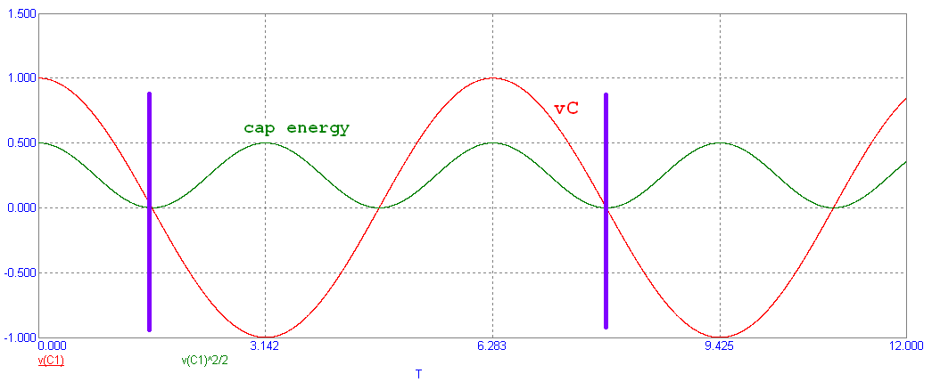

Well if we wanted to we could say that the cap and inductor change energy an infinite number of times because at say t=1us the C had some energy and the L has some other energy level, then at t=2us the cap gives a little more to the inductor, then at t=3us the cap gives still more to the inductor etc., etc., but that's not a total exchange. A total exchange means that at some point the cap has all the energy and at another point in time the inductor has all the energy. That's a total exchange, and that happens exactly two times per electrical cycle.
If i wanted to make up my own definitions i could say that the sun rises twice per day and sets twice per day :)
Now that might fly, but i'd have to have some proof and show how we could get away with that viewpoint, otherwise i would be the only person who thinks that is true.
You might show an example where your view makes sense if you like.
Thank you, MrAl.
I'd refer back to my post #31.
How much energy does the capacitor have at point "A"? And how much energy does the inductor have at point "B"? Thanks a lot.
Your point A is at 0.25ms; B is at 0.5ms.
The energy in the inductor is (LI^2)/2, the energy in the capacitor is (CV^2)/2

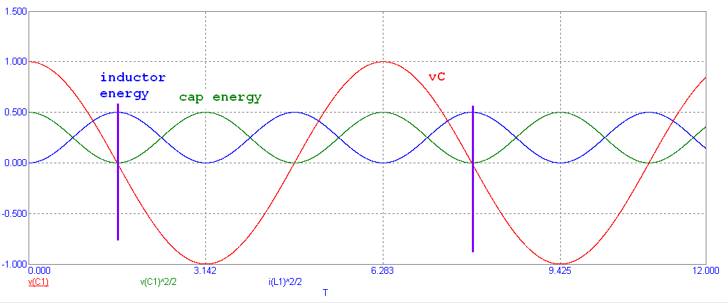

In the plot in post #30, the blue trace is the inductor energy, and it peaks at 0.25ms(A) and 0.75ms. It peaks at 7.95uA^2= 7.95uJ.
In the plot in post #30, the red trace is the capacitor energy, and it peaks at 0ms, 0.5ms(B) and 1ms. It peaks at 7.95uV^2=7.95uJ.

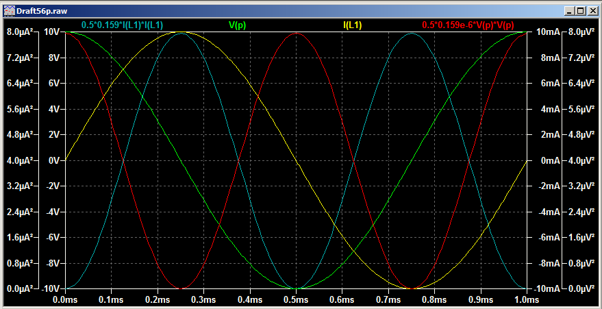

Yes i saw that. That shows voltages and currents not the energy itself. These next two diagrams show the energy itself over one cycle between the violet 'bars'. You need to look at the energy itself to know how many times it is completely exchanged in one cycle. The violet bars enclose one cycle only.
Note in the first diagram _1 the cap has maximum energy exactly two times in that one enclosed cycle. That's not four times.
vC is the capacitor voltage to use as a reference as that shows the oscillation cycle.
Note that a complete "exchange" is not the same as simply counting the peaks of each energy cycle. Just because there are four peaks total that does not mean that they exchanged energy four times. An exchange is a view of two things at once not just one thing at a time. This is why i show the cap energy ONLY in the first pic, so you can see that it only has max energy twice per cycle more clearly. The cap has all the energy twice and the inductor has all the energy twice, and that is an exchange of two times not four times.

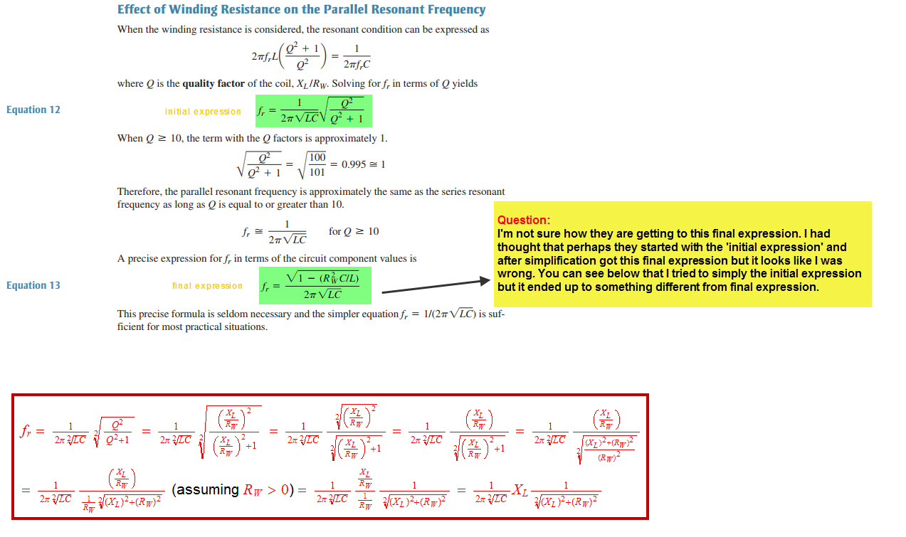

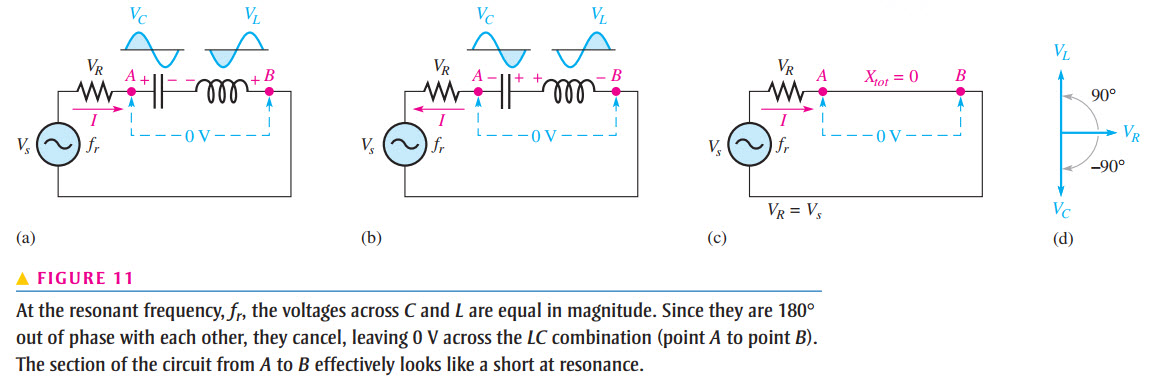

Could you please help me with the question below?
Please have a look on the attachment. I'm not sure how they are getting to this final expression. I had thought that perhaps they started with the 'initial expression' and after simplification got this final expression but it looks like I was wrong. You can see below that I tried to simplifyy the initial expression but it ended up to something different from final expression. Thank you!
Note to self:
Q (the “quality factor”), is a measure of how much energy is not lost in a reactive element. The higher the Q, the less energy is lost. Quality factor exist for inductor as well as capacitor. Q_C=Xc/Rc=1/(2*pi*f*C*Rc) and Q_L=X_L/R_w=2*pi*f*L/Rw where Xc=1/(2*pi*f*C) is capacitive reactance, Rc is equivalent series capacitor resistance, X_L=2*pi*f*L and Rw is equivalent series winding resistance. When the resistance is just the winding resistance of the coil, the circuit Q and the coil Q are the same.

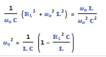

Your attempt to derive the resonant frequency with resistance present in the coil tells me that you do not quite understand the principle of parallel resonance (PR). Unlike series resonance, PR depends on the different amplitudes and phases of the currents in the branches. Lets start out with the admittance of the coil with resistance and capacitor without resistance in parallel.
To achieve resonance, the orthogonal term designated by "j" must be zero.
Substituting into the above equation the formula for reactance.
And, we get the formula you are seeking.
If resistance is allowed in the capacitor branch, then it is possible for the circuit to be resonant at all frequencies by adjusting the two resistances.
