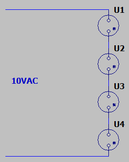

I have a 10vac output adapter that I would like to reduce to 2.5 or 3vac to test Christmas lights.

You could power 3 or 4 light bulbs from the 10vac adapter. 3.3V or 2.5V per bulb.
Make a short strand of 4 bulbs. Then replace one bulb with the bulb to test.
All bulbs bust be of the same type.

The current is 170mA
Wattage is .42/bulb
2.5vac
I just want to see if the bulbs light.
I can see a short across the filament but the bulb won't light in the socket string.

Thanks Chris, a 3vdc button cell works.
I had already tried that on the lights I was testing and it wasn't working but when testing a new bulb it does work.
The short I'm testing is likely the shunt in the bulb.
I have a light keeper pro that I'll dig out and see if the shunts are causing the problem.
Some light strips have bulbs that short when they fail, so your lights dont go out, such strings have a fuse lamp for safety.
