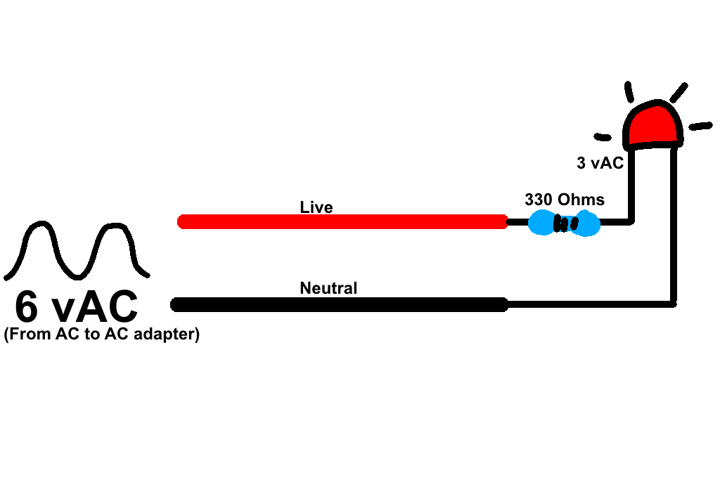

I need to convert 3vDC to 3vAC (EXTREMELY IMPORTANT!: KEEP THE SAME VOLTAGE BUT AC) but, is there any way to convert it WITHOUT a transformer? (If it contains capacitors: can my 16 volt capacitors work on 3vAC?

Why doesn’t the led flicker normally... or does it? The led is polarized but it doesn’t stop when the AC reverses.

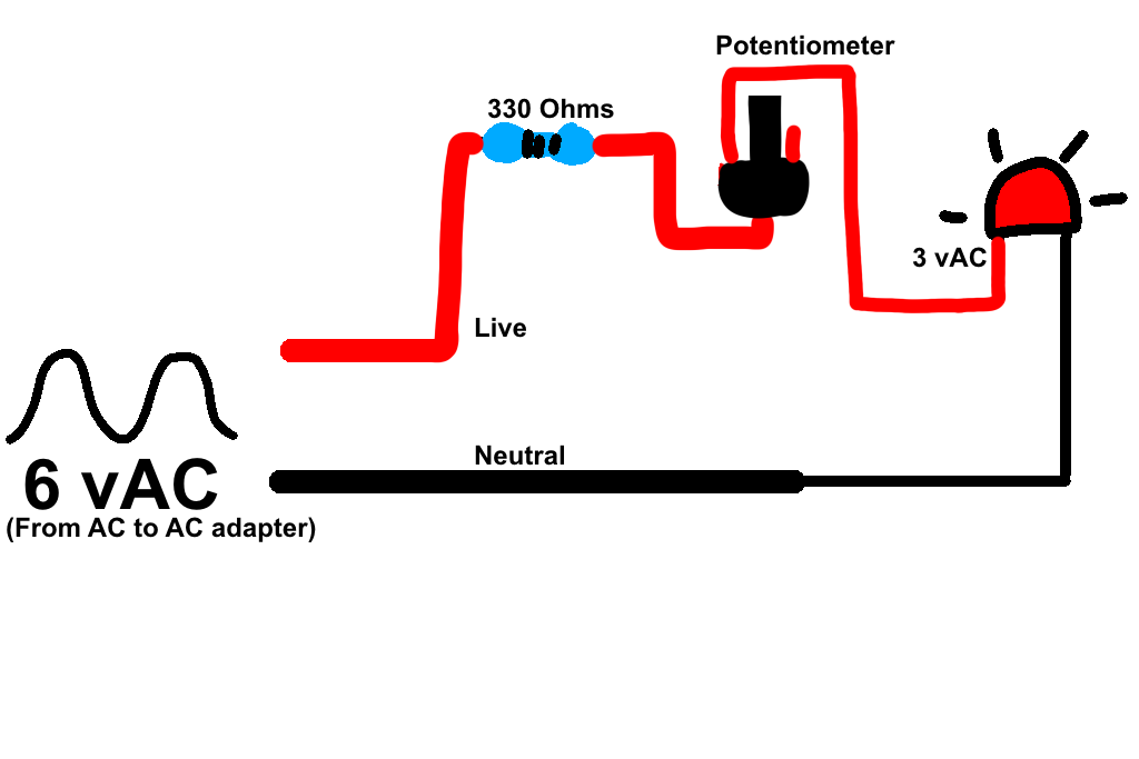

Post a diagram of exactly how it's all connected.
This is a poorly made diagram of how it is connected.
In post #19 you mentioned a potentiometer - where's that?. You also shouldn't feed AC to an LED as you can destroy it, unless you have another LED (or diode) reverse connected across it - and of course there's no live or neutral.
