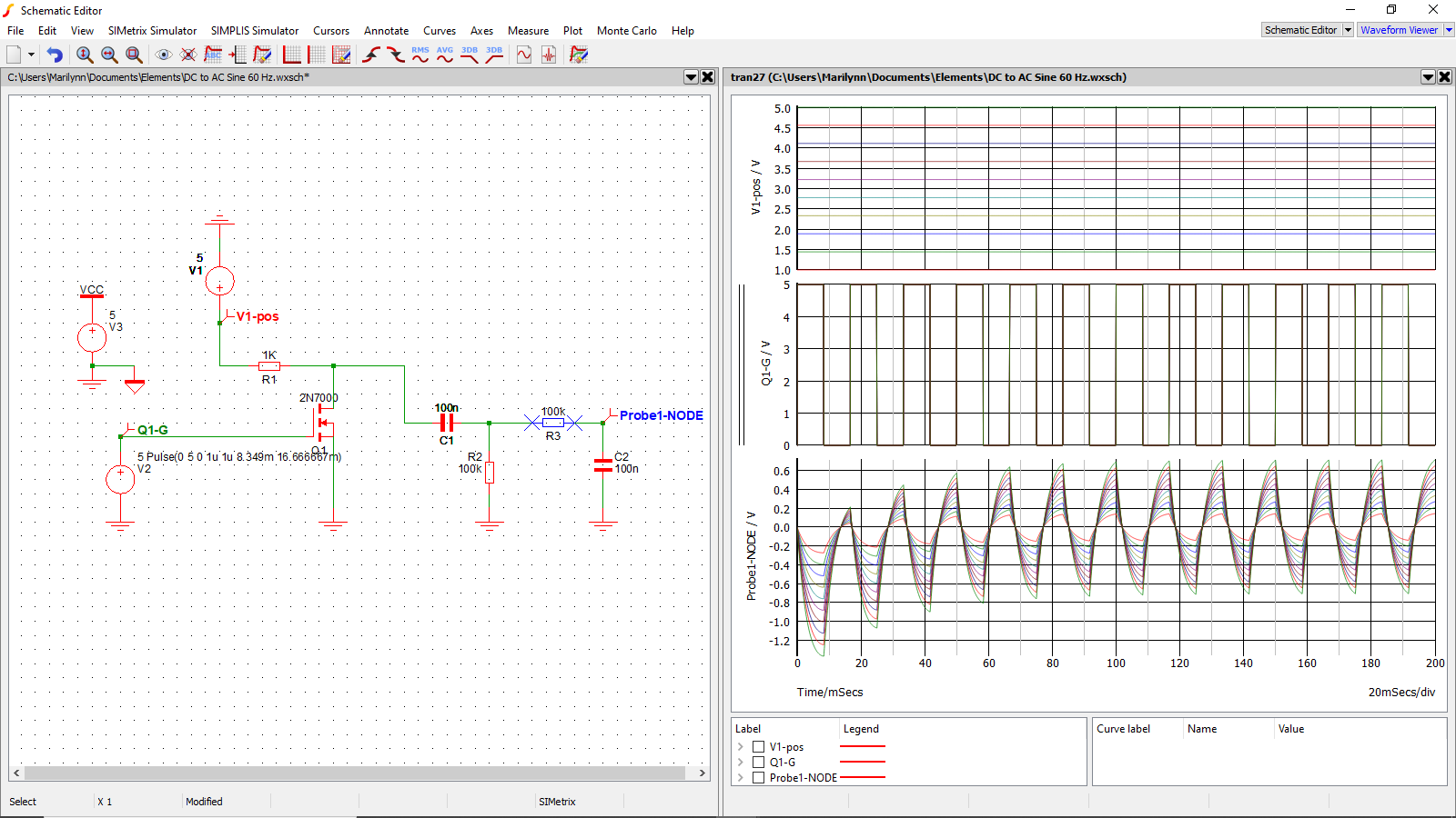

Here is a basic approach. Essentially chop the DC signal at 60 hz
rate, followed by a BPF or LPF to extract sinusoid.
Shown is a simple BPF, might get better sine by use=ing Twin T Notch
or use OpAmp, Sallen Key as filter.
The waveforms show were a sweep of the DC value from 1 to 5V,
so if you wanted output pk-pk to match DC then the filter could be designed
with appropriate G to yield that for OpAmp solution.
Of course there is a lot of latency associated with this as you can see. To eliminate
that a multiplier solution as discussed in post #7 fixes that issue.
So V2 chops the DC with the 2N7000, you need a 60 Hz source, V1 is DC source of interest, ignore V3, it
was used when I was using a CMOS mux part in lieu of 2N7000.
Regards, Dana.
Using a Sallen Key filter (maybe should try MFB as well) -
So in short you could use a dual opamp, one for creating 60Hz oscillator, the other for the filter,
and have a solution.
Regards, Dana.

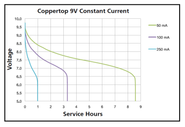

9V battery discharge life at 1A output (point of this is not very long) :
Regards, Dana.
