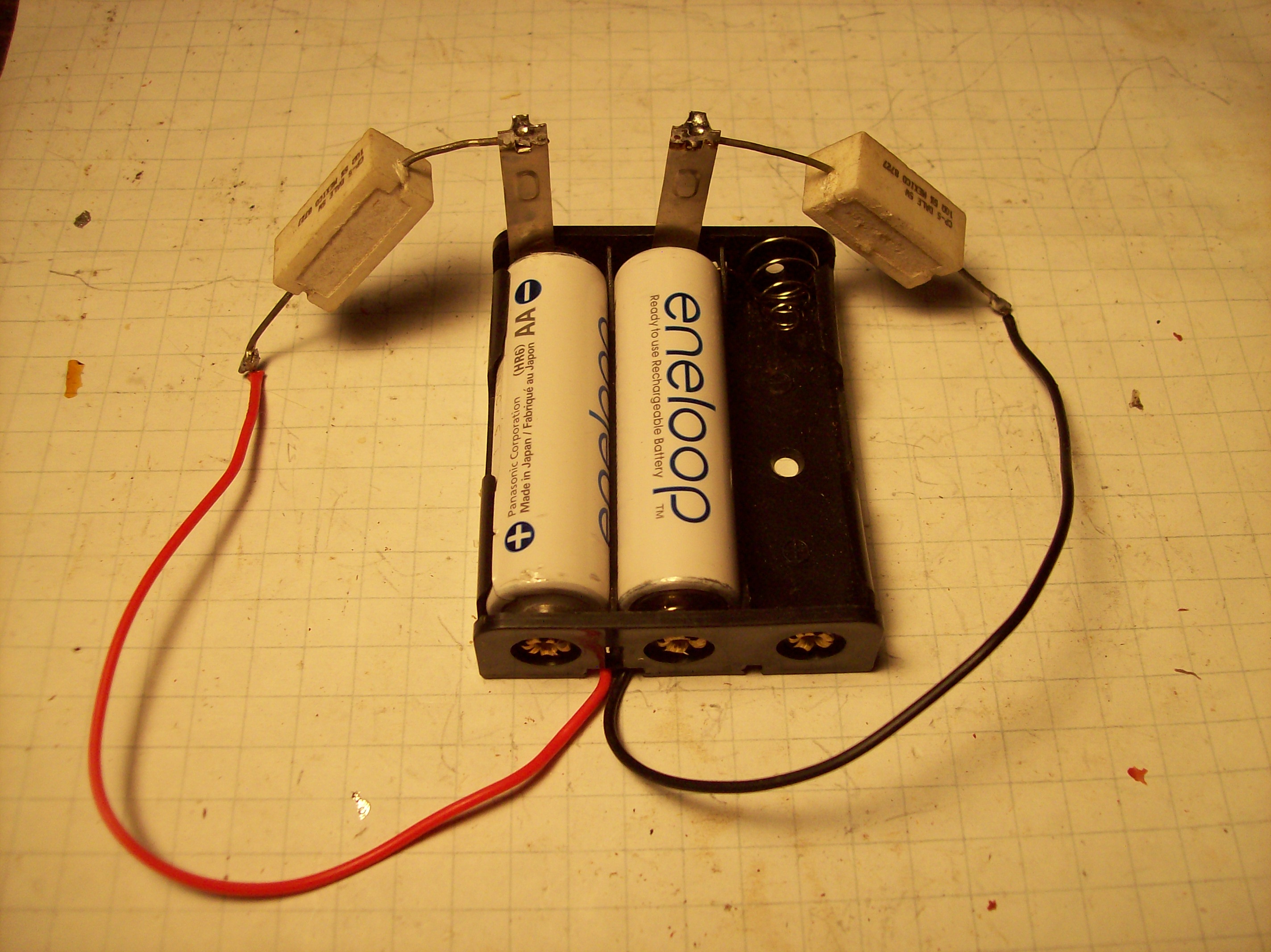

Batteries were resting on the desk for 2 hours now voltage has dropped to 1.406 & 1.391
Next time dead batteries need to be charged it looks like they should be charged 14 or 15 hrs that should put final charge closer to 1.5v.
Now I need a 15 hr off timer.
2 hrs later batteries on the decharger are .282v
Youve killed them. Discharged them too much. They wont recover.

Batteries did recover and took a very good charge. I put batteries in my camera an took several pictures already. Battery life indicator on camera still shows full charge. Battery indicator is a good indication batteries are better than before after about 40 pictures indicator use to start showing 95% battery. Battery still shows full. I am going to take more pictures today just to put a drain on batteries to see how they do. Already I can see batteries are better than they were.
Since you are using a cheap charger that does not detect a full charge then shutoff, then it was overcharging the batteries which is bad for Ni-MH cells. Now that you are discharging the batteries completely then charging with your own 14 hours timer, the batteries are working better.

The lower the battery voltage drops then the lower is the discharge current and the resulting longer time for a complete discharge.
If you try to discharge more than one cell in series then the weakest one becomes completely discharged then the stronger cell discharges more by charging the weak cell in reverse, which is bad for it. Therefore do not discharge series cells below about 1V fore each cell.

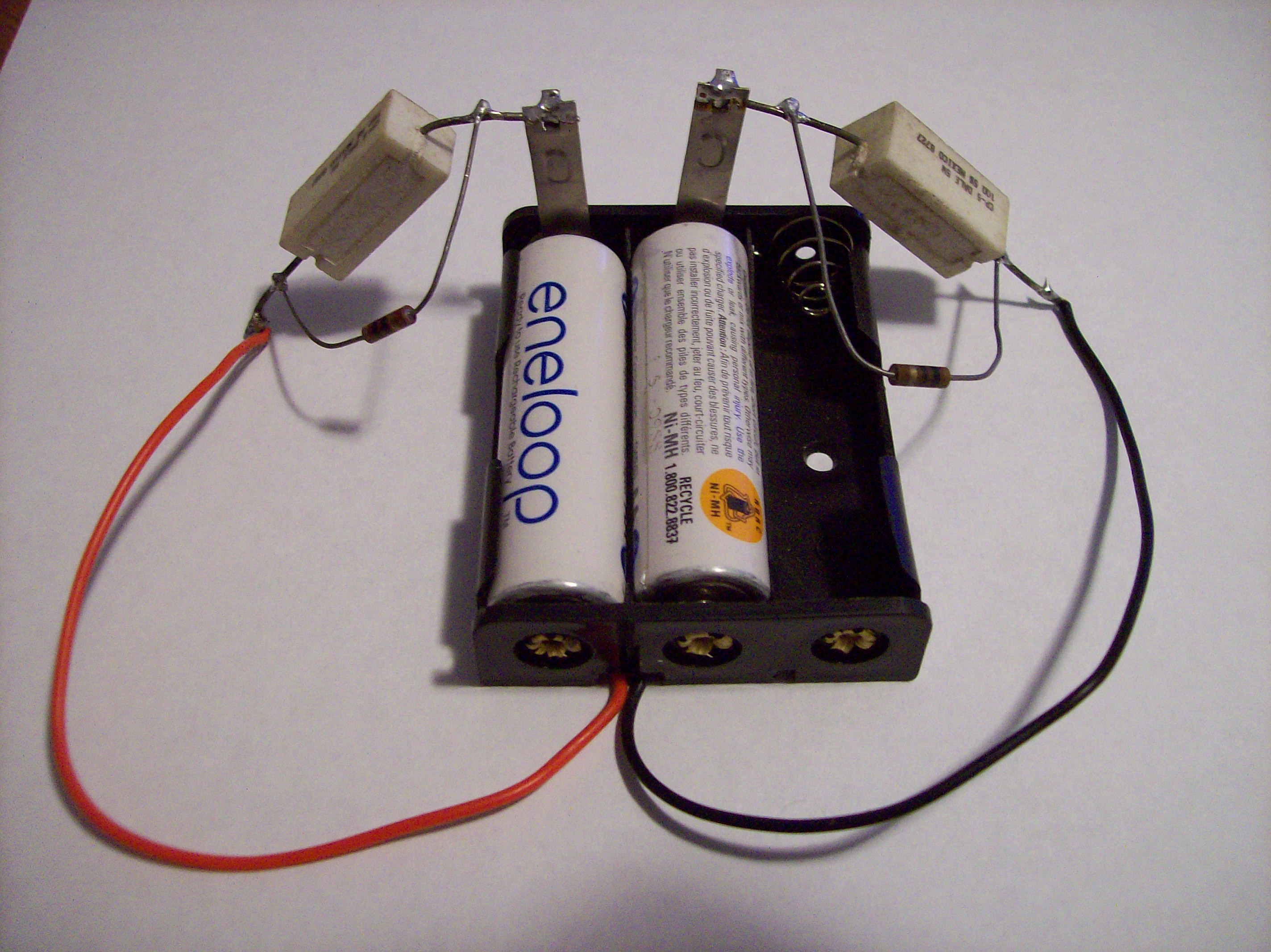

Battery voltage after 53 hrs of discharging = .039v
Maybe it is time to lower the resistance from 100 ohms to about 10 ohms.
118218
Today voltage on each battery is .001v
I soldered a 10 ohm resistor in parallel with the 100 ohm resistor. Tomorrow I solder switch in series with 10 ohm resistor after battery discharges 3 days on 100 ohms then I change to 10 ohms. Maybe 10 ohms is too small maybe 25 ohm is better.

You are getting carried away...
All that matters is the open-circuit voltage after some time to recover is somewhat below 1V. At that, there is no significant charge left.
It probably won't hurt, but do charge the cells after you have finished, don't leave them in the totally discharged state for more than a few days.
