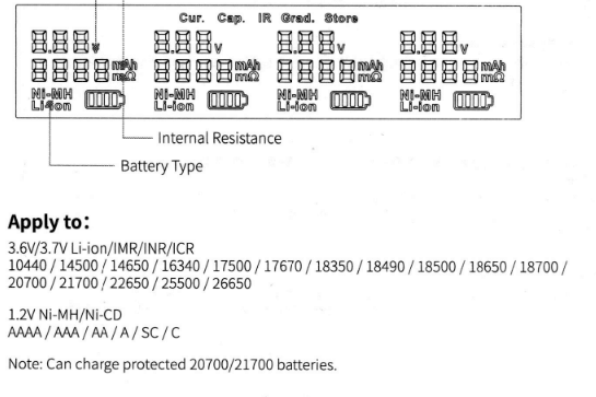

I have a lot of 18650 batteries out of makita batteries i need testing because the makita charger doesnt like them, need to test if the cells are dead because most will charge up individually using a cheaper device and read around 4 volts each but when together the makita charger said its bad. I do know if one goes down the whole 18v battery wont work
The best device I know of is an Opus BT-C3100
They can charge, discharge or test up to four cells at a time. I use mine regularly for testing salvaged 18650 cells.
Do either tell you if battery is useless?
The Xtar VC8 one I have tells you the cells measured capacity (grad setting), so you can easily tell if it's good or not - it will also tell you if a battery is completely useless. I've just used it the last few days to test cells from some failed battery packs - all but three checked slightly above their rated capacity, the three faulty ones all failed the initial part of the testing.
