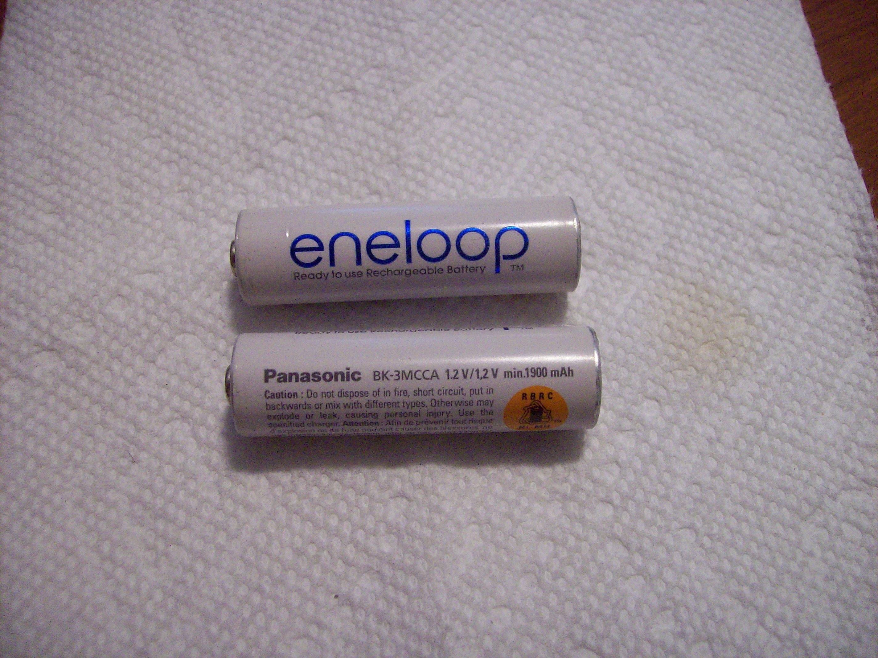

I think it was 2 years ago I ask, which rechargeable battery is best, I am having trouble finding good batteries. I was told, buy enelope so I did.
Batteries have been working good until now. I use 2 AA batteries in the digital camera an 2 in the electric tooth brush. Camera batteries need to be charged about every 2 weeks. Tooth brush needs to be charged every 4 months. I always let batteries go dead before recharging.
I use to be able to take 500 pictures and several videos with the camera batteries for 2 weeks but now batteries go dead in 10 minutes.
Electric tooth brush holds a charge for 4 months before needing to be recharged.
I had to swap batteries from tooth brush to camera so I can use the camera.
Battery charger is Rayvac PS13 2.8vdc 160ma.
AA Batteries are 1.2v 1900 mAh
Question. Is it typical that batteries that get used the most go bad first?
They do all have a limited number of cycles.
Also, although NiMH are often claimed to have no memory effect, they still do in my experience.
That is, if they are not usually completely discharged, the crystal structure of the plates changes in the parts that are never used and the internal resistance goes up when you get to the "normal" discharge point.
With something that needs high current like a camera, that can cause it to indicate the batteries are flat.
Try connected eg. a ten ohm resistor across each cell and leave them for about a week, then fully charge them and try them again.
I've found that frequently brings them back to life, by discharging them past the high resistance point so the full depth of the plates gets reformed on the next charge.
(And you can ignore the usual rule of not discharging below 1V/Cell. That applies to cells in a pack, to avoid reverse polarising any weak ones.
By discharging each cell separately, that cannot happen).
Your Rayvac charger is probably a poorly designed Chinese copy of a real Rayovac one. The Rayovac charger is cheap junk. I have one (model PS13) that I found in the trash. It does not detect a full charge then shutoff so it keeps over-charging which is a death sentence for Ni-MH cells. My over-charging cells become fairly warm. Note that its 160mA charging current will fully charge your 1900mAh Eneloop cells in 12 hours but maybe you are charging for only 7 or 8 hours, then they are never fully charged.
The Japanese Eneloop cells hold their charge for 1 year so American Energizer and Duracell for the last 5 years buy then sell the Japanese ones.
I have a Duracell charger that charges correctly. It charges two AA Ni-MH cells at 1550mA or four cells at 775mA, detects full charge then shuts off with a green light.
yes, it is typical for batteries used the most to fail more often. a rechargeable battery works by undergoing a chemical reaction when charging, and that reaction being reversed when it discharges. the electrodes in the battery are made of metal that undergo redox (reduction-oxidation) reactions where the metal forms a compound during the oxidation portion of the cycle, and plates back out during the reduction portion of the cycle. the problem is, that when the metal plates out, not all of it precipitates on the electrode. the result is that there are metal particles suspended in the electrolyte, and they are nonrecoverable. it is the amount of metal on the electrode that directly impacts the battery capacity. a side effect of this is some of the suspended particles of metal can eventually string together and form a short circuit between the electrodes (some electrode metals also tend to grow "whiskers" which are crystals of the metal).
Make sure you have a good charger, that shuts down when it the battery is charged, as AG noted.
Overcharging will significantly shorten the life of a NiMh cell much more than the old NiCDs, which were more tolerant of overcharging..

Try to count the number of times you recharged, that is equal to 1 cycle if you drain them most of the way down before recharging.
The count is somewhere between 1000 and 2000 cycles.
Two years has 365 days times 2 which is 730 days. If you charged them once per day they should still be good. If you charged them two times a day it may be getting time to get new ones.
None of the cells last forever. The newer Eneloops are supposed to go for more cycles.
