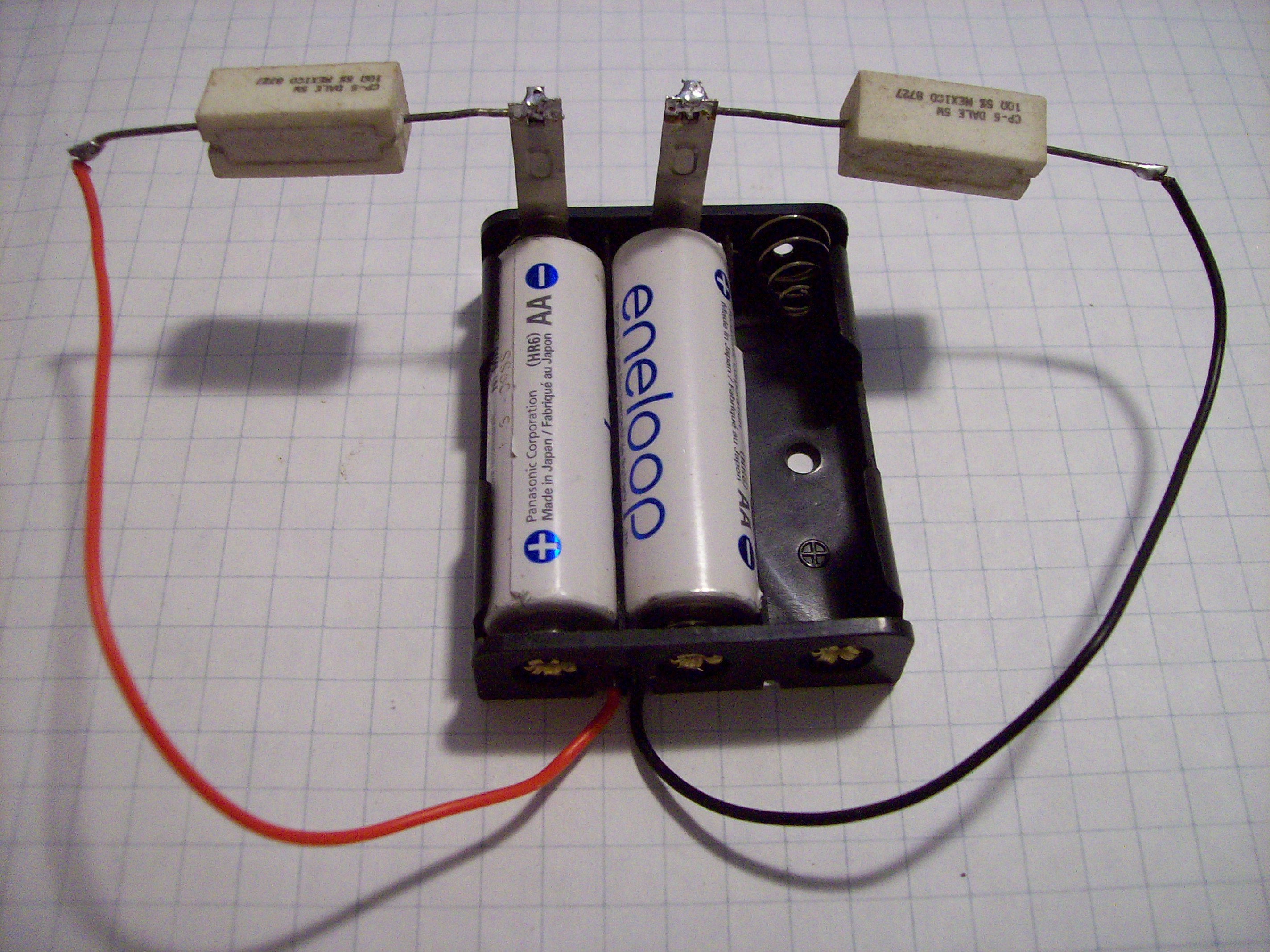

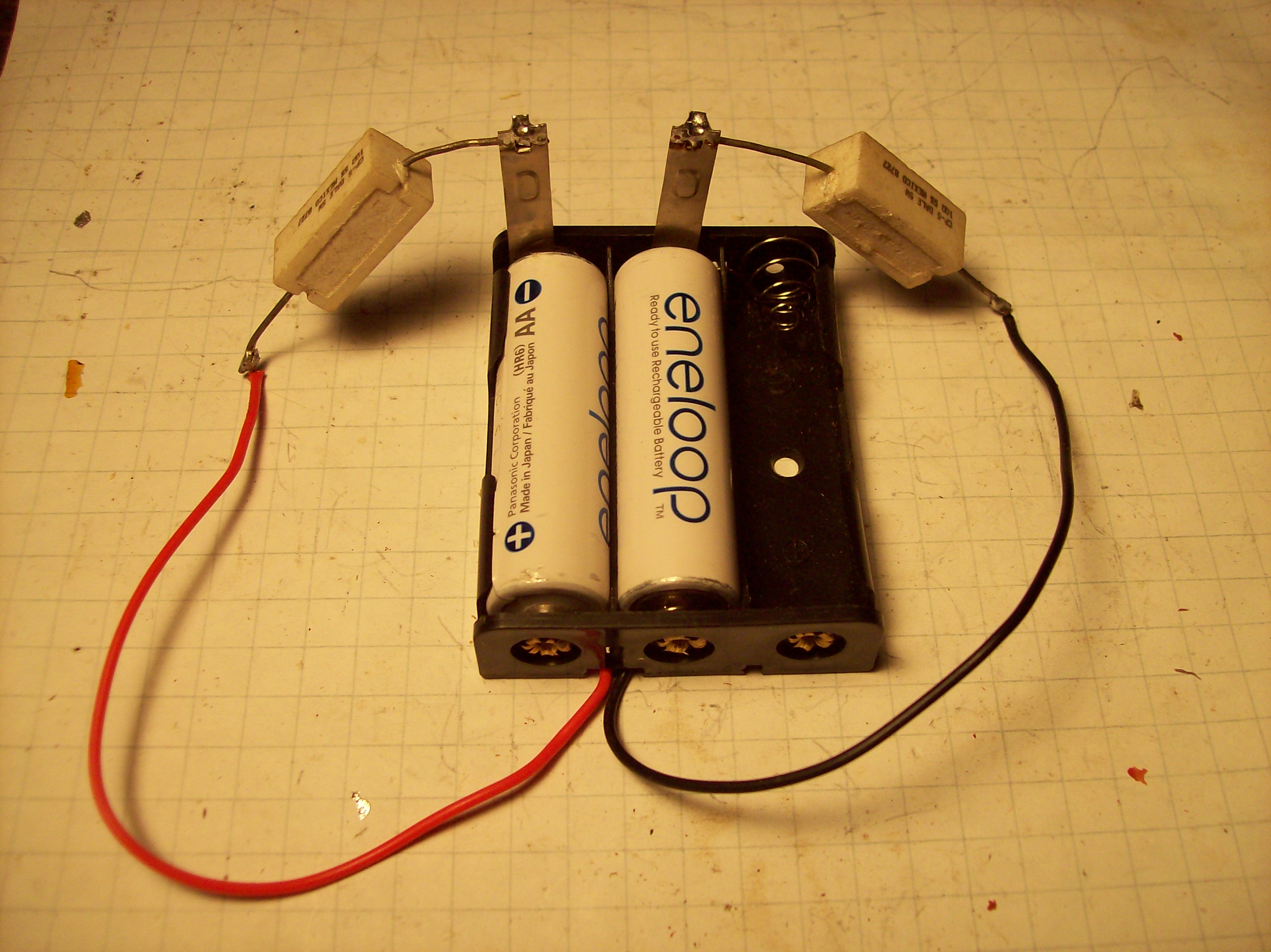

I don't have battery holder for 1 batteries so I put 2 batteries in a 3 battery holder with jumper between the to batteries. I connected two 10 ohm resistors in series 5w each with 2 batteries in series. Will this work? I hope this is safe & not start a fire on my deck while we are asleep or gone?
At first batteries got warm. 30 minutes later batteries are cold. Wires not warm. Resistors not warm.
Each battery cell will be about 1.4V when fully charged. Then Ohm's Law says the current in the total of 20 ohms is 2.8V/20 ohms= 140mA which is fairly low for AA cells. Each resistor heats with only 1.4V x 140mA= 0.2W.
You can safely use two or three cells and one 10 ohms resistor to discharge quicker.

It is rather important to do one cell at a time, so there is no possibility of a cell in a series combination being reverse-polarised.
The point is to take them down to zero volts and any imbalance between series cells could cause a weak one to be reverse charged while a stronger one is still discharging.
Check the open-circuit cell voltage with a multimeter after giving the cell some time to recover from a full discharge. It should be 1V or less.
If not, give it more time discharging - it can possibly take several days overall.
With ten ohms per cell, the maximum discharge current should be somewhat under 150mA and that should not be anywhere near enough to make the cells heat up, or at least not significantly?

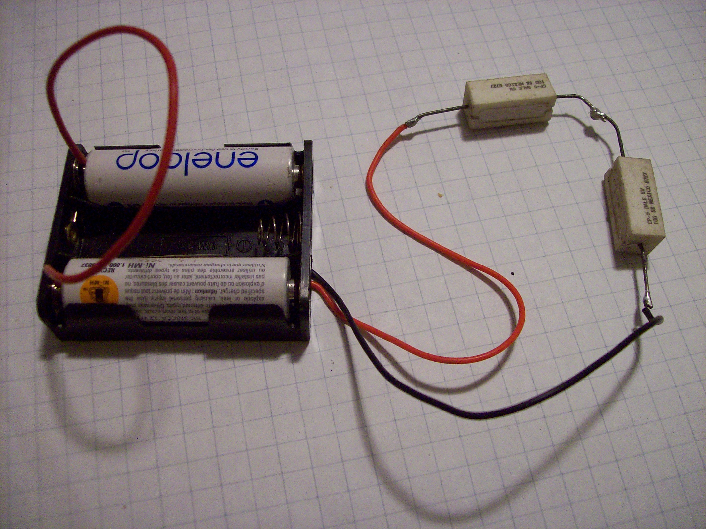

Now each battery has a 10 ohm resistor. OK so I leave batteries like this for 1 week then recharge the batteries.
That should work!
See how they work in the camera again, after that process and then fully charging them?

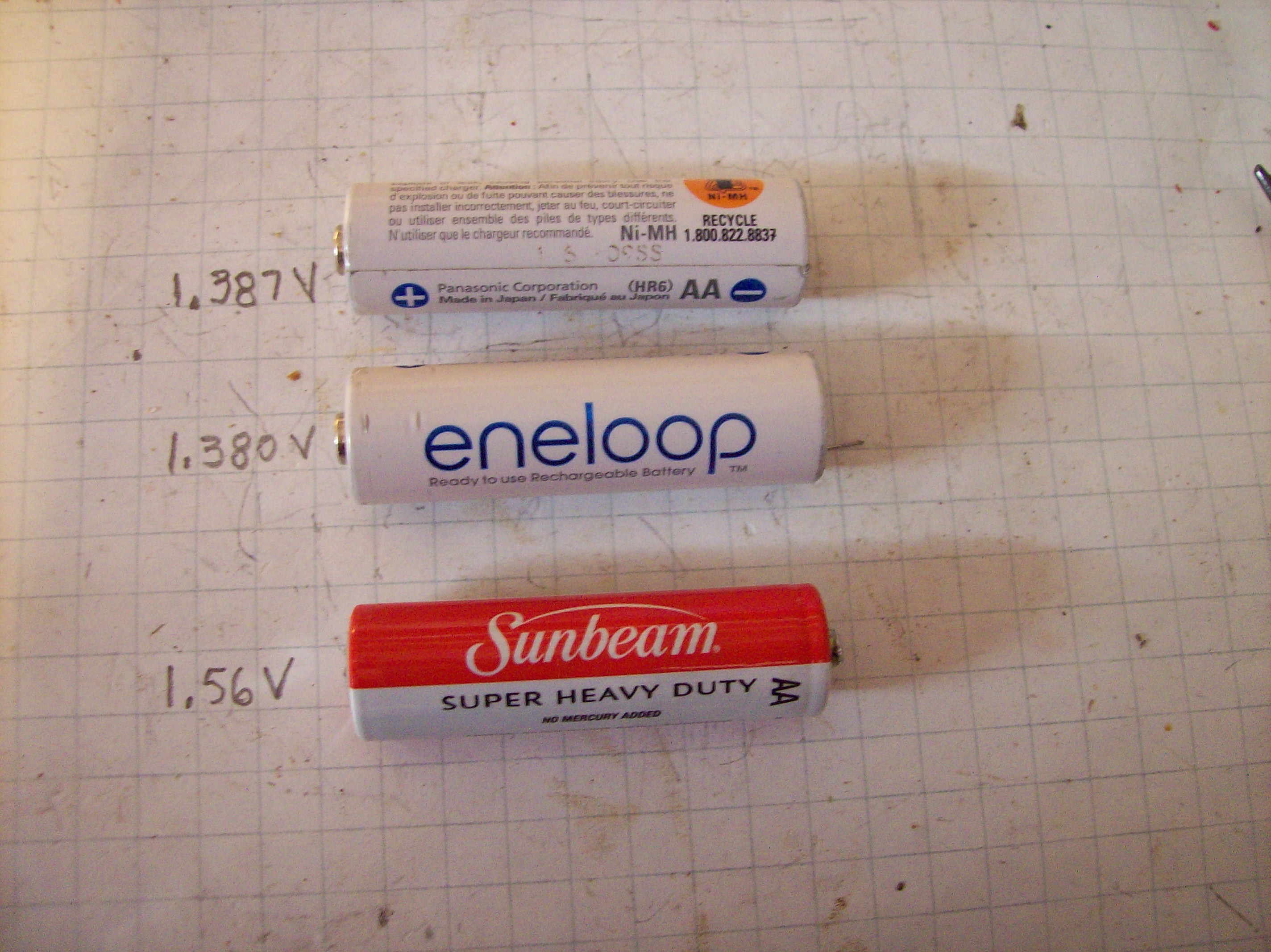

Someone said, a fully charged battery will test 1.2v. I tested my 12 hr charge batteries they are 1.380v & 1.387v and test 7.68 amps I assume that voltage means they need to charge a bit longer. I will charge them 1 hr more then test them again. Then charge them another 1 hr an test them again. I want to see if voltage keeps going down to 1.2v & maybe amps go up.
I tested the 2 eneloop batteries that have been on discharge for 12 hrs they test .680v. I will leave them on discharge an test them every day for a week. Is it ok to change 100 ohm resistor to 50 ohms to speed up the discharge and not damage batteries?
The red dollar store battery is 1.56v brand new 2 amps. Camera will take about 10 pictures with these batteries.
If that is after the resistor has been disconnected and they have had an hour or two to recover, it should be OK.
If it's with the resistor still connected, they need more time.
Lower resistance is fine; you should be OK down as far as ten ohms, it's still only a fraction of the current the cells should be capable of.
After charging battery 90 more minutes voltage on the 2 charged batteries is up to 1.425v and are down to 7.44a.
My Duracell charger charges each cell to 1.5V for a fast charge and to 1.43V for a slower charge, then the voltage drops a little after sitting for a few hours. Just now I measured 10 cells that were fully charged about 1 week ago. They measure from 1.355V to 1.399V with no load. Two cells are 5 years old and were used hundreds of times. Their voltage is the same as the newer ones but their charge runs down sooner.

2 hrs later batteries on the decharger are .282v
