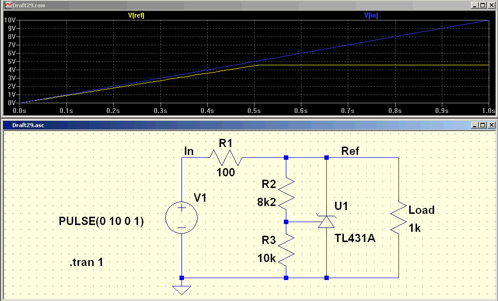

Here's an example to show the use of a TL431. R2 and R3 set the voltage V(ref) you want. They form a voltage divider such that the control input of the IC is 2.5V. The graphs show how V(ref) varies as the supply voltage goes from 0 to 10V.
Thanks a lot for the reply. Since the output will be connected to a 1Kohms potentiometer, is there the need to use R1? The datasheet states that R1 is used to set a current of 1mA or higher to the cathode of the component.
Yes, it's absolutely 100% VITAL - it's a shunt regulator, without a current limiting circuit (in this case the resistor) it will instantly destroy itself. You need to chose the resistor based on the supply voltage, the reference voltage you're looking for, the load current, and the current through the device (should be a minimum of 5 times the load current).
