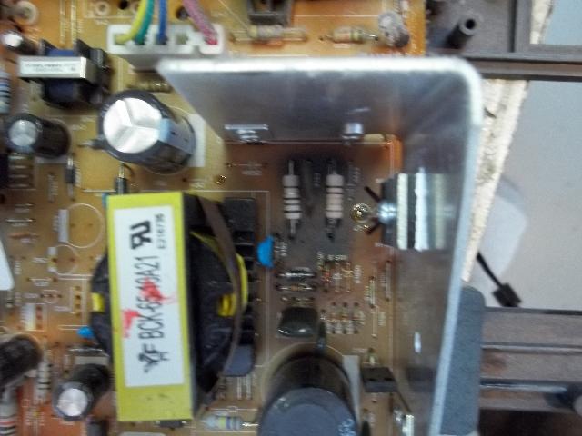

The one time, my son left it on and this is what happened. The TV contains only one board. I looked at the board and it is black in the power supply area. Some components have been burned. If a new fuse is installed, it just blows immediately. I have uploaded a photo of the damaged area of the board.
I am wondering what I can do about this, any advice?

Looks like the high voltage section, although those resistors could have been hot during the normal run of the TV so that may not be the problem area, although HV sections do go like that.
Most newer TV's have a protection circuit that shuts the unit down if there is a problem like blown HV transistor. You problem could be as simple as a blown diode in the input bridge rectifier, that would blow the fuse. If you know anything about TV's you can check the diodes, but you have to be careful in case the HV section is charged you'll get a very bad shock that could actually be deadly.
You can also check by using a light bulb like maybe 50 watts (depending on the size of the TV) in series with the TV power line to try to run it up slowly, but you should check the diodes first. Some TVs wont run up this way but it might. Before you change the diode the TV wont run up and the bulb would start to light up, but after you change the diode the TV would run up and the bulb wont light (if it's a diode or two of course).

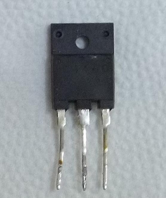

Both of the resistors were shorted, checking with an ohmmeter. I removed both resistors and the capacitor.
I also removed another regulator type device. I think it is shorted because all three pins are shorted when testing with an ohm meter.
I checked the diodes nearby, they all appear to be ok.
Here is a picture of the regulator type device. I don't know what this is, or even where to get one. I figure I should try and replace the components nearby. The markings on the device are:

Hi again,
The package itself looks like either a transistor, regulator, FET, MOSFET, or even a dual diode or other.
How did you figure out it was a regulator?
Are you sure those resistors are shorted, or could they just be a very low value like 0.1 ohms? I ask because it's a little rare to find shorted resistors. Also possible is something in parallel with them is shorted.
Unfortunately i dont recognize that part number, maybe someone else here does.

Measuring the resistors shows a dead short on both of them, they are not low ohm resistors.

Those resistors could possibly be 5 band where silver could be a multipler. Sometimes there are three significant digits and a multipler. Metal oxide resistors usually don't short.
That part is a NPN switching transistor (2SC4450). Here's the datasheet. (The Datasheet Catalog is your friend when you need to find such information.
My apologies, I now see that the part number is C4460. It was very hard to read, even with a magnifying glass.
I downloaded the datasheet 2SC4460. The dimensions look to be exact.
I unfortunately cannot find a schematic.
I would like to replace this part. It might be the cause as all three pins, (B, C & E) all show a dead short when the transistor is removed and measured with an ohm meter.
