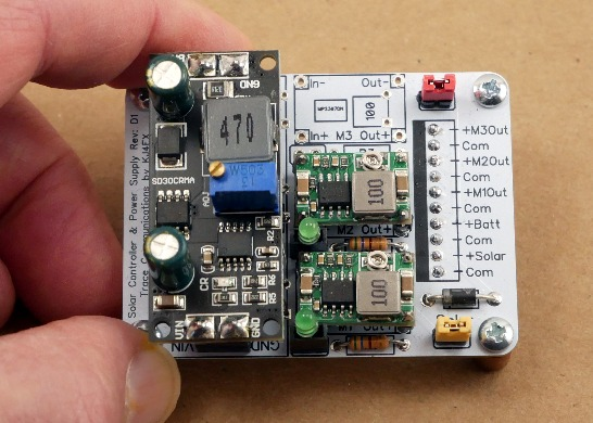

You can make an MPPT solar controller and power supply motherboard like this by yourself:
This is a PCB that accommodates one CN3795 MPPT solar controller module and up to three Mini360 power regulator modules for a wx station.
That's exactly the sort of thing I'm looking for, I was looking for something simple that can be made with off the shelf parts on some veroboard so I can get this unit working, can't wait to get something out of China. I only need 2 amps output
