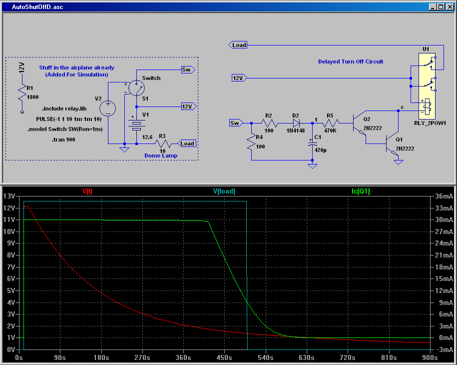

How much current does it take to operate your 12V relay?
The relay coil is rated at 30 mA (400 Ohm resistance w/ 10% tolerance).
Don
R1 is there to trim the relay coil current to 30mA. The 470K discharge resistor moved to the base of the Darlington.

In looking at your diagram, I don't see R1.
Don
It is in the dashed box. Not really something you need to build into the circuit. Simulation courtesy of LTSice.

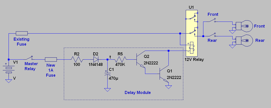

If you used a single timer and relay, you could use it to feed power to both the fore and aft cabin lights switches.
The sequence to get either cabin light on would be momentarily turn on the Master, optionally turn it off. That powers the relay for six minutes, allowing either of the cabin lights to be controlled by their respective switch. With Master off, if you walk away, the relay drops out six min after it was turned off. If a cabin light switch gets left on, then the cabin light will come on the next time you turn on the Master.
The Cabin lights are already fed directly from the battery through an existing Fuse/Breaker. Hook that circuit to the relay as shown.
Add a new fuse/breaker fed from the main bus (downstream from the Master Relay). AC43 requires that new circuit to be protected at the bus end. That supplies the charging current for the timing network.
Wire the two cabin light circuits downstream from the relay, as shown.
