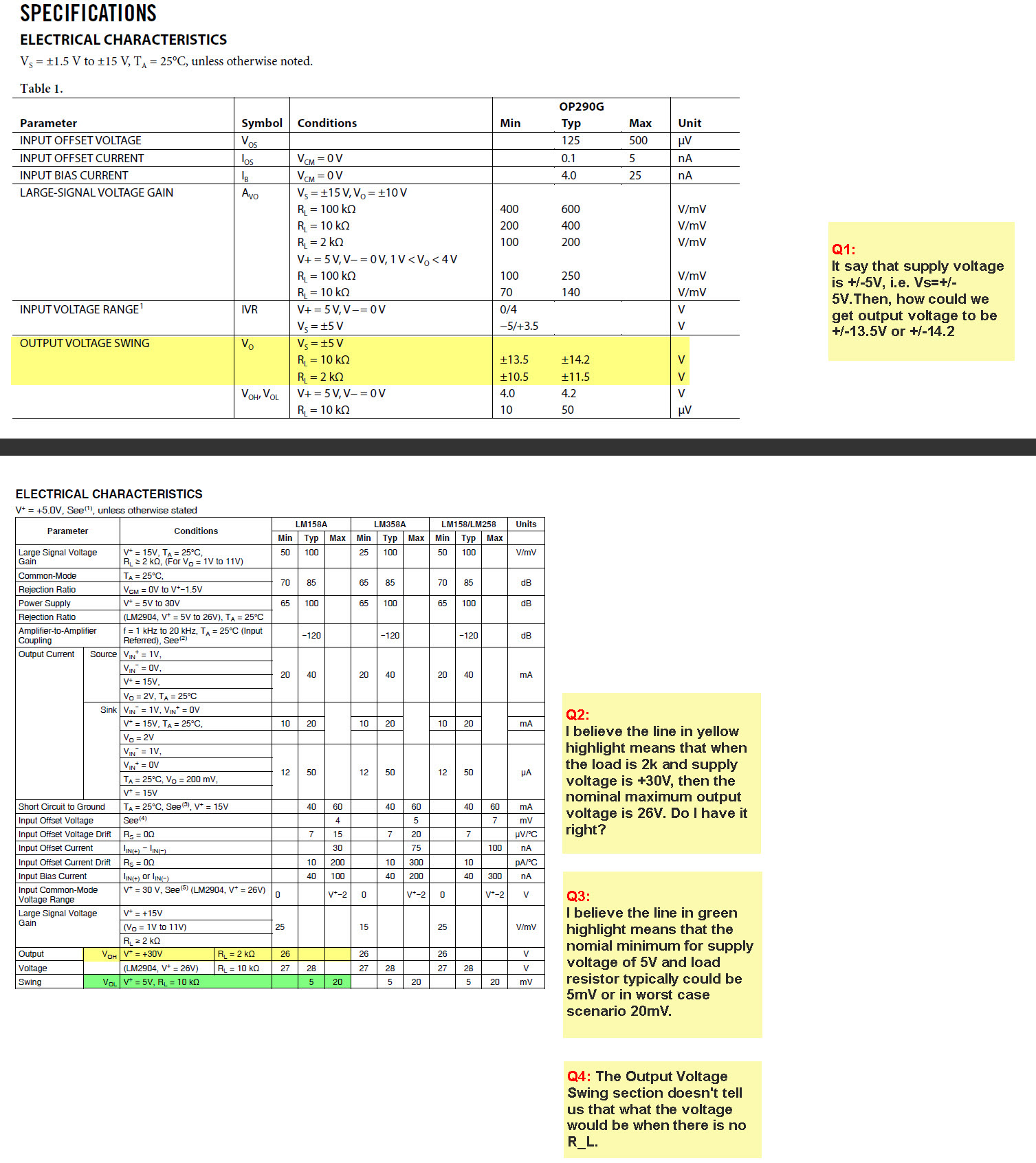

Looks like the OP290 has better input offset spec, a little better output swing at 5v, but just very low gain bandwidth.
So for low frequency stuff it would be better with the better specs.
Which parameter(s) from the datasheet led you to say this that OP290 has a little better output voltage swing? Could you please let me know?
I don't really know how to read an op-amp's datasheet so could you please help me with these queries? Thank you.
https://drive.google.com/file/d/0B_XrsbDdR9NEZmtPMUNGaENobkk/edit?usp=sharing (LM158/LM258/LM358/LM2904)
https://drive.google.com/file/d/0B_XrsbDdR9NETGpkQW9hOWU3QXc/edit?usp=sharing (OP290)
When i look at the output high for the LM358 it is normally taken to be Vcc-1.5v, but the data sheet there shows it could be as high as Vcc-1.2v which with a 5v supply means the max output will be 3.8v with RL=infinite.
For the OP290, it shows worse case 4.0v with typical 4.2v so that's 0.2 to 0.4v higher and that is with a 10k load.
Q&A:
1. Either the chip has a built in internal booster circuit (ha ha ha) or else it is a typo
2. Yes, Vout max=26v with V+ of 30v
3. Yes.
4. Right. See if you can find a Vout graph in that case on the data sheet (or a Vout delta graph).

In this post you can see that Vout=4.67005V for -2.3A. For example, if we are using LM358 with 5V supply then 4.67005V falls out of LM358's output range. But LM358 can be used with supply voltage of 5V to 30V therefore using supply voltage such as 12V will extend the output voltage range and hence 4.67005V can easily be output. Please correct me if I'm wrong.

Yes if the output should be able to get to a full 4.7 volts in normal operation then it would not work with a 5v supply unless the op amp had a near rail to rail output. The LM358 can only get up to about 3.5v, so that would certainly fall short.
With a 12v supply we should easily be able to get up to 10v output with say 10ma max output current. That would be a lot better.
Another thing we did not look at yet either was the input range. The input range may be also limited depending on the op amp. You can get this info from the data sheet too.

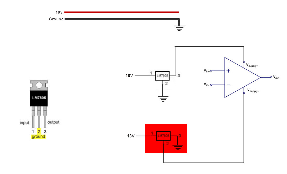

Hi
I was using this set up to apply dual polarity voltage to an op-amp but the regulator highlighted in red smoked and blew away. What was wrong with the set up? Please let me know. Thanks.
By the way, I asked about the similar set up in post #18 and in post #19 JimB okayed it.

Update: There is obviously something wrong with the set up of regulator in red highlight because I just checked another regulator in similar configuration and it became so hot with in just a fraction of second.

Yeah, there's no negative supply there anywhere so you cant get a voltage that is actually LESS than ground. You would need a 7905 regulator and a negative supply.
If you want to try it with two 7805's then you have to set the second one up such that its ground terminal connects to the OUTPUT of the first 7805, and that same output becomes the new ground for the op amp. That gives you plus and minus 5v where ground of the 18v supply looks like -5v to the op amp, and the output of the second 7805 looks like +5v to the op amp, and the common connection of the two looks like ground to the op amp.
You may also have to load the first 7805 a little more with a resistor like 100 ohms so that it's pass transistor is always conducting even if the upper (second) 7805 supplies it with a little bias current through the output terminal of the first. If any other new ground connections can produce a current INTO the output of the first 7805, the 100 ohm resistor may have to be reduced in value somewhat.
yep, you either need two isolated 5 V supplies or a stacked isolated supply as MrAl said.
You may have to supply a minimum load of 5-10 mA.
So, you have the required 3V; e.g. 3+3+5+5 or a minimum of 16V.
The Common point would not be ground in this case, but it's like stacking two 9V batteries to get a +-9V supply.

I have never used 79xx series. Why I would need a negative supply. I believe that all I need is a 7905 and a power supply. For example, If I use a +18V power supply to power a 7905 then I can get -5V out of it, can't it?
Is this what you are suggesting? Please give it a careful look because I don't want to blow out another part.
Where should the ground of Reg #1 be connected to?

Your attachments can't be found. Reminder, check the power dissipation (18-5) * 0.1a) IS 1.2 w.
the OP said:
I have never used 79xx series. Why I would need a negative supply. I believe that all I need is a 7905 and a power supply. For example, If I use ANOTHER ISOLATED +18V power supply to power a 7905 then I can get -5V out of it, can't it?
I added a few words in bold. make sure there is no unintentional connection to earth ground. Many time the - is connected to ground.

With two separate ISOLATED 18V supplies, not with one. Make sure the outputs have no connection to the AC ground pin.

I'm sorry but I don't really get it. Could you please edit my diagram to show what you are really saying? You can edit in MS paint.
I have got only 18.5V power supply and it's basically an old laptop charger. I have 7805 and 7905 regulators. Can't it make it work using a single supply and the given regulators? I can't get another supply. Thanks.

Me and drawing is kinda tough now. Scanner isn't fixed either.
Take two 7805 regulators and put them in series. Vin(1) to 18+; Gnd(1) to Vin(2); Gnd(2) to 18-
Take +5 from Vout(1) and -5 from Vout(2). Make the common point the junction of Gnd(1) and Vin(2).

There is actually a BIG difference between the circuit in post#18 and what you have used here.
In post #18 the circut implies that there are two separate and isolated 9volt supplies. If there are, the circuit will work.
Connecting the circuit of post #18 to a single supply will result in the release of magic smoke.
