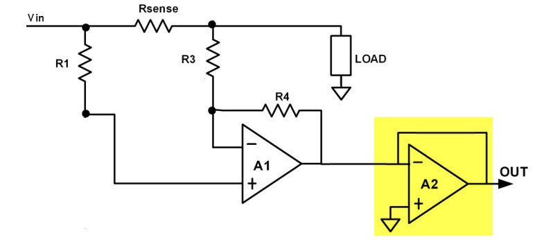

Just a quick note for the picture "sensor222.jpg".
A1 should be connected as a differential amplifier. It's not really right the way it is now.
A2 should be connected as a buffer or not used at all. It's not connected right the way it is now.
I don't get it. In my humble view the picture shows A1 connected in inverting configuration and A2 connected as a buffer with unity gain. Where do I have it wrong?

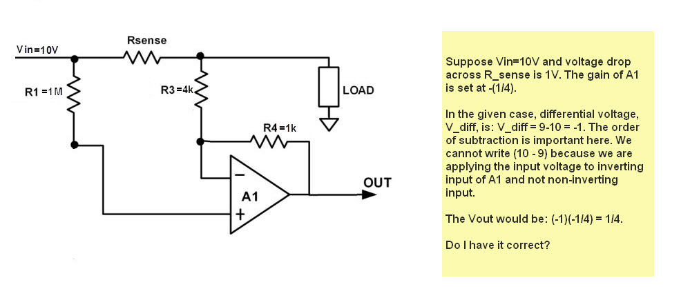

Please have a look here. Suppose Vin=10V and voltage drop across R_sense is 1V. The gain of A1 is set at -(1/4). In the given case, differential voltage, V_diff, is: V_diff = 9-10 = -1. The order of subtraction is important here. We cannot write (10 - 9) because we are applying the input voltage to inverting input of A1 and not non-inverting input.
The Vout would be (V_diff)(gain) because it's the differential voltage which gets amplified. Therefore, (-1)(-1/4) = 1/4. Do I have it correct? Could someone please let me know? Thanks.

Sure. I think what you are forgetting is that you should have a secondary method to test your result about what that result should actually be. For an op amp circuit in the linear mode, a common method is to check for what the voltage is on one input terminal after knowing what the voltage is on the other terminal by calculating it. In this case, we know the non inverting input resistance is very high so we get roughly +10v at that terminal. You can then ask yourself what does it take on the output of the op amp (also knowing the 9v voltage) to get +10v on the other terminal too.
Also remember that for an op amp the gain from the aspect of the input on the inverting terminal side is Rf/Rin, in this case R4/R3, which equals 1/4 as you noted. However, the gain from the aspect of the non inverting terminal is 1+R4/R3, and the output depends on BOTH inputs, not just the one.
Going about it with this in mind, the gain from the inverting side is 9*0.25=-2.25, and the gain from the non inverting side is 10*(1+0.25)=12.5, so the total output voltage is 12.5-2.25=+10.25 volts. Since this is not what you were after, you need to change the circuit of the op amp.
To correct this, the op amp is made into a true differential amplifier. This is done by repeating all the gain resistors from the inverting side to the non inverting side. The input resistor is the same as the inverting side input resistor, and there is a fourth resistor added from the non inverting terminal to ground, and that value must be the same as the feedback resistor.
I'll modify your drawing unless you want to.

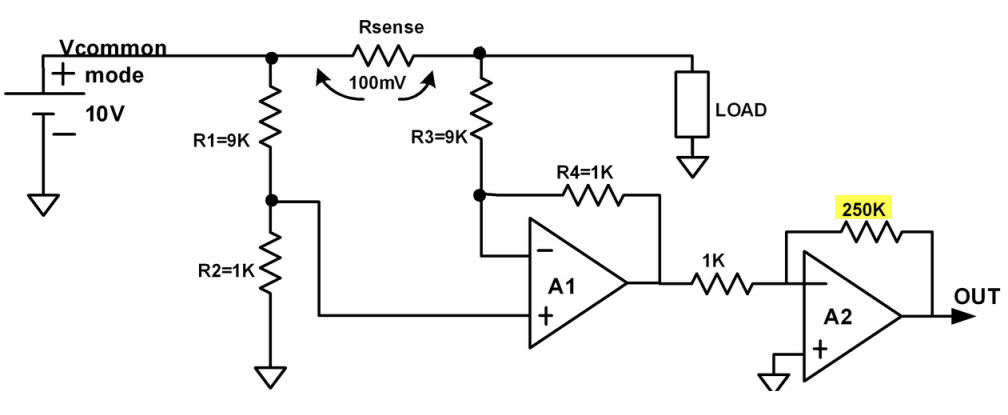

That was nice to know. I believe you are referring to this circuit which was originally modified by me for use in previous posts. Is this the one you had in mind? Do you think this sensor is a correct one?
Don't you think that the gain of A2 is way too much because -100mV would be amplified to (-100m)(-250/1)=250V. Such a high voltage cannot be handled be an opamp, right?
I had thought that a unity gain opamp is considered a buffer but in post #20 you didn't consider A2 in this 'incorrect' circuit as a buffer. Could you please tell me why?
I don't think an opamp such as LM741 can be used in such a sensor circuit where input voltage is too low. Could you please tell me some popular differential opamp ICs? One I found is THS4531.

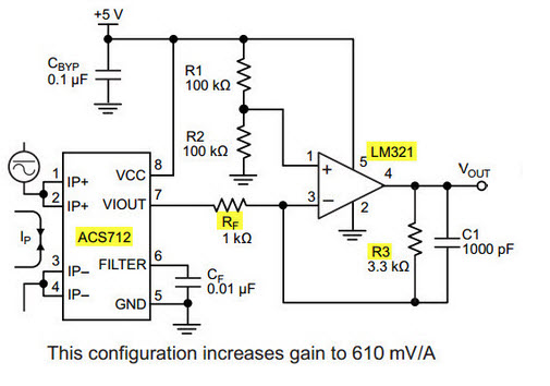

The current sensor ACS712 (here is the datasheet) without any modification has sensitivity of 185 mV/A and it can detect current in both directions.
Current of +/-5A makes +/-0.925 volts.
0.925V/5A=0.185V/A
-5A in= 2.5V-0.925=1.575
0A in = 2.5V-0=2.5
+5A in = 2.5V+0.925=3.425
Now please have a look on this circuit which increases the sensitivity to 610mV/A from original 185mV/A. Suppose +5A current flowing thru the sensor which would mean the sensor will output voltage of 2.5+0.925=3.425V at the inverting input of the opamp. What should be the voltage at Vout? By the way, the circuit can be found on page #12 of the datasheet. Thanks.

Q1:
sensor666.jpg:
This circuit has an overall gain of 27.8 approximate.
This means that the 100mv signal gets amplified to 2.78 volts.
Input offset for the op amps could be critical for these circuits.
An input offset of 1mv in the last stage gets amplified to 250mv on the output. Common op amps typically have input offsets in the 2mv to 10mv range. Think about what that can do to the output.
Special op amps can be used that have extremely low input offsets and low input offset drift too.
sensor222n.jpg:
The "buffer" in this circuit is not connected as a buffer. A buffer
gets its input at the non inverting terminal. To make an inverting
buffer, you need two resistors to set the gain to -1.

Overall:
These circuits all reqire strict attention to the DC offsets of the
IC chips, op amps and sensors alike, because the offset gets amplified
and it appears as an error at the very output. Steps have to be taken
to reduce the offset either directly (choice of op amp) or indirectly (through some zero
offset adjustment).
What else is unfortunate is that the DC offset never goes away in DC coupled circuits. If there is 1mv at the very input, it gets amplified all the way to the output.
Also, the op amp used in some of these circuits could have an offset of 7mv which is really a lot. Even the lowly LM358 is better than that.

Coming again to "Q2" from my previous post. What should be the voltage at Vout? Let's look at it first from ideal and theoretical point of view then afterwards we can see what issues can happen when such a circuit is used in real world. Thank you.
0.925V/5A=0.185V/A
0A in = 2.5V-0=2.5
Now please have a look on this circuit which increases the sensitivity to 610mV/A from original 185mV/A. By the way, the circuit can be found on page #12 of the datasheet.
These are the values for Vout when circuit is analyzed:
-5A in:
The 712 IC outputs 1.575V.
1.575V gets amplified to Vout=2.5{1+(3.3/1)}+1.575(-3.3/1)=5.55V
0A in:
The 712 IC outputs 2.5A.
2.5V gets amplified to Vout=2.5{1+(3.3/1)}+2.5(-3.3/1)=2.5V
+5A in:
The 712 IC outputs 3.425V.
3.425V gets amplified to Vout=2.5{1+(3.3/1)}+3.425(-3.3/1)=-0.553V
Are the values calculated above correct? Please let me know. Thanks.
This is my general interpretation of 610mV/A gain :
-5A in= 2.5V-3.05=-0.55
0A in = 2.5V
+5A in = 2.5V+3.05=5.55

Hello again,
Yes that is correct when the results are rounded.
The overall transfer function is:
Vout=2.5-0.6105*I
and that 0.6105 factor comes in because we are using a 3.3k resistor instead of using a 122k/37 value resistor which would make it a perfect 0.610 instead of 0.6105, but no big deal really.
So i get results:
-0.5525v
+2.5000v
+5.5525v
and rounded (away from zero) to three significant figures:
-0.553v
+2.50v
+5.55v

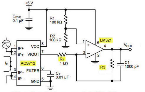

Now let's proceed further with that current sensor ACS712.
I want to use that sensor in a school project. Please note that I'm not after very, very accurate system.
I will be using 10-bit built-in ADC of a microcontroller and also will be using internal Vdd and Vss of the microcontroller as reference voltages for the ADC. The input voltage range of ADC is 0-5V.
Also don't forget that the sensor is a bidirectional one. The maximum current we will be measuring is going to be 2.3A. The sensor is a +/-5A sensor. You can see the datasheet here. The part number for +/-5A sensor in the datasheet is ACS712ELCTR-05B-T.
Q1:
First let's consider the case of when the sensor is used without any gain increasing circuit added to it like this.
-2.3A in= 2.5V-0.4255 = 2.0745
0A in = 2.5V-0=2.5
+2.3A in = 2.5V+0.4255 = 2.9255
We will only focus on the case of +2.3A case. Don't you think that the ADC won't give accurate readings because the range, 2.5 to 2.9255, is very narrow? Or, do you think that the ADC will work fine even when the range is that narrow?
Q2:
For this question I'm going to assume that the narrow range will affect the operation of ADC. The range can be extended by using a circuit similar to the gain increasing circuit we were discussing previously. Please have a look on this circuit and notice that the resistor R3.
Let's assume R3=5k and let's focus on only positive current (and don't forget maximum current is 2.3A).
0A in:---------------------Vout = 2.5V---------------------:----------------10-bit ADC integer reading in integer  = 512 //range is 0 t0 5V
0.5A in:-------------------Vout = 2.0375V-----------------:--------------------------------------------------------- = ?
1A in:---------------------Vout = 1.575V-------------------:--------------------------------------------------------- = ?
1.5A in:-------------------Vout = 1.1125V------------------:--------------------------------------------------------- = ?
2A in:---------------------Vout = 0.65V--------------------:--------------------------------------------------------- = ?
2.3A in:-------------------Vout = 0.3725A-----------------:---------------------------------------------------------- = ?
I hope the values for Vout are good but I'm not able to come up any simple formula to calculate ADC readings for corresponding voltages in the table above. Could you please help me with it? Approximately, ADC will output "0" when input current is around 2.7A which outside the range of maximum we will be measuring.
Thanks you.

Hi again,
With no amplification the range of the ADC will in fact be limited, but to evaluate the impact on the signal measurement you only need to find the error in the measurement with say a 1 bit error in the ADC. Doing this will give you a good idea what to expect in the real world.
With no amp, the output is Iin*0.185+2.5, and with 0.000A input we get 2.5v output, and with 2.300 A in we get 2.9255v output, so the (plus or minus) output range is 2.9255-2.5=0.4255v. The bit voltage for a 10 bit ADC with a reference of 5v is 5/1024, and so the output range translates to a digital count range of 87. Since the total count range spans 1024, that means we'll only be using about one-twelfth of the available digital range. That makes the 10 bit ADC look like a 7 bit ADC so we loose 3 bits right off the bat. The impact on the input however is such that one count equals 2.3/87=26.4ma, or 0.0264 amps. That has to be taken as the error that can occur at ANY input however, so best case is we will be off by slightly more than 1 percent and worst case is pretty bad anyway because with a low current there will always be more percent error.
With a gain of 5, the count range is boosted to about 87*5 (five times what it was with a gain of 1). That means we've reduced the possible error to a little more than 1/5 percent (0.2 percent error, which is 2 tenths of one percent error).
That's much better for sure. It also means that we get better error at lower current levels.
To digitize the current, first calculate the bit voltage which is 5/2^10=5/1024. Then calculate the output voltage of the amplifier (can make it a gain of 1 for no amplification), then divide that Vout by the bit voltage of 5/1024, or multiply by 1024 and divide by 5, and that is also equivalent to multiplying by 204.8, and after that take the "floor()" of that result, and that gives you the digital count for the ADC.
So a simple example is if we have 0 amps input we have 2.5v output, and 2.5*204.8=512, then take the floor of 512 "floor(512)" and get 512 again. That was obvious, but if we do 2.29 amps with a gain of 1 we get:
2.29*0.185+2.5=2.92365 and 2.92365*204.8=598.76352, and taking the floor of that: floor(598.76352)=598, so the count would be 598 for that input.

I would request you that please keep track of the details otherwise we can get wrong results. It would be better if you give my previous post another look.
From your reply to Q1, I conclude that you are of the opinion that using the gain of '5' can improve ADC results. If your answer is 'yes' then Q1 is resolved and we must focus on Q2.
For Q2 we were using this circuit where value of R3 was taken to be 5k. Please note that in the end I would need to use either 4.7k or 5.1k **broken link removed**. I must also mention that I will be using a voltage regulator such as LM7805 to power up the given circuit.
Do you think that the circuit is good for physical implementation as it is, or should some changes be made?
I was able to finding the following results. Please have a look and let me if they are mistakes. The formulas are also given below.
-2.3A in:------------------Vout = 4.675V---------------------------------------------------------------------------- = 958
-2A in:--------------------Vout = 4.35V----------------------------------------------------------------------------- = 892
-1.5A in:------------------Vout = 3.8875V--------------------------------------------------------------------------- = 797
-1A in:--------------------Vout = 3.425V---------------------------------------------------------------------------- = 702
-0.5A in:------------------Vout = 2.9625V--------------------------------------------------------------------------- =
0A in:---------------------Vout = 2.5V---------------------------------------- 10-bit ADC integer reading in integer = 512 //range is 0 t0 5V
0.5A in:-------------------Vout = 2.0375V--------------------------------------------------------------------------  = 418
1A in:---------------------Vout = 1.575V---------------------------------------------------------------------------- = 323
1.5A in:-------------------Vout = 1.1125V--------------------------------------------------------------------------- = 228
2A in:---------------------Vout = 0.65V----------------------------------------------------------------------------- = 133
2.3A in:-------------------Vout = 0.3725V--------------------------------------------------------------------------- = 76
For positive current, the formula for corresponding current represented by ADC reading is:
if(ADC <= 512)
{512-(ADC reading)}(1/189.4076) //formula applies if(ADC <= 512)
For negative current:
if (ADC > 512)
{(ADC reading) - 512}[-1/{(958-512)/2.3}]
Thanks a lot for the help.
0.925V/5A=0.185V/A
0A in = 2.5V-0=2.5
The gain on the opamp circuit is -3.3, and the reference point for amplification is 2.5 V. Hence, the output voltage at Vout will be -3.3*0.925+2.5=-0.55 V, in theory, but since the opamp is powered by ground and 5VDC, you dont have that much range too work with and the output voltage is dictated by the opamp rail to rail output voltage limit. I didnt check that data sheet for that OPAMP, but they should have chosen a single supply rail to rail opamp that can go all the way down to ground. Hence the output voltage should be about 0 VDC. If you use an amplifier with that voltage range, then you only have a +/- 4 Amp range at the output of the opamp.
By the way, that is a terrible recommendation for a circuit for providing better sensitivity. The writer of that datasheet must be recommending that circuit as a crude overcurrent fault detector or some other use that does not require accuracy. When you need good accuracy and precision, you should never derive a reference voltage (in this case 2.500 V) directly off the power supply. Not only is the reference set to half the supply voltage, but there is no filter cap either. If you need a high accuracy signal with more sensitivity, you need to use a precision 2.5 V voltage reference on the +pin of the opamp.
I think this is because the whole sensor is build in such way too. They don't use a stable voltage reference, but instead refer 0A to Vcc/2. Perhaps they felt that this is Ok for low-precision sensor. Here's what they say in the datasheet:
Quiescent output voltage (VIOUT(Q)). The output of the device when the primary current is zero. For a unipolar supply voltage, it nominally remains at VCC ⁄ 2. Thus, VCC = 5 V translates into VIOUT(Q) = 2.5 V.
Therefore, the sensor's output already contains noise from Vcc. Referring the op-amp to Vcc/2 is actually removing the noise that they have introduced in their sensor.
I think this sensor does more harm than good compared to a simple sense resistor.
Northguy,
OK, thanks for the correction. I'm surprised they take that approach. I would think that an A/D channel should be used to monitor Vcc/2 in order to compensate for supply loading effects and regulator tolerances/drifting.
I'm really glad you told me this. I use the Allegro A1302 for magnetic field sensing in the lab. I went back and read the data sheet and it is the same method as this current sensor. Fortunately, I've always set Vcc to exactly 5.000 VDC for short term lab measurements.
First, the output of most current sensors like this is ratiometric with respect to the power supply voltage. This means the output will be Vcc/2 not an absolute 2.5v for zero input. That means a resistive divider is recommended for the reference. There could still be a variation with temperature however, so another device could be used as the reference with no current input. This may not be necessary with the more modern sensors however...check the data sheet.
Thank you, MrAl.
4.7k might be ok, but you do have to check the op amp output at the plus and minus input extremes to make sure that it can actually get to those values.
PG
As mentioned, the output of the op amp has to be able to reach the voltages needed. Some op amps are very limited to what voltages it can reach on the output with a given power supply voltage.
I am keeping the number of questions and data sets down to a more manageable number per reply.
