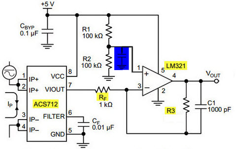

I didn't mean much. I was trying to say that to keep track of the details such as 10-bit ADC is being is used, the voltage output of current sensor IC, etc.
Yes, in general some gain can help because the circuit then takes better advantage of the ADC input range. Of course it also amplifies any error present in the sensor. If the gain is too high, it could also push the op amp output out of range.
4.7k might be ok, but you do have to check the op amp output at the plus and minus input extremes to make sure that it can actually get to those values.
So, gain can help. I need to design this circuit so that's why I wanted to confirm it.
I believe 4.7k would do better than 5.1k because this way the output won't go near the rail voltage. Note that we are dealing maximum current of 2.3A and in this circuit the value R3 was chosen to be 5k.
Moreover, don't you think that using a capacitor like this next to non-inverting input of the op-amp a good idea? A small value capacitor such as 22-33 pF would be okay.
If possible, please also have a look on this part from previous post which you didn't address in your last post.

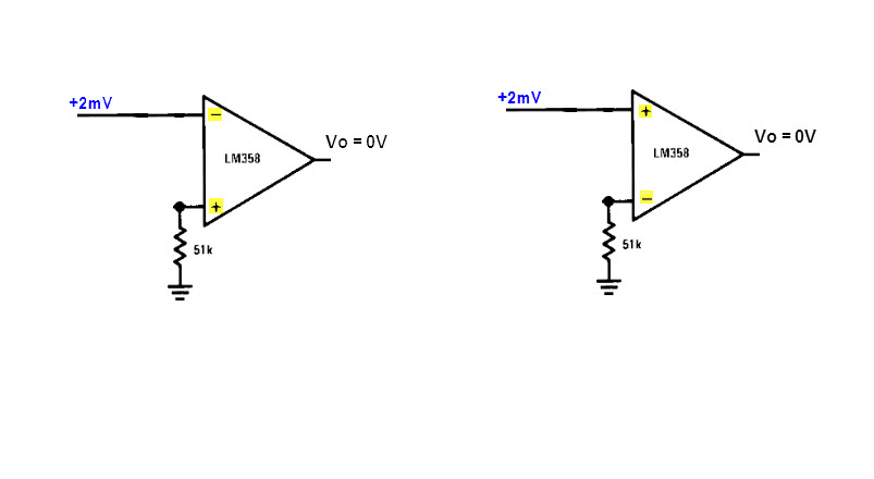

This is a general query. If a single supply op-amp is power by +5V supply then the its lower rail voltage is ground. I mean to say that its output voltage cannot go negative.
NorthGuy: I hope you are following this discussing about the current sensor. I'm not able to find any other current sensor other than the given one. Using a shunt might be a better idea but in my view for someone like me who don't have any experience with designing real circuits this might pose a problem by making the circuit more messy and error prone. If you or anyone else have any better current sensor IC in mind then please let me know because it's possible that I might need to order some stuff from online dealer such as Digikey. Thanks.

Hi PG,
I know you said 10 bit ADC. With my post i was pointing out that a 10 bit ADC looks like a 9 bit ADC if we only use half the range, no matter where that range is within the full input range of the ADC. Using only 1/4 of the range means it looks like an 8 bit ADC, etc. So we loose resolution if we dont use the whole range.
Amplification can get us back to a range that is closer to the full range, but we also must think about the error getting amplified too then. This may or may not be significant to the application.
It's questionable if a 33pf cap will do anything there, or if it is even needed at any value. The op amp has a filter cap so that might be enough. The idea with a cap in that position would be to get the two resistor network to have a time response similar to the sensor.
I did not 'miss' your question about the data set. I was trying to keep the questions down to a more manageable number per reply. It makes reading the questions easier and faster.
With your data set, i assume you are using the circuit with the amplifier, so what value of R3 are you using?
But what do you recommend? Using the current sensor without any amplification circuit gives small output and hence limited range of ADC is used. But with amplification, you say that error also get amplified.
So, you don't recommend it?
And I didn't say that you missed it! :) I used this circuit where value of R3 was taken to be 5k.
Yes, you did miss the following query. This is a general query. If a single supply op-amp is power by +5V supply then the its lower rail voltage is ground. I mean to say that its output voltage cannot go negative. Thank you.

Using the amp is still better.
The decision to use a 33pf cap would have to be made after a few real world tests.
Lets concentrate on the calculations for now and come back to the others a little later.

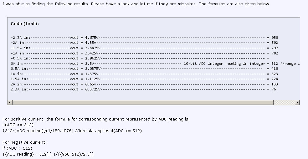

In your data set, there appears to be a few errors. The -2.3 amp entry looks like it may be off by a few counts.
In my calculations or data set in this post the errors lie in decimal part of the numbers. I believe the reason for this is that I calculated the values for sensor output separately and then used those rounded sensor output results to find Vout of amplifier circuit. Hence, a kind of accumulated error occured. Besides this, I wasn't able to any other error with that data set.
This is from my data set: -2.3A in:--------Vout = 4.675V--------ADC result = 958
This is using your formulas: -2.3A in:--------Vout = 4.6275V--------ADC result = 948
There is an error of "10" between ADC results.
I believe overall my method of calculation was correct. If I'm wrong, please let me know. Thanks.
Also, some of the other entries look like they are rounded UP when they should be simply truncated. For example, if the analog output result is 417.8 the digital result should be 417, not 418.
Simply speaking, we are always interested in integer part of the number.
Note to self: floor() is a Matlab function like round() and ceiling(). The floor() is used to find integer part of a float.

Thanks for the formulas. I have edited them a bit. Hope you won't mind.
Im not sure how much of the work you wanted to do yourself so im not showing all the work yet :)
I had already done my work while constructing that data set but that's a different thing that I left some errors there for you to correct! :) Thank you.

You noted that there is a count difference of 10 count in one of the readings, so you verified that there is something wrong with one of the calculations.
When you are studying this kind of problem and something like this happens like this, it's not enough to simply state that "there is an error". You must hunt and track down that error so that you can continue your work comfortably. Who made the error, was it you or was it the person giving you the other conflicting answer? To find out you should at the very least go over your own work to verify the procedure for calculating the gain and whatever else was done correctly, and additionally if the solution method of the conflicting data was also given to you, then you have the unique opportunity to go over THAT work as well in order to fish out any possible bugs.
I provided you with the method i used by providing the formulas. The formulas are nothing more than the gains of the two circuits and any offsets combined. I suggest at the very least that you provide your formulas step by step so we can all go over them.
For my solution, i simply start with the transfer function of the sensor as one formula, then find the transfer function of the op amp circuit, then combine the two. I then convert to digital form as i mentioned by dividing by the bit value 5/1024 and then taking the 'floor()' of the result.
So if you can state your solution step by step we'll see what happened that gave you a count that was different.
The following is from my previous post above.
I did check some values but didn't update that data set. The reason for not updating is first I need to finalize value R3 between 4.7k or 5.1k. I will update it soon. Thanks.

I have constructed a new table of the values. This time R3=5.1k and R1=1k in the circuit.
-2.3A in:------------------Vout = 4.67005V---------------------------------------------------------------------------- = 956
-2A in:--------------------Vout = 4.387V----------------------------------------------------------------------------- = 898
-1.5A in:------------------Vout = 3.91525V--------------------------------------------------------------------------- = 801
-1A in:--------------------Vout = 3.4435V---------------------------------------------------------------------------- = 705
-0.5A in:------------------Vout = 2.97175V--------------------------------------------------------------------------- = 608
0A in:---------------------Vout = 2.5V---------------------------------------- 10-bit ADC integer reading in integer = 512 //range is 0 t0 5V
0.5A in:-------------------Vout = 2.02825V--------------------------------------------------------------------------  = 415
1A in:---------------------Vout = 1.5565V---------------------------------------------------------------------------- = 318
1.5A in:-------------------Vout = 1.08475V--------------------------------------------------------------------------- = 222
2A in:---------------------Vout = 0.613V----------------------------------------------------------------------------- = 125
2.3A in:-------------------Vout = 0.32995V--------------------------------------------------------------------------- = 67
Formulas used:
i:
Vout = {I*0.185*(-R3/R1)} + 2.5
ii: ADC reading = floor{Vout (1024/5)}
iii: For positive current:
2.3A is represented by = (512-67)
=> 1A is represented by = (512-67)/2.3 = 193.47826
193.47826 ADC reading respresents = 1A
=> 1 ADC reading = (1/193.47826)
Hence corresponding positive current any ADC reading = {512-(ADC reading)}(1/193.47826) //formula applies if(ADC <= 512)
iv: For negative current:
-2.3A is represented by = 956-512
=> -1A = (956-512)/2.3 = 444/2.3
444/2.3 ADC reading represents = -1A
1 ADC reading represents = -1/{(444)/2.3} A
Hence corresponding negative current for any ADC reading = {(ADC reading) - 512}(-2.3/444) //formula applies if(ADC > 512)

Hello again,
I am not sure why you want to insist on using two formulas when only one is needed. That is, one formula that covers plus and minus signals. There are two parts to the formula (current sensor and op amp) but it's just one formula and it can handle anything you throw at it. It makes life a lot easier.
There is one value in your set that does not fit. I suspect it was just a simple miscalculation for that one data point. I am posting my set here so you can review. When i do my set i use a program so that all the values are calculated the same way. I'll include that too so you can see how easy it can be.

Iin    VSout     Vout   ADC
-2.3  2.07450  4.67005  956
-2.0  2.13000  4.38700  898
-1.5  2.22250  3.91525  801
-1.0  2.31500  3.44350  705
-0.5  2.40750  2.97175  608
+0.0  2.50000  2.50000  512
+0.5  2.59250  2.02825  415
+1.0  2.68500  1.55650  318
+1.5  2.77750  1.08475  222
+2.0  2.87000  0.61300  125
+2.3  2.92550  0.32995   67
Program:
atom R1,R2,R3,Rf,Iin,Vsout,Vin,Vout,Vref,Vcc,ADC
sequence IinValues
IinValues={-2.3,-2,-1.5,-1,-0.5,0,0.5,1,1.5,2,2.3}
Vcc=5
R1=100000
R2=100000
R3=5100
Rf=1000
Vref=Vcc*R2/(R1+R2)
for k=1 to length(IinValues) do
  Iin=IinValues[k]
  Vsout=Iin*0.185+2.5
  Vin=Vsout
  Vout=Vref*(R3/Rf+1)+Vin*(-R3/Rf)
  ADC=floor(Vout/(Vcc/1024))
  printf(1,"%+3.1f  %3.5f  %3.5f  %4d\n",{Iin,Vin,Vout,ADC})
end for
sleep(3600*24)
Note that in the program the formula is left in two parts for your easy inspection. If we combined them we would have one simple formula:
ADC=floor((500*R1-37*Iin*R3)/(200*R1)/(5/1024))
and that is good for any polarity signal.
Simplifying more, we get:
ADC=floor(512-(4736*Iin*R3)/(125*R1))
and this also allows you to get a sense of the effect of the polarity of Iin that i think NorthGuy was looking for, because 512 is the half way point for the ADC.

Let's focus on LM358 and the datasheet says that it has low input offset voltage of 2mV. So, what is this "2mV"? According the text it means that differential dc voltage of 2mV is needed to be applied to the inputs of LM358 to make the output 0V. In other words, you need to do this to make output voltage to be zero.

That's very good, and almost correct. The only difference is that the 2mv can either be plus or minus for an op amp even the same type. So one might have +2mv offset and the next you pick up out of the parts bin might have -2mv offset.
The way this affects an application usually depends on the gain setting and it mostly affects DC coupled circuits not AC unless the gain is very high. For a gain of 5 for example, the output voltage could be off by 10mv (input offset 2mv again). If that 10mv represents 2 ADC counts (10bit ADC with 5v ref) and 2 ADC counts equate to (say) 20ma, then the ADC count could be off by plus or minus 20ma due to input offset. There is also some drift associated with the input offset, so it may increase with temperature. The data sheet should contain this info.
