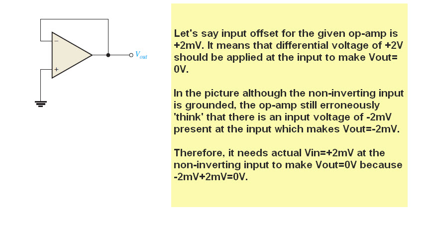

I don't think that I have it right as KISS also pointed out above so let's go thru the basics.
First let's see that if my basic understanding is along the right lines.
Let's say input offset for the given op-amp in this picture is +2mV. It means that differential voltage of +2V should be applied at the input to make Vout=0V.
In the picture although the non-inverting input is grounded, the op-amp still erroneously 'think' that there is an input voltage of -2mV present at the input which makes Vout=-2mV.
Therefore, it needs actual Vin=+2mV at the non-inverting input to make Vout=0V because -2mV+2mV=0V.

Yes.
To clarify the input offset voltage has a min and max range. So, if it's specified as +-2mV, it could actually wind up as 0, dependent on temperature.

So, I had it correct though I'm also waiting for MrAl's comments. I'm still confused about two points.
So, it is effectively measured by putting the OP amp in a buffer configuration and measuring the output. with the +input grounded. So, with a gain of +1, input offset = output offset.
Perhaps, to be precise, you should have written |input offset| = |output offset|. Please let me know if I have it correct. I understand that there isn't really a big difference but to me it might indicate a loophole in my understanding.
In this picture from my previous post, Vout was confirmed to be -2mV. The input offset voltage is said to be differential voltage. The differential voltage is Vdiff = Vin - Vf where Vf is feedback voltage. In that buffer circuit input offset voltage was taken to be 2 mV, i.e. Vdiff=+2mV. The Vf was -2mV. It gives Vdiff=Vin-Vf => Vin=+2mV+2mV=4mV. The Vin for that circuit should have been +4mV and not +2mV. Where am I going wrong? I believe that input offset voltage isn't really the differential voltage I'm familiar with.
Please also help me with this next step. Thank you.

Input offset = output offset.
Agreed, for this case.
input offset voltage = (The inverting input) - (the non-inverting input)
We call it differential, because it's not referenced to ground.
In general, you can test an OP amp when it's not used as a comparator by looking at this voltage.
