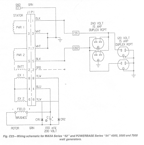

Hi Mark
Part of what I wrote was my bad so lets look at a cartoon similiar to what you have. Hopefully I can get that attached right. :)
OK, one thing I suggest is removing the two yellow wires from the diodes. What you now have is just the lines off the excitation windings. The blue wire is a center tap of those windings. So first measure across the yellow wires looking at AC Voltage. Just watch that AC voltage with the unit running. Obviously there won't be any generator output. You want to note that voltage and see if it drops after some run time.
Now the blue wire is the center tap of your excitation windings. What I am saying at this point is that while monitoring the AC on the yellow wires if it drops out then measure from one yellow to the blue and then the other yellow to the blue. One of those two yellow to blue should be about nothing as in zero AC volts.
Remember when measuring the voltage across the yellow wires with the diodes disconnected you are measuring the AC voltage off your excitation windings. That AC voltage once rectified by the diodes becomes your field voltage. If that AC voltage (yellow to yellow) remains a constant then it is time to look at your diodes.
As to the diodes what I suggest is placing your one meter lead to ground (this with diodes reconnected) which will be the Anode of both diodes in your case. Now measure the forward voltage drop by placing your other meter lead on the post or diode Cathode. That forward voltage drop should remain a constant for both diodes when the system is running.
Excitation windings don't generally fail or break down but measuring that excitation AC output will show if one of the coils is failing.
As to the capacitor. That caps job in life is to smooth the full wave rectified DC created by the diodes. I have seen plenty of caps fail in a shorted state and plenty fail in an open state but never saw a cap fail in a half shorted state and act like a zener diode. :) That is why I am reluctant to see a problem with the cap.
Ron

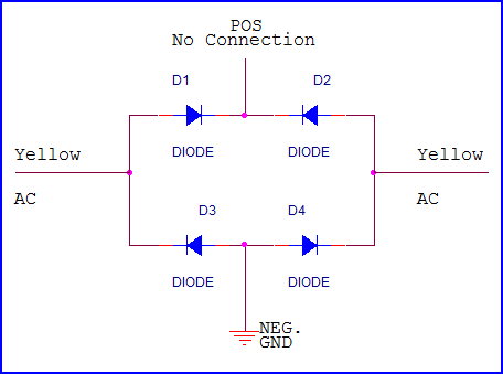

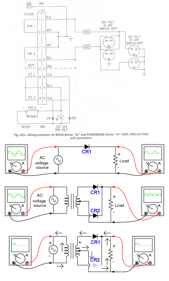

OK another cartoon attached with some added stuff. However in the pre cartoon mode here is a brief description that covers what RCinFLA brings up:
FIELD EXCITATION
When a dc voltage is applied to the field windings of a dc generator, current flows through the windings and sets up a steady magnetic field. This is called FIELD EXCITATION.
This excitation voltage can be produced by the generator itself or it can be supplied by an outside source, such as a battery. A generator that supplies its own field excitation is called a SELF-EXCITED GENERATOR. Self-excitation is possible only if the field pole pieces have retained a slight amount of permanent magnetism, called RESIDUAL MAGNETISM. When the generator starts rotating, the weak residual magnetism causes a small voltage to be generated in the armature. This small voltage applied to the field coils causes a small field current. Although small, this field current strengthens the magnetic field and allows the armature to generate a higher voltage. The higher voltage increases the field strength, and so on. This process continues until the output voltage reaches the rated output of the generator.
What you have and what many of its brothers and sisters are is a self excited generator. The start is based on residual magnetism and that sort of starts a snowball effect. Looking out the window maybe "snowball" was a bad choice of words? :)
Anyway the attached drawing contains a few examples of rectification just pretend the transformer is actually the excitation windings. The images are not my work unless we count adding the CR designations.
Someone mentioned building aircraft generators? That was funny as about maybe 25 years ago I worked for Lear Siegler Power Equipment Division and we designed and built aircraft generators and GCUs (Generator Control Units) and I also have a collection of diodes used in them. Problem is they don't have usable part numbers on them. I have no clue what they are rated at. Beefy little stud mount guys they are. If I knew they could handle 200 PIV @ 12 Amps I would send a few.
Also, somewhere around here I have a bunch of full wave rectifier blocks. I got to thinking (very rare happening). If you had a full wave block you could likely use three of the four legs in a configuration like what you have. Long as the diodes in the block meet the requirements it should work as a test anyway. That would be another option to at least test things. The best I can come up with is they should be between attic and basement. I found the stud mount aircraft diodes in a bag with assorted gun parts (owned a gun shop years ago). My organization really sucks so good thing my wife is patient as I have "stuff" squirreled away all over.

I found something that may be of use to you in this. I knew I had a bunch of full wave bridge rectifiers around here. I have several of KBPC3504 Rectifiers. These are rated at 35 Amp (overkill) and 400 PRV. One of these could likely be configured like the attached image and though awkward would tell you once and for all if a few diodes will fix the problem. I hate to see you pay for diodes plus S&H and still have the problem. If you want one drop me a PM with where to send it and the wife can mail it tomorrow morning. I don't want anything for the bridge or postage so don't worry about that just let me know.
Ron

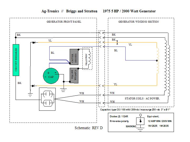

Ron, Posted for the disillusionment of all are the latest results.
The Cap is replaced. The original was a polarized cap, the new one is not. IF a polarized cap is required, I'll put the old one back in. But the 2 1/2 minute failure is still present with the new cap.
The diodes are now a NEW pair of stud mount 1202R. Same polarity and same amp/volt range as the original.
Test Temperature = 40°F.
Generator Load = NO LOAD.
At 2 1/2 minutes the genny AC Output dropped from 125vac to 93vac
Brush DC voltage dropped from 67vdc to 37vdc.
Brush AC voltage dropped from (untested) to 25vac.
Diode voltage failed mode = 50vac and 41vdc for BOTH DIODES.
If the generator resumes correct output after it cools, I'll collect the pre-failed AC voltages at the Diodes and across the brushes. At this point, the genny is cool to the touch and is not returning to 'normal' output for the first 2 1/2 minutes.

Sounds like you are down to a partial short in the exciter coils or rotor coils. Good chance its going to be a rewind or toss it. :(
One method to possibly confirm it would be to put a full wave bridge rectifier on one half of the exciter windings and power the rotor off of that and see if it does it. If so then switch it to the other side and repeat.
If it still does it you may have a partial short in the rotor windings. Then the only other option would be to externally power the rotor and see what happens. If it drops out just the same with an external power source its a rotor problem.
That's not at all what I was hoping for but I'm thinking you're right. To prove exactly where the problem is might further my education, but it won't fix the rascal. This has been very interesting and certainly educational but to be honest, I've pursued this in anticipation of a repair. I'm not sure that the cost of the rewind is supported by the value of the repaired generator. A cost estimate would answer that question. I may unwind it just to continue my education.
Another thought - If I pull the rotor and put an ohmeter across the coil and center tap on each side - then gently add heat, Might I find a change? on one side? And I'm not discounting the external 70vdc power supply clipped to the brushes. Interesting.
