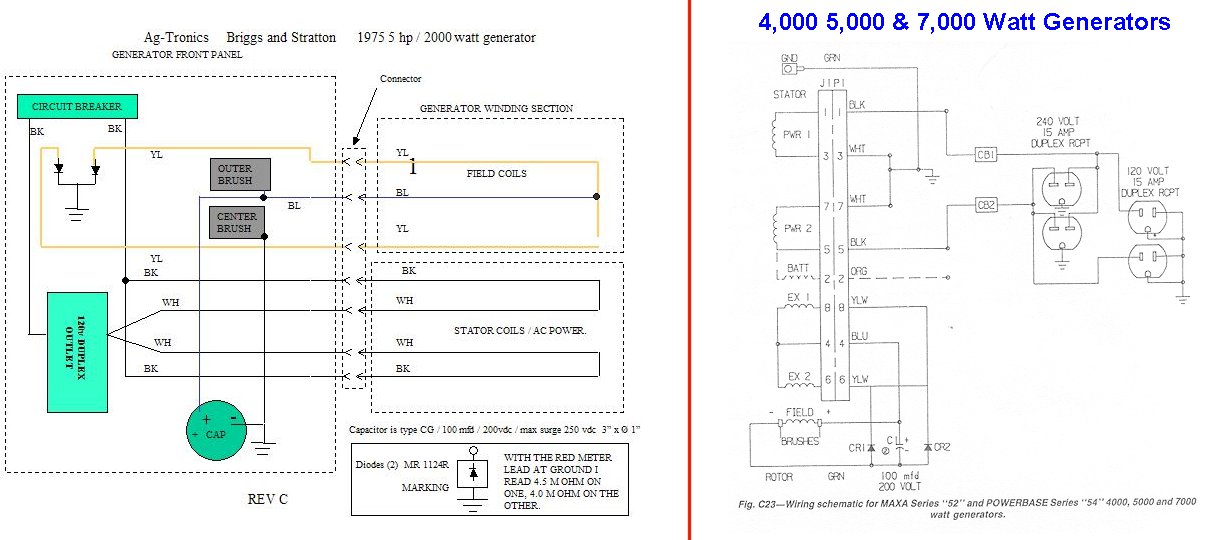

I don't think I would be quick to short anything to ground. If possible I would measure the forward voltage drop across one diode then the other. Typically I would guess you should see about 0.6 Volts. That should be stable. My problem with your symptoms was the diodes were breaking down in my case. You can give your other thoughts a try. Without seeing a schematic I just don't want to suggest grounding anything.
Ron
I have not came across it on generators but I have seen it a number of times on old welders where all the diodes test good but when put on a load bank one will go open after it warms up and as soon as it cools down its good again.
Its very frustrating to try and find unless you have a O-scope and can watch the actual waveforms across each diode and the output lines. If one diode goes out its wave form signature is very obvious.
Besides its about all you have left that can create a low output voltage yet not completely drop out. The skipping brush would give a fairly noticeable sparking being the rotor is basically a good sized inductor on a DC circuit. It would naturally tend to give off a very noticeable spark if the commutator rings are skipping.
Ron - I agree about taking anything to ground as an experiment. There is a schematic posted early in this thread. Note that the BLUE wire is a centertap in the rotor winding. The feeling is that the cap is just a filter in the circuit. If it were to short I'd have no field voltage. I have removed the cap from the circuit with the genny running and the output did not change. Diode tests are next.
TCMTECH; My current thought (thought de jour?) is that one of the diodes is opening so we agree on that. The diodes are the stud mount type, screwed into the chassis of the genny. I'll remove the field wire from each diode. I'll attach a temporary wire to each diode and route it out of the genny via a large access hole. And I'll route each field wire out through the access hole. The connections will be made using test leads. When the genny field voltage drops from 72vdc to around 35vdc, I'll disconnect the diodes one at a time. When I disconnect the failed diode nothing will change. When I disconnect the remaining good diode I expect the field voltage to drop to zero - or at least it will change significantly. The thought is that removing a failed diode from the circuit won't do much. Removing a working component from the circuit will change things dramatically. Nothing will be run to ground.
To All watching this thread. I'm only going through all of this stuff in hopes that someone with similar issues is reading along and learning. I found out early on that these little generators are sort of a mystery and there isn't much troubleshooting information available. Through this testing and posting of results I hope someone increases their knowledge base. I know that I am learning.

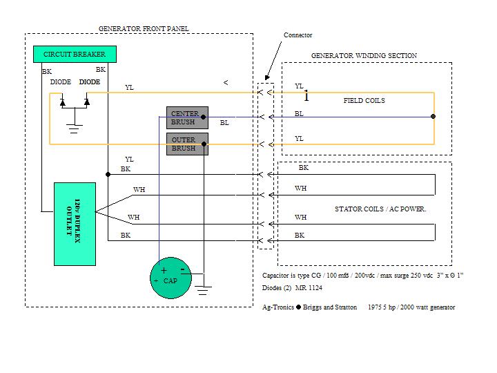

I looked very closely at the marking on the diodes to be sure I got the orientation correct. The diodes are shown and the connector between the windings section of the genny and the bell end (front panel) is corrected. Oh, and the blue wire now looks more like a center tap. It's getting better. It's been a lot of years since I've needed to make a schematic. Just a simple circuit diagram usually does what I need.

Now your schematic makes much more sense!
You are right about the limited amount of troubleshooting information on the small portable generators from years ago.
When your done this will be a thread likely worth doing a rewrite of and having ETO post it permanently in the RE or AE section of the forum as a referance thread.
One note for you is that most of the small generators are usually set for about 62 - 63 Hz no load and will usualy pull down to around 57 - 58 Hz at its full rated load if the governor is still good. Its how I have always set up welder generators.
Schematic does make more sense but the outer brush line (Yellow) is connected to ground in the schematic and continues through a diode to ground. This makes Anode and Cathode of one diode both going to ground. I figure that is a boo boo. The diodes conduct on alternate half cycles. The picture shows things pretty clear.

Ya got me. Gotta fix the schematic - I messed up the ground circuit. And I'll remove the diodes and check for an "R" designation on the marking. I did a test and I'll post the nonconclusive results at that time. Gotta go get some lunch now. But I'LL BE BACK!

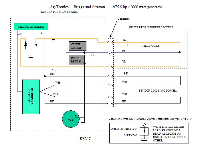

I'm back. The schematic is revised again. I'll post it as REV C. When I get this done it will be a real art form! And perhaps it will be typical and of use to someone else. The diodes are "R" type and the ohmmeter shows about 4 megohms with the RED lead on the ground threads and the black lead on the solder terminal. I changed the schematic to show how it works electrically. This is making more sense now. Oh, and I had the brushes wired wrong on the schematic. Don't know what happened there. It should be better now.

I'll be back In the meantime, look at the schematic again and grade my paper.

By chance can you externally power the rotor? If you have a solid near 75 volts going to it and it still does it then you know its either some weird diode break down effect or a partial short in the exciter windings that acts up when the winding temp starts to rise.
I am now half tempted to wonder about a dried out capacitor being the cause. That can have possible effects on how it is working in the circuit as well. If it looses its connection internaly it could cause the voltage filtering effect it does to drop off. That would also cause problems with the rotor voltages being the power feeding it drops from near peak to the RMS of the exciter coils.
Only three revisions to get your schematic right? :rolleyes:
You are overqualified to work here! :D
I vote for the capacitor going bad. BTW I think you drew the diode backwards, the way they are drawn it would clamp the field at .6v

Down to the business at hand. 75 volts would have proven the diodes if the failure was the diodes. If the diodes aren't the issue, we'd still be scratching our heads. And believe me when I say my head is darned near wore out from the scratching??!!
I offered early on that a big ole cap like that that's 35 years old and been stored in old barns and sheds in northern Indiana should be in bad shape. Didn't know if that was true, but it shoulda been. But I needed a test to determine WHAT is the cause of the drop to low output. So we've been here for a week.
Neal, the cap thing in the schematic - they're drawn the way they work, not the way they look when I look at the cap in the photo (post # 10). It's the R at the end of the part number - MR 1124R that designates a reversed attachment. Anode and Cathode are switched. That's a cruel joke to play on an old guy. That tidbit came from Ron a couple of postings ago. So You think it's the cap too? Well here's the latest test result.

If you plan to put something together on this adventure the attached image may help a little. It consist of your image plus another image of a 120/240 volt unit. Note that things haven't changed much as that design has been around and used for decades.
I am still betting on diode breakdown but then too, I would have bet on the Colts.
Edit: EX2 has an extra wire that should not be in there. When I placed the 2 drawings on a single canvas I lost a line. Well I guess I found it as wire :) . That is not a wire but an inadvertent line.

Ron, I think that publishing both is a good idea. My "schematic" is more of a combined wiring diagram and schematic. A lot of folks with no real training find the diagram very useful. Yours is obviously more correct. Once I get all of this information gathered and put together I will be submitted and might prove to be a resource for others with similar problems.
