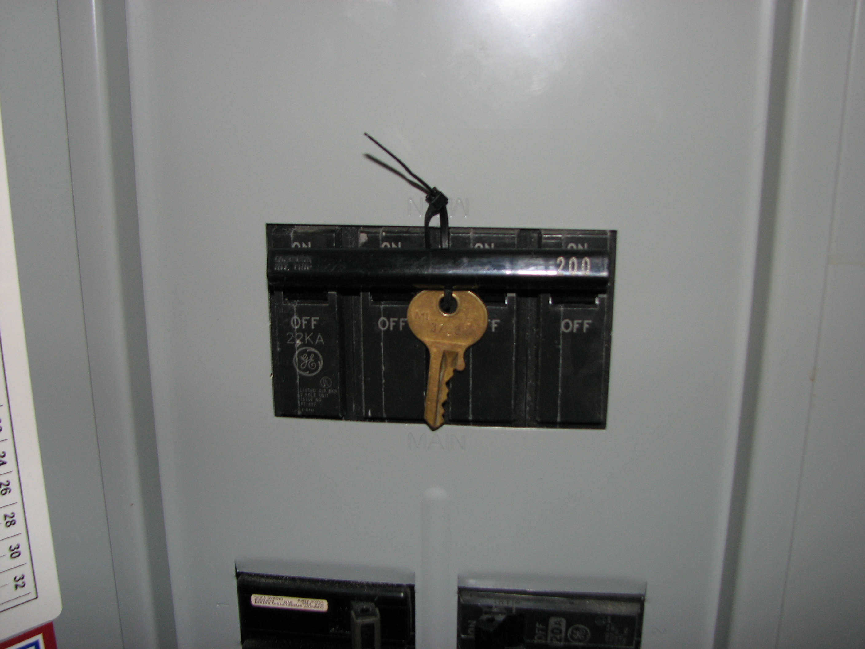

Right now I feel like I have the eyes of this thread looking over my shoulder watching to see how I handle this.
Without an interlock, a transfer switch or some method to GUARANTEE the mains are off before generator power is applied to the box, there is always a chance that someone could forget to open the main breaker resulting in a danger of electrocution to linemen, destruction of your generator and fire.
What I have addressed is a no-cost way to ensure that I CANNOT connect my generator to my house circuits until I turn OFF the main breaker that feeds the utility power into my box. I use a custom made interface cord designed to connect from my generator to my house electrical circuit. For reasons of liability I'll not discuss the make-up of that cord. The purpose of this discussion is simply to provide a foolproof way to ensure my mains are turned OFF before I apply generator power to the household electrical circuit.
SO, the end of my special cord that interfaces with my garage outlet is locked in a simple plastic box. It's just a 4" square electrical box - a plastic one. I padlock the plug into that box so it cannot be used. The padlock has a key. The key is attached to a wire tie that is passed under the cross bar of the mains in my household power box. It is stuck under the cross bar and I can't remove the key without flipping the breaker off - then the key falls on the floor. Again, to get the key needed to unlock my special cord so I can use it, I HAVE TO FLIP THE BREAKER OFF.
There is a down side to this. When neighborhood power is restored, I have to remove the generator from the circuit and lock up the cord properly. My method is not as good as an interlock or transfer switch. But I'm working on it.
Mark

Thanks for the picture, a picture says a thousand words.
I see now exactly what you mean.
If you should happen to think of a simple arrangement which does cover it both ways, please post it as i would like to know.
Haven't thought of one myself yet, but i feel there would be something simple along the lines that you have already.
Regards, John :)
Hey John, that's a pair of dandy stories. Makes the point really simply. The key situation is super simple. It's not fool proof because there is no limit to a fool. They'll always find a way around whatever you do. But it is a simple reminder and that's what I wanted. Something that would always remind me to simply OFF the mains. Mission accomplished. Making a gadget that requires the key be returned to allow the mains to be reset is a bit more complicated. The sliding-plate interlocks sold online are hard to beat. I don't like the $150 part, but they do have to make a buck after the marketing, manufacturing and shipping/handling. I may just make a cardboard template and whittle one out of a metal plate. Slides are simple. Pop rivets are cheap. It doesn't have to be elegant for my use, it just has to work. When I get a plan for something simple, I'll post it. OOH! I'm having happy thoughts already! I'll be back.
Mark

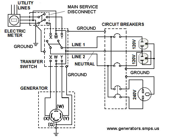

Well, this is a reasonably good read on the subject and has the emphasis on US mains:
When AC line voltage is normal, a TS allows powering the load from the
grid. When AC fails TS connects the load to the generator while
isolating it from mains. Connecting any power source directly into any
point of electrical wiring without a transfer switch is illegal and
dangerous because of so called backfeeding. Backfeeding (or
interconnection) is supplying electricity from your wiring system back
into electric grid. It energizes the line transformer serving your house
and poses an electrocution hazard for utility workers and for your
neighbors who may not know the voltage is present in the line. In any
case, your home generator most certainly will be overloaded by your
neighbors' loads in the disconnected local portion of the grid or
damaged if power is restored while it is backfeeding.
The standard U.S. household electrical service is 120/240 volt single
phase. It normally has two black "hot" wires and white grounded neutral.
The nominal voltage between each line and neutral is 120 VAC and between
two lines is 240 VAC. Note that both lines still belong to a single
phase- they are obtained by grounding the centertap of the utility
transformer. For such a system a generator transfer switch should be
double pole double throw (DPDT) "break before make". Double throw means
you can place or throw it into two positions (off position is not
counted). Double pole means it transfers both line wires (poles). The
neutral is normally continuous and does not have to be switched unless
your genset is equipped with a GFCI. "Break before make" means it
disconnects load from one source before connecting it to another one.
Older 2-wire 120 volt residential systems require a single-pole double
throw switch. Likewise, a three-phase generator would need a three-pole
device. The TS generally should be installed within 2 feet of the main
distribution panel and 30 feet of your genset inlet box.
Normally an electrical transfer switch for home generator has three
positions: LINE, OFF and GEN. When switching between LINE and GEN, it
always passes through the OFF position. Such break prevents arcing or
short circuits during the transition. If power rating of your genset is
not sufficient to power the entire house, you may install an additional
distribution panel (a subpanel) and hook up the essential lines your
want to backup to this panel. This sub-panel will then be wired to the
transfer switch. Many commercially available TS come already with a
pre-wired panel.
Additionally attached is an image depicting what a manual transfer would look like. Note that both the neutral and ground are tied at the panel. The neutral is not disconnected or broken at any point and should not be broken.
The back feed issue is one of controversy and always has been. Yes, linemen check for such things but that is here nor there. The issue becomes legality and liability. For US applications the NEC 2008 and the NFPA 2004 from what I read don't overly get into it and leave it to local and state codes (laws). The consensus has always been it is better to err on the side of safety.
Grounding is required and should be done properly. When I put in the emergency fixed generator I drove an 8 foot ground rod into the ground and when the city inspected the first thing they looked for was my grounding. These rods are available from Lowes and Home Depot and are actually a copper plated steel rod. When using a portable unit a clamp can be used to connect generator frame to the rod.
You want effective and you want safe but you also don't want or need a transfer system that will exceed the cost of a generator. :)
<EDIT> The quote and image were taken from here.
Ron
Lots of good comments coming back. As always, I'm reading everything and taking it all in. I've done a good deal of on-line searching and I have found situations that appear to be constant for portable generators. I'm not dealing with a generator with permanent wiring and there is no GFCI, so it's pretty simple.
Genset WITHOUT GFCI;
#1 - UL approved and NEC approved devices don't break the neutral for a portable generator connection. (note: Gensets with GFCI require a 3 pole with neutral break)
#2 - If the portable has a 4 wire connection - use it. Or simply run extension cords from the generator to appliances to be powered and watch the cord rating versus appliance load.
#3 - An INTERLOCK devise is acceptable and a transfer switch is better to provide an interlock between the mains and generator feed.
One last question - until the next one; If we simply use extension cords, I need to ground the generator, right? The generator does have a ground lug that needs to be taken to an earth ground rod.
I would. You don't want a person being the path to ground in the off chance the housing (cage) somehow becomes hot.
Ron
I can make a better argument FOR grounding it than AGAINST grounding it. I'll drive a ground rod next time I'm home.
