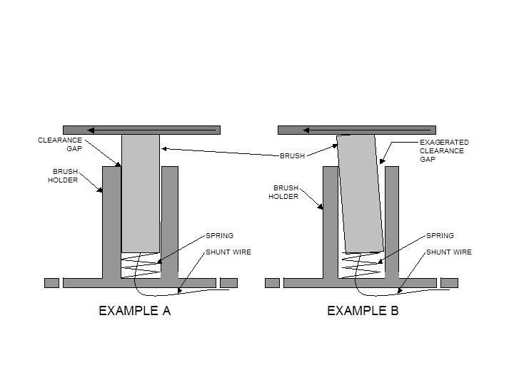

I'm building a great database in the generator theory area! Thanks everyone for the replies. Here's the latest.
The Ag-Tronic again runs perfectly. In my excitement, I put a load on it soon after it was warm enough to run without choke. I had not set the engine RPM at this point, but I did see 8 amps output. UREKA!!
I restored the engine to 3600 per my digital tachometer. At proper RPM, I had 12 amps at 117vac output with 62vdc at the brushes. Cool. Feeling pretty smug, I sat back and just watched it run – then watched the voltage fall off to nil at about 5 minutes into the test. So what happened?

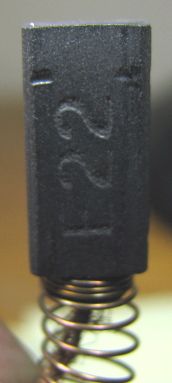

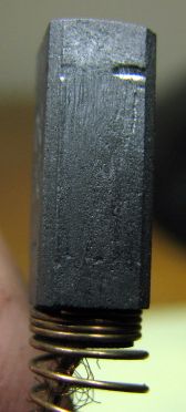

Investigation leads me to a theory. In a word, BRUSH WEAR. The newly cleaned rings show polished brush contact areas with one distinct feature. The outer ring is about 12” in circumference. There is a gap in the polished area that is about 2” long. It appears that the ring surface is not PERFECTLY perpendicular to the centerline of the rotor. The spring should keep the brush in contact with the ring despite the very minor imperfection. UNLESS – the brush is worn in the mounting flange.
See the attached examples.
Example A shows the design intent. The brush should be a sliding fit in the holder. The brush would move easily on it’s axial centerline and would not bind.
See Example B showing worn brushes that can cock and stick in the holder. Certainly the example is overstated, but noting my brush wear, I believe that it’s valid in theory. See the photos and note the slight cuts indicating the end of the location of the brush holder. This indicates that the brush is supported at the outer edges of the holder and not along the length of the inner sides of the holder. Also note that the end of the brush is not worn square. The angle of the contact face indicates that the brush is cocked in the holder.
When the bell is mounted, the brushes are compressed. The rotation of the rings could certainly cock the brush just slightly. As the generator runs, the corner of the brush in contact with the ring would wear off, but the side thrust across the brush face would prevent the brush from extending by spring pressure. The contact face wears away just a few mills and contact is lost, befuddling the entire AC power generation cycle. When I shut the generator down and fiddle with it, the brush resets against the ring and the generation resumes for five more minutes. Each time I run the generator it starts strong and quits at about 5 minutes into the test. I think I'm shopping for new brushes.
Thoughts?

Before going much further along this path,
i think you should attach a couple of leads to the brush connectors,
and take them out to a voltmeter.
You can then watch the voltmeter next time you start the unit.
I think you may see the voltage fall away after five minutes or so.
The more information you can get at this point,
the more likely that you can identify the problem.
John :)
John, At this point I think I'm getting to the mechanical cause of the electrical problem. I've tried not to offer a persuasive arguement, just offering what I know to be true and what that would lead to. Your thought on the leads and voltmeter would be very informative. I found brushes at an online supplier. My brushes are 14.34mm long. New brushes are 22mm long. The shortened length will allow them to turn in the mount. I didn't really want to put another $20 into this rig. I purchased it for reconditioning and resale and I paid too much for it. If I can recover most of my money and deliver a solid performing unit I can write off the loss as experience. I must say that I have a MUCH better understanding of the workings of these little gadgets! And it's been fun.

At this point, I'm into the brushes. My father in law suggested finding very thin plastic shim stock and shimming the old bushes so they run true and tight (not binding tight) in their holder bores. I offered tape. He laughed at my 'cheap way out'. But packing tape is 0.002 thick, adhesive backed polyethylene plastic sheet. Funny how the description changed the validity of the suggestion. Knife cut and applied tightly under a work magnifier the fix looks good. The brushes are now 0.003 undersize in width and 0.007 undersize in height. The load of the ring wiping motion is in the width direction and that's as tight as I can get it without binding.
This is a temporary fix. If my power output becomes stable and reliable, I'll replace the brushes as a set for $20.
Test result with the brushes tightened. It initiated and took a load perfectly for 3 minutes with 135vac and 75vdc at the rotr measured at the brushes. Then the amp meter started to fluctuate and output dropped to 3-4 amps and the DC voltage at the rotor dropped from 75vdc when the output was strong to 32 vdc.
I shut off the engine and fiddled with the brushes by reaching in through an access port. I basically just poked at the brush holder with my finger. Within one minute of shutting off the generator I restarted it and it picked up the strong output again, 135vac, 75vdc at the rotor and 8 amps. I've never seen it run for more than just 3 or 4 minutes with strong output. This time at 8 minutes of run time it was still strong when I shut it off. We agreed that it seemed to be running fine. Gotta test it just one more time - I restarted it and the vdc at the rotor was back to 35 volts with the resulting very low output again.
