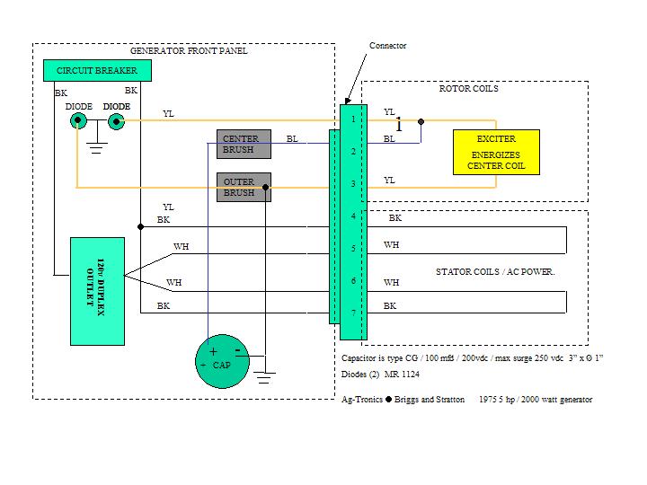

Any chance you could provide any form of schematic as to how its wired? Small generators have may different ways they are regulated. Same with the self excite principle as well. Right now there are simply to many possible variables that are unknown.
Is it a two, three, or four ring rotor system?
Does it use just slip rings or does it also have a commutator system like a DC motor?
What output voltages does it have? Just 120 or 120/240?
Yes, I have a schematic. I've pulled the head apart and checked all with my DVM -no shorts, no opens. Two brushes run on rings and they're like new. I've cleaned all with contact cleaner. The diodes work like diodes and the cap works like a cap - everything was checked out of circuit.
I've tried to attach a schematic and I hope it works. I'm new to this forum and I'm just winging it right now! Please be patient.

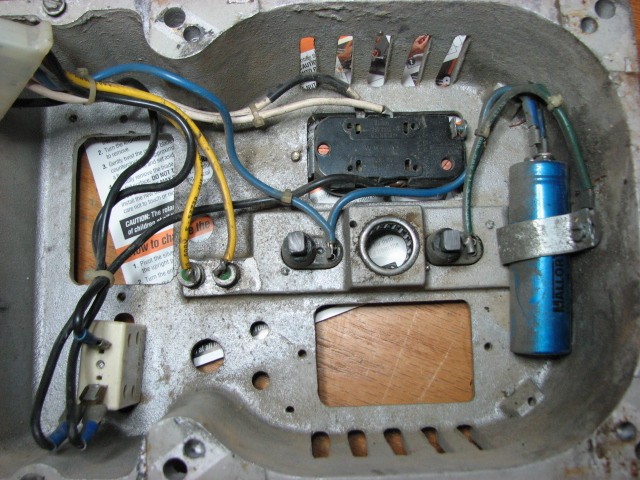

Since the schematic attached properly, I'll add a shot of the inside of the generator head. The head connects to the windings via a 7 connector plug.

Definitely helpful. Can we get a picture of the exciter unit and the generator coils themselves too?
The schematic doesn't seem to indicate where the exciter gets its drive power from as I see it any way. I have worked on a number of similar systems over the years and I have suspicions that the exciter may have a problem and or the capacitor may have an internal bad connection that is limiting the rotor power by not filtering the input power well enough at times.
Being 35 years old (according to the schematic) things tend to get bad connections and other intermittent problems.
If needed I will take the generator apart again so you can see the inside. I can tell you that the two coils (black/white) that produce the AC power enter and exit the stator windings side by side. And the Exciter coil (yellow wires) go in and come out pretty much alongside the power windings. The stator windings for AC and Exciter are terminated at the connector body attached to the stator housing (the middle section of the generator head). The front panel of the generator head is removable (as shown in the photo) and the electrical connections are made via the other half of the connector body. And there's nothing else in there. The rotor is connected to the output shaft of the engine. And it's all pretty basic. The inner brush is connected to ground. The (-) side of the cap is connected to ground. The (+) side of the cap is connected (via the blue wire) to the exciter winding.
Basic except the answer to the age old question - what the heck drives the exciter? Maybe the rotor is a bit magnetic? About the electrolytic cap. It is very old and although it looks good, the probability that it is at the correct capacitance is unlikely. But it does act just as a cap should when I put the DVM on it. It holds a 12 volt charge for about 24 hours per my bench test. Let me know if you need the photo and I'll post it tomorrow night. Thanks for the support! Mark
Okay I see. The schematic is partially wrong or at least drawn in a way that is schematically wrong. The exciter coils produce AC which is apparently center tapped with the center tap connected to the blue wire that goes to the one brush and the capacitor from there. The two diodes are on the outside ends of the exciter winding and go the diodes to complete the circuit.

I'll start at the top and work through what I know to be true. I won't make any suppositions.
The exciter coil is an AC coil that is wound with the AC power windings. They all go into the stator and come out of the stator together.
The blue wire is a center tap. It routes from the (+) brush through the connector and into the stator windings (that explains why there are 7 wires in the connector. That seemed odd until you mentioned a center tap.) The end opposite the center tap is connected to the brush and the (+) connection at the cap. The other terminal of the cap is grounded.
Yes, the two diodes are at the ends of the yellow (exciter) winding.
