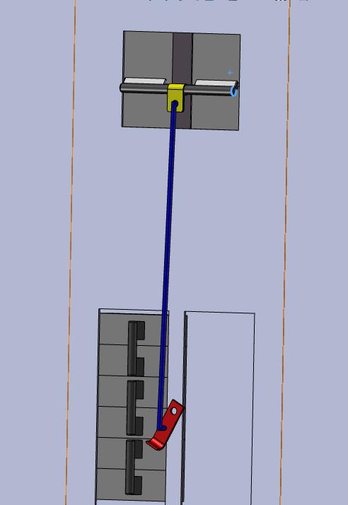

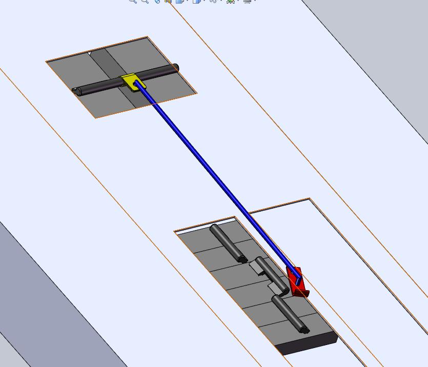

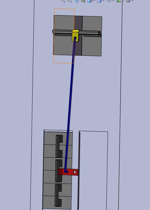

I finally came up with a way to make a very low cost interlock. Since an interlock isn't a game of brute strength, it doesn't need to be extremely robust. It does need to prevent the accidental dum bass attack - you know, the maneuver that nearly lets us energize the mains with the genny still plugged in. Or energizing the genny with the mains ON.
Nuts - the photos loaded backwards.
In photo 3 the main is UP (on) and the rotating bar is blocking the genny breaker. In Photo 2 the main is down (off) and the genny breaker can be ON. In photo 1 the genny breaker is ON and the rotating bar is locking the mains from being flipped UP. I'll make it and see if it works. The rotating bar is sheet metal and made with a hacksaw and drill. The clamp around the bar in the center of the mains is just a cable clamp. The rod that connects the two is a bicycle spoke or metal rod or flat rod or whatever. You guys know whats in the junk drawer in your shop.

Very creative. :)
Junk drawer in my shop? What junk draw? My junk collection extends to all corners of the house including attic and crawl spaces. Oh yeah, and the shed in the yard also. I know no limits. The wife would provide a sworn statement to that effect.
Again, the approach looks quite good on the breaker panel. I like it.
Ron
I looked carefully at what I had done and realized that it's a good plan, but not for me. The breaker that I was going to lock-out is feeding a 15 amp 220 feed in the garage. It's tapped from an electric dryer outlet. Locking out that one will lock out my 220 outlet in the garage. That's also my back-feed connection point. On to the next plan. I do have a 30 amp double breaker in the panel that used to feed an electric baseboard heater. The heater is gone, but the breaker is there and the heavy cable is in the attic. Excellent place for a connection to make a dedicated generator input with the interlock on that breaker. All I need is a source for electric cable at an affordable price.
