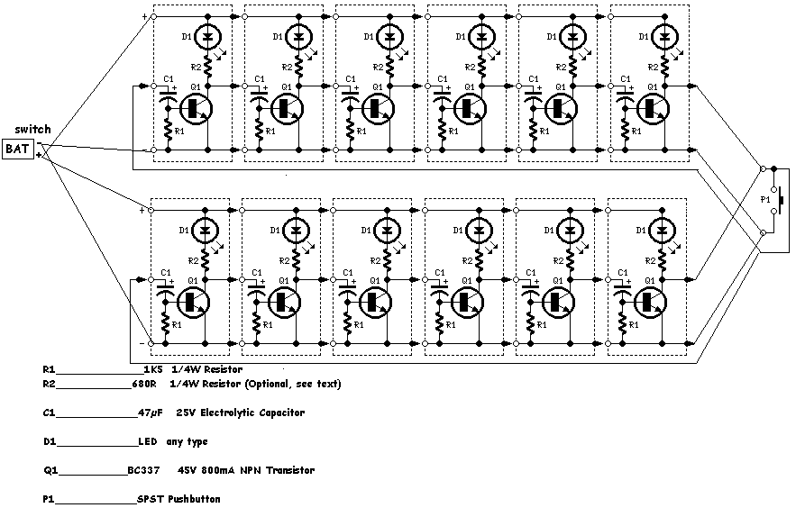

here is my project, i am tring to make some custom LED rear indicators using 6 LED's.. my bike has a 12v battery so when the key is in its at 12v with lights on and when engine is turning its at 12v - 14.5v
so maximum supply is 12v to 14.5v
my goal is to have an LED squencer rather then just blink so whhen i hit the indicator button power is supplied to the LED's i want them to flash in a sequence... i found a circuit diagram, i am just checking with you guys if it would work.. here is it.
https://www.redcircuits.com/Page72.htm
I won't have the switch there (p1) just a direct connection and the pos and neg supply from bike as shown on the left hand side...
since i will have 6 led's does that mean i will have 6 Transistor, 6 capacitors, and 12 resistors on one board?
Also on the Notes section is says:
You can use several LEDs per module. They must be wired in series and supply voltage must be related to their number. (how do i wire them in series correctly? and i am going to be using hyper white LED's 2.2v each)
Using 24V supply (the maximum permitted voltage), about 10 LEDs wired in series can be connected to each module, about 7 at 15V and no more than 5 at 12V. (using 6 LED's would that be a problem?)
The right number of LEDs can vary, as it is depending by their color and brightness required. (color is white and maximum brightness is about 11000 MCD)
please help me out in this, if some one can draw me a new schematic for my situation that be cool if not i can try to edit it my self with some help.
thank you
Max
also i am very new to electronics my career feild is in criminal justice and stuff like that.

no you need the switch otherwise they will go on one at a time ..when power is first applied..and they will all stay on..
since i will have 6 led's does that mean i will have 6 Transistor, 6 capacitors, and 12 resistors on one board.
yes ...

I must say again that is a very neat circuit.. :)
no need to press two buttons to make them go off...
just press another one
it would work like this..
the ON/OFF button , closeest to your thumb..on the handelbar..this turns them all on or off..period..
the other button starts the sequener .. only...

Thats a pretty neat circuit you found.
The dotted lines look like they are sectioning off each 'module'. They are not wires.
~Mike
as MrMikey said..it sections them off..
when the switch is activated the first stage charges up the RC combination and base one in the process turning on transistor one.this starts transistor two's base charging up..turning on transistor two ....
meanwhile trans 1 goes out because the power is no longer applied to its base...

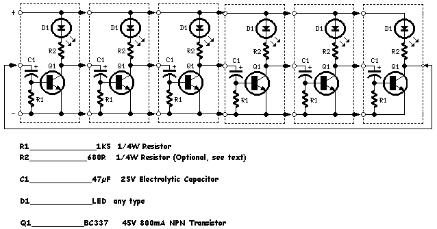

Okay cool, here is the circuit i drew or created on the computer is this correct? i am going to make this if everything looks good..... thanks
max
Maxer said:
max
looks good to me ..just hook up an on /off switch ..and maybe a fuse (for Protection ) and your good to go..

Hi Guys,
I think that you missed the point of that simple circuit requiring a reset button:
When power is applied, any LED or combination of LEDs will light!
You'll need a 2nd person to hold the reset button and watch the LEDs until they all go off except the last one. Then that other person releases the reset button and the sequence begins. No good for a turn-signal.
You need to have a digital stepper, like a CD4017 with an oscillator. The CD4017 has built-in "smarts" (disallowed states eliminator) to ensure that only one LED will light when power is applied. You will need 2 circuits, one for the left LEDs and the other for the right.

crap that sucks i thought i finally had it well can you help me fix this diagram so i can start over? please thanks
max
okay here is the new schematic, you think this will work? it has no switch
thanks
max
this auto turn indicator ... if connected properly to the front of your circuit
should /could .. blink the LED's in the right sequence from the get go..
audioguru had a good point
what would happen if we were to connect the wire comming from the relay..+12V on ...+12V off ....to the base of the first transistor and the 12V supply to your circuit..just trying out ideas here..
