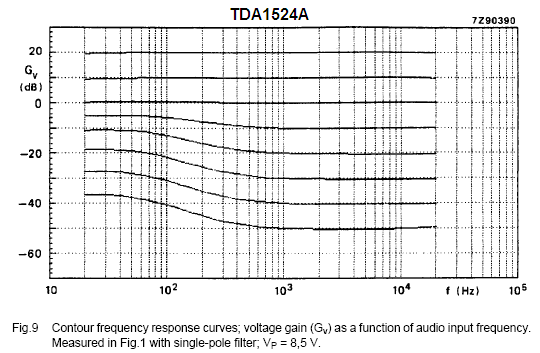

N.B: What is that 'contour' in 1524?
Nice arrangement. Where do you see contour?
Ahh.. I saw it in the spec. sheet, to tell you the truth, I have no clue what it is.. You should ask the audio guys, I am a radio guy :D
The "contour" is the loudness compensation that boosts the bass up to 12dB when the volume control is turned down because our hearing is not sensitive to bass frequencies at low volume. The contour can be switched off if you don't want it.
Thanks. That one seems to be a good control. I really need it.
'Contour' ON/OFF :rolleyes:
The "contour" switch in the TEA1524 application circuit connects a 2.2K resistor in parralel with the bass, treble, balance and volume potentiometers, when the resistor is connected, it is in "linear" mode, and when it's not it is in "contour" mode... with my modest audio knowledge :D I would say the switch affects more than just the bass...
Connecting a resistor in parallel with all the pots saves adding another pin to switch the contour on and off. The datasheet shows that the contour boosts only the bass at low levels. The LM1036 boosts the lows and highs which is better because it is the way our hearing works.
The LM1036 has an adjustable amount of loudness contour.
The LM1036 has much less noise and distortion than the TDA1524A.
