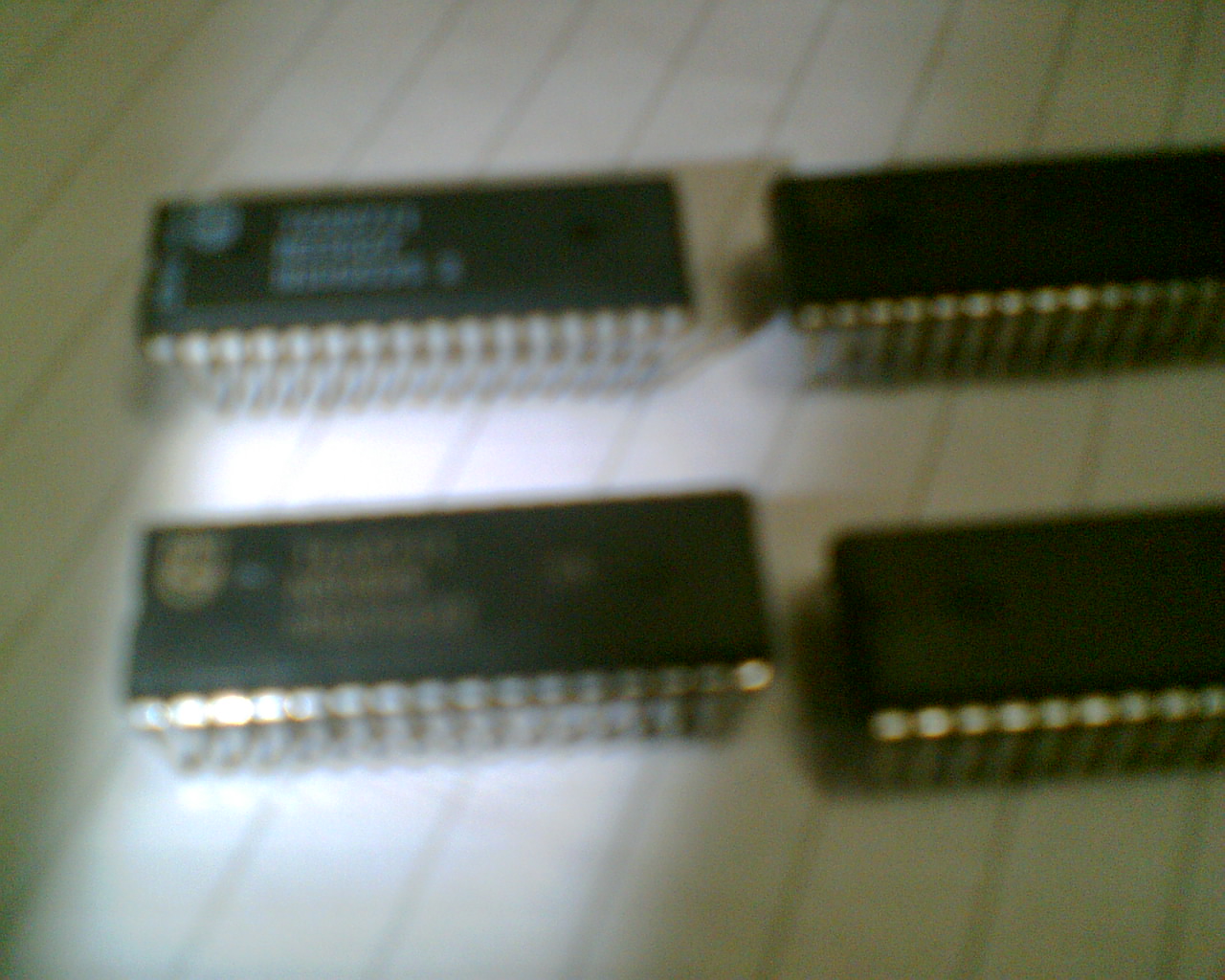

Yesterday I picked up 4 pieces of TEA5711 easily from a component store here in Bangalore city. I enquired in just three shops. First one told that 'its Philips IC, discontinued no longer available'. Next one asked me how much you want. I told four and I got it for 50 Rupees(around 1 us dollar) per piece.
Again I found its available in another shop also. Here I'm attaching the picture for you(mobile pic, sorry for bad quality). The top left IC is similar to what you have on your receiver and mine (Made in Taiwan). But the rest three are marked using dark golden font(not white).They told its original and showed me some duplicate chinese pieces of SONY cxa1019 IC. The part number is same but 'SONY' is not written on them. Also quality is not comparable.
So I think the last three pieces may be the later(last) version of TEA5711.They looks more nicer than the first one.
It seems pretty available here in India :)
When money comes, I will pick up more and more..:D

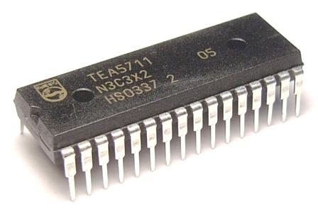

Last 3 pieces looks exactly like this(google image!).

rahulan999 you sun of a gun! ;) I got the last 2 available in some store in Germany, don't know if there are more in that country.. mine were made in Taiwan, the radios are working well, so am sure they are good quality.. So what are you going to do with all those TE5711's? Just display them and tease those who are looking for them? ;) I think the next step for you is to make a Stereo receiver and be proud of your work.. You can use the close-up view on my page to get an idea of the layout.. Well good luck if you attempt this project! ;D
