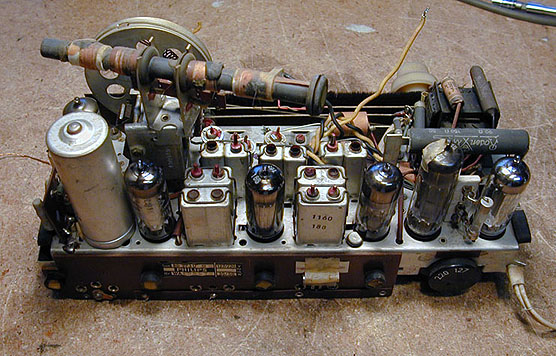

Hey guys did you see my 9 tube-3 IC homemade stereo FM receiver? It has a tuned RF amplifier, a ratio detector and 5 double-tuned IFTs for very good selectivity. The receiver (tube) and decoder/amplifier (solid-state) have independent power supplies. It is beautifull to use in the dark :) Read all about it here:
We can buy a very expensive vacuum tubes amplifier. Its tubes glow in the dark and it heats your home but the tubes are not part of the solid state amplifier circuit. They are there only to be seen and make some warmth.

Sometimes I wonder on the extreme construction techniques followed by old radios. All the spares were of high quality and clever assembly! After IC's came radios are made by local industries also and quality became pathetic. Older ones are gold and they run for many years even after rough uses. Nowadays, I think it's not possible to achieve such quality.
You get what you pay for - but old valve radios certainly weren't reliable, transistor ones were far more so - the quality of components used in valve radios wasn't high either, poor quality resistors, poor quality capacitors, electrolytics failing, wavechange switches failing - they were full of poor parts and failed all the time.
You're looking looking back through 'rose tinted glasses' - decent quality modern gear is far more reliable than the old gear was (the cheap junk from China isn't, but it's not going to be).
But they have tried on their best to achieve maximum quality possible at that time. Only dedicated brands were on play! Nowadays, even though the technology developed it's difficult to differentiate good and fake parts available everywhere.
