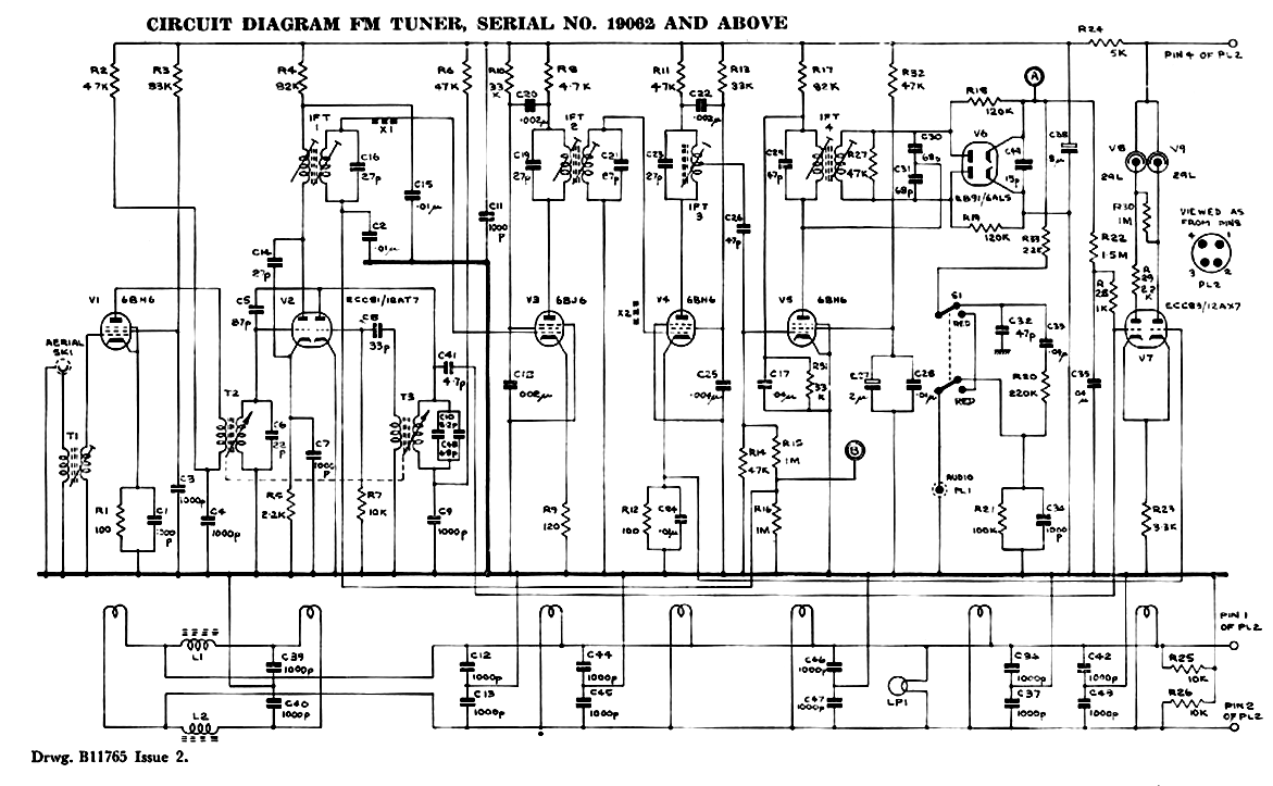

Do you have a circuit for it?, google doesn't seem to find one - but here's a far older Quad FM16 circuit that does have AFC (as all decent radios do).
