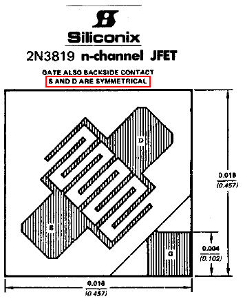

And . . . believe it or not: drain and source are
interchangeable. I build a small amplifier and I got
the same measurements and also the same gain.
I've never given it any thoughts before but I remember
that in some (Philips) datasheets they state clearly
that drain and source are interchangeable and that the
device is symmetrical. Of course this applies only to
junction fets and NOT to mosfets.

Be aware that some of the links show the testing of a MOSFET which is quite different than the 2N3819 JFET.
Although it doesn't matter because drain and source are interchangeable, some of the diagrams show top view while others are showing bottom or side view. This can be very confusing (and may have confused the writers of some of the data sheets.)
The drain and source of most jFETS are interchangeable because they are made with symmetry.
