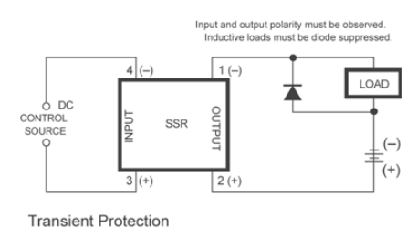

Using the SSR, will I need a diode as shown in the wiring diagram attached?
This photo came from the expensive SSR datasheet.
If so, will the one you refereed to earlier be okay?

Yes, you need a diode across any load that's inductive to prevent voltage spikes from zapping the relay. The 1N4002 should work fine.

Oh okay, so really when I get this thing in the mail, all I should have to do is hookup an output from my microprocessor to the input, and wire the motor connection plus the diode to the output portion of the SSR, and be done with it?
Since my uP only outputs 5v, and as you stated, the SSR will operate properly over a relatively wide voltage range, no external resistor on the input side should be needed? I think I've answered my own question, but just trying to confirm everything so I know exactly what to do when I get it, and if I've ordered everything I need :)
Thanks for your help also!!!
Sounds like you are good to go.:D

I would energize that SSR from a 5v power supply and measure its current draw before letting the uC assume control and possibly zapping its output pin. If it needs more than the uC can provide you'll still have work to do. 7.5ma @ 12v might be anything @ 5v. Nobody knows.
The SSR has a resistor in series with the internal LED. The resistor would be ~ (12V-1.7V)/7.5mA = 1.3K. So, at 5V the current will be ~(5-1.7V)/1.3K=2.5mA.

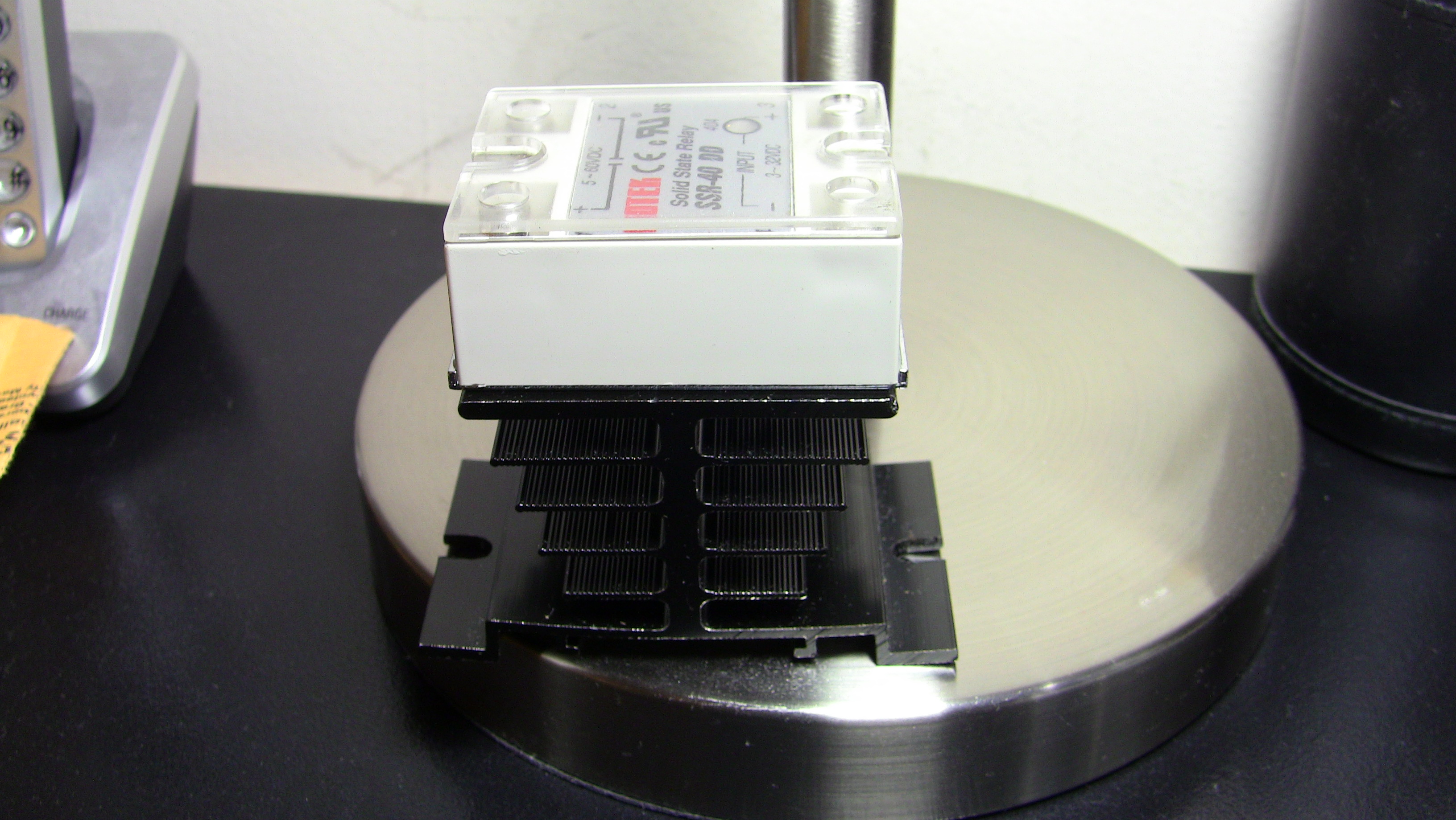

Well I just received my SSR in the mail as well as the heatsink for it, however, the company forgot my heatsink compound!!!
I was curious if regular arctic silver 5 thermal compound (Arctic Silver 5 Thermal Compound : Computer Cooling Systems | RadioShack.com) would due, as I don't want to cause too much fuss over something that cost $0.50 and also have to wait 3-4 more days to get it shipped?
Attached is a photo of the SSR attached to the heatsink...it fits well I think, just hope it works. Still waiting on my diodes though :(
Arctic Silver will work just fine. Just a dab of it. Same as a HSF assembly.
