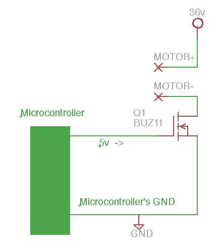

The motor at full load can draw 25A, and it requires 36v. The 5 volts is coming from another power source separate from the main power source.
I'd like the switch to switch between On-Off fairly quickly, almost instantly.
I posted a simple schematic of the circuit, let me know if it's missing something important. :)

Make sure you add a protection diode (cathode to plus) across the motor to suppress turn-off spikes that could zap the transistor.
Not a good choice for the MOSFET. You want a logic level MOSFET since you are using 5 volts on the gate to turn it on. Give this a read as an example.
Ron
1N4002 would do just fine. I also suggest you note what I posted as to the choice of MOSFET if you plan on 5 volt logic to turn the MOSFET on.
Ron

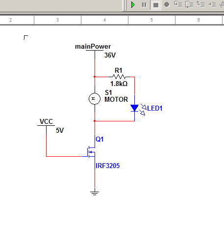

Right I saw that and will look into it after I figure out how I just destroyed my microprocessor lol.
Attached is how I have my system currently setup, and for some reason, I'm guessing the 36v's ground and the Microprocessor's ground cannot be connected together, as when I did this, my micro-controller just stopped working.
But if I don't do this, the MOSFET doesn't get it's gate triggered at all, so I'm confused on how I'm suppose to implement this basic system. What am I doing wrong?

The two grounds must be connected so that the MOSFET has a ground reference to the Microprocessor signal.
So how are you connecting them together? Make sure the the motor current doesn't somehow run through the uP ground. You want to connect the grounds together near the MOSFET, not at the power supplies.
If grounding is a problem, then you could use a solid-state relay, which has and opto-coupler isolator built in.

Yes it matters. AC output relays typically use TRIACs or SCRs which are unsuitable for DC. Google "DC output solid state relay".
You could use an opto-isolator such as **broken link removed** to drive the MOSFET.
Make sure you add a resistor on the input to limit the current to less than the 50mA max. rating.
