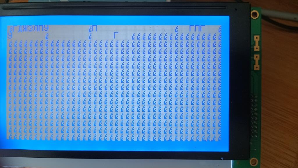

Good afternoon. Tell me please. When trying to output custom characters from const char font[256][8], garbage appears on the screen. How to solve this problem?

void read_stat_lcd() {
    while ((Lcd_com & 0x03) != 0x03)
void write_com(uint8_t com) {
    read_stat_lcd();
    WriteCommand(com);
void write_dat(uint8_t dat) {
    read_stat_lcd();
    WriteData(dat);
void T6963_WriteDisplayData(unsigned char x) // Writes display data and increment address pointer
    write_dat(x);
    write_com(T6963_DATA_WRITE_AND_INCREMENT);
void Set_Address_pointer(uint16_t addr) {
    write_dat(addr & 0xff);
    write_dat(addr >> 8);
    write_com(0x24);
void Set_Offset_Register(uint16_t addr) {
    write_com(0x22);
void glcd_clear_graph() {
    Set_Address_pointer(T6963_GRAPHIC_HOME);
    for (uint16_t i = 0; i < T6963_GRAPHIC_SIZE; i++) {
        write_dat(0);
void glcd_clear_text() {
    Set_Address_pointer(T6963_TEXT_HOME);
    for (uint16_t i = 0; i < T6963_TEXT_SIZE; i++) {
        write_dat(0);
uint16_t add = 0;
void T6963_DefineCharacter(uint8_t charCode, const char (*defChar)[8]) // Write single char pattern to character generator area of display RAM memory
    add = charCode;
    add = add << 3; //Character code 00h to 80h assign External character generator, when
                    //External generator mode.
    Set_Address_pointer(add);
    for (uint8_t i = 0; i < 8; i++) //The process of writing user characters to CG RAM
        T6963_WriteDisplayData(defChar[charCode][i]);
    Set_Address_pointer(charCode); //Setting the initial position of the first sign on the LCD screen
    write_dat(charCode);                                 //Writing data
    write_com(T6963_DATA_WRITE_AND_NONVARIALBE); //Writes display data and Non-variable address pointer
void lcd_init(void) {
    HAL_Delay(10);
    HAL_GPIO_WritePin(GPIOC, GPIO_PIN_4, RESET);
    HAL_Delay(10);
    HAL_GPIO_WritePin(GPIOC, GPIO_PIN_4, SET);       //Hardware reset of the LCD
    HAL_Delay(10);
    write_com(T6963_MODE_SET | T6963_MODE_CG_RAM); //Setting the operating mode external CG RAM
    write_com(T6963_SET_GRAPHIC_HOME_ADDRESS);
    Set_Address_pointer(0x001E);
    write_com(T6963_SET_GRAPHIC_AREA);
    Set_Address_pointer(0);
    write_com(T6963_SET_TEXT_HOME_ADDRESS);
    Set_Address_pointer(0x0028);
    write_com(T6963_SET_TEXT_AREA);
    Set_Offset_Register(0);
    Set_cursor(0, 0);
    write_com(
            T6963_DISPLAY_MODE | T6963_TEXT_DISPLAY_ON
                    | T6963_GRAPHIC_DISPLAY_ON | T6963_CURSOR_DISPLAY_ON
                    | T6963_CURSOR_BLINK_ON);
int main(void) {
    lcd_init();
    glcd_clear_text();
    glcd_clear_graph();
    for (uint8_t k = 0; k < 8; k++)
        T6963_DefineCharacter(k, font); //Writing custom characters from the "font" array
                                        //and displaying these characters on the screen
Two things.. A) that appears to be the same character printed over and over. This is weird as the code doesn't have a forever loop so it'll keep rebooting and clearing
The first 8 are as you have defined them. So the code is working..
place a forever loop after the for loop so you can see what prints.
while(1) {} <<<--- and it'll halt here so you can see.
